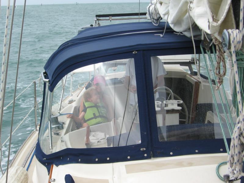

The first is the install of ...
...the Bimini and the Dodger at the boatyard. That went well with the exception of the area between the arrows above, but should be an easy fix. We don't have a Bimini/Dodge quite as nice as some of the professionally made ones, but do have some features they don't have and are very happy with the outcome.

looks good, i like the light blue center piece. Gotta have it down here-bimini that is. I can relate to the heat and humidity, I've been in the deep south for all my adult life and every year I think it affects me more. Getting old i guess, the cold is even worse though! I don;t see any forword dodger straps? Might just have to install some straps forword to put some tension on that top? If not you can cut a triangle wedge out of the loose side around were the frame is an then resew it, i think its called a pleat or tuck or something. The wood cockpit toprail looks beautiful! What did you seal it with? You might want to make a cover for it, especially if its sealed with varnish. Varnish last 3-6 months down here then it lets go and peels or flakes off. Its the biggest pain in the arse on any of my boats. I will eventually remove all my topsides wood and replace with a plastic alternative to end the constant sanding and varnishing. But when its done it looks good for a few months. I enjoy all your mods and your detailed description/pics, thank you for sharing!

............ I don;t see any forward dodger straps? Might just have to install some straps forward to put some tension on that top? If not you can cut a triangle wedge out of the loose side around were the frame is an then resew it, i think its called a pleat or tuck or something.......
Thanks for the input :). There are straps...
...that are behind the window area (see above). I put a couple pleats in things at home, but the frames are a little different geometry wise on the boat. The hardest area to get tight...
... is the flap extension between the bimini and the dodger as I can't put a ton of pull on it and the common sense fasteners. Once we fix the attachment of the side curtains....
... above that don't connect on the boat things should be better. I think we can work on it more there since we take the sewing machine with us. Our main effort next trip will be to get the darn thing in the water and be gone for a while.

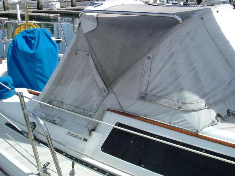

Dodger Handrails
Sum, you really shouldn't "depend" on your lifelines. I just use mine for guidance rather than dependence.
Here's a picture of our handrail.
PM me and I'll send you a copy of a Good Old Boat article about how to add one if you'd like.
PS - please excuse our ratty OLD dodger. :)
