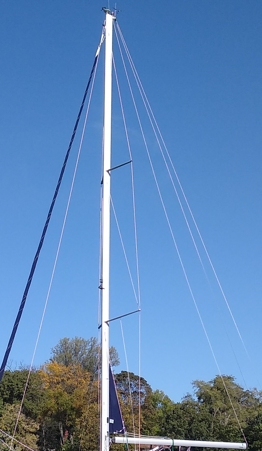

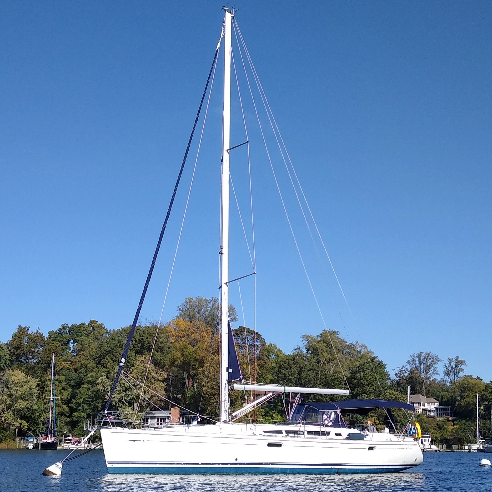

Hello all -- I am looking for thoughts on my plan to add a solent/slutter stay to my newer fractional furling mast on my Jeanneau SO 45. I understand for a mast head sloop if you keep stay attachment point just below the existing forestay there would be wouldn't be a need for running backstays or any extra structural support.
The question is can I do the same with a fractional rig --in particular a standard Selden mast since I understand they are "coastal" grade and considered "bendy". In my case, fractional is nearly a mast head since it was shortened ~5% from original to accommodate the ICW and the forestay attach point now very close to the top.
The other question I have is from what I read typically you would add a stainless steel collar with a bolt running through middle of mast as the attach point. But since there is a furled sail in the mast not sure how that could be accomplished.
If you have gone down this road on your boat or others, love to hear how it went --or if it was a non-starter I would like to hear that too. Thanks
