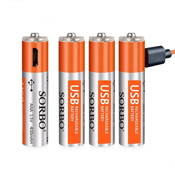

I think you mean 8000mAH "NiMH" battery. There are small Lithium Ion rechargeable batteries that have recently come on the market, but they require a unique charging system. I recently bought a 4 pack of aaa rechargeable Li Ion batteries that use a micro usb charger.
The jury is still out on how well they work. One noticeable feature is when one of the batteries gets low, the internal bms will shut it down. I use them in a head lamp and there is no dimming as the batteries discharge. Goes from bright light to no light.

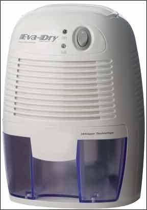

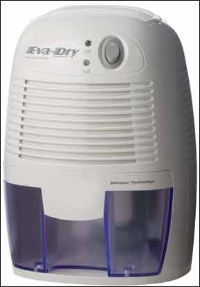

I have been using the small Eva-Dry dehumidifier for a couple of years, most of the time at a dock with 110v access. But for a few months in Florida, I ran the unit on battery power while on a mooring. I only had a 100 watt solar panel for charging the batteries, so had to have a 12v timer that limited the on cycle to about 4 hours in the morning every day. No problems so far with the unit.
Boating buddy used one of these on his boat and was surprised at how much moisture it removed from his boat. Of course he was a live aboard where moisture was a problem. Not so on our boat with our current setup and not a live aboard.
