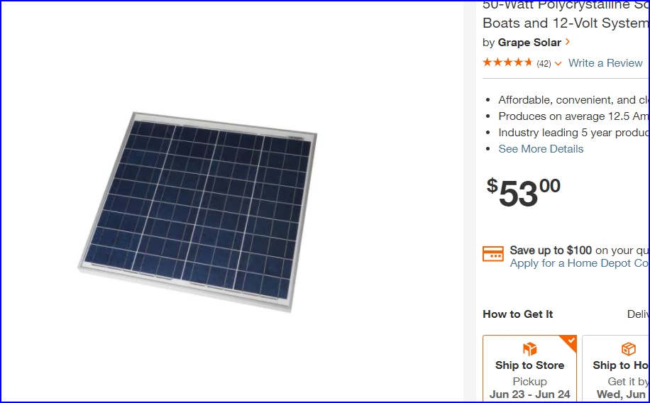

I was thinking about what you are dealing with this spring. I got a basic 50watt panel and 10 amp controller from Home Depot for under $90 ( looks like I paid to much based on current pricing) and it's been working so far for me. Like Lake Ontario above,I lay it flat in the cockpit when at the mooring behind my house her in the NW, and it so far is holding my two AGM's at 13.7v. NY might be similar to WA state as to sun angle and sunny days. It's about 24" x 27" and fits below the cockpit seats when sailing.
I decided that all the discussion about charge rates, etc. was overkill for my needs. If I only get a few years from the AGM's so be it, but having a 100 or larger panel is to big for a small Cal 27.
