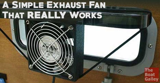

I made my own with a computer fan and a 5 watt panel. It is hidden inside the panel where the Dorade vents come to the interior. The wire is fished through the vent to the panel which stays in place even when sailing. The Dorade provides a labyrinth path so water can't get to the fan and it comes on and off during the day.
