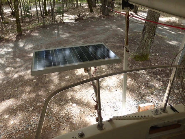

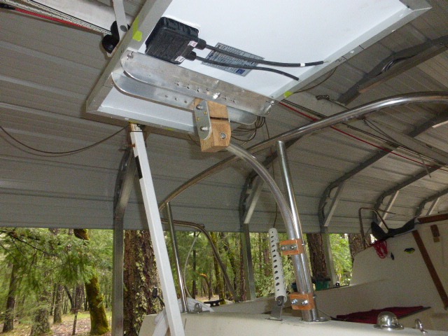

Mounted mine off the rear by using a curved 1" aluminum tube clamped to the upright. gets it totally out of the cockpit and out of the way. controller is in the cabin. takes minor fabrication work, but all easy stuff. The curved tube was stolen from a dead sears weedwhacker ;) .
You don't plan on installing all three panels do you? what do you plan to run with them? My 40W has proven to be more than enough for multi day trips powering stereo cd player, Garmin sonar, lights, etc.

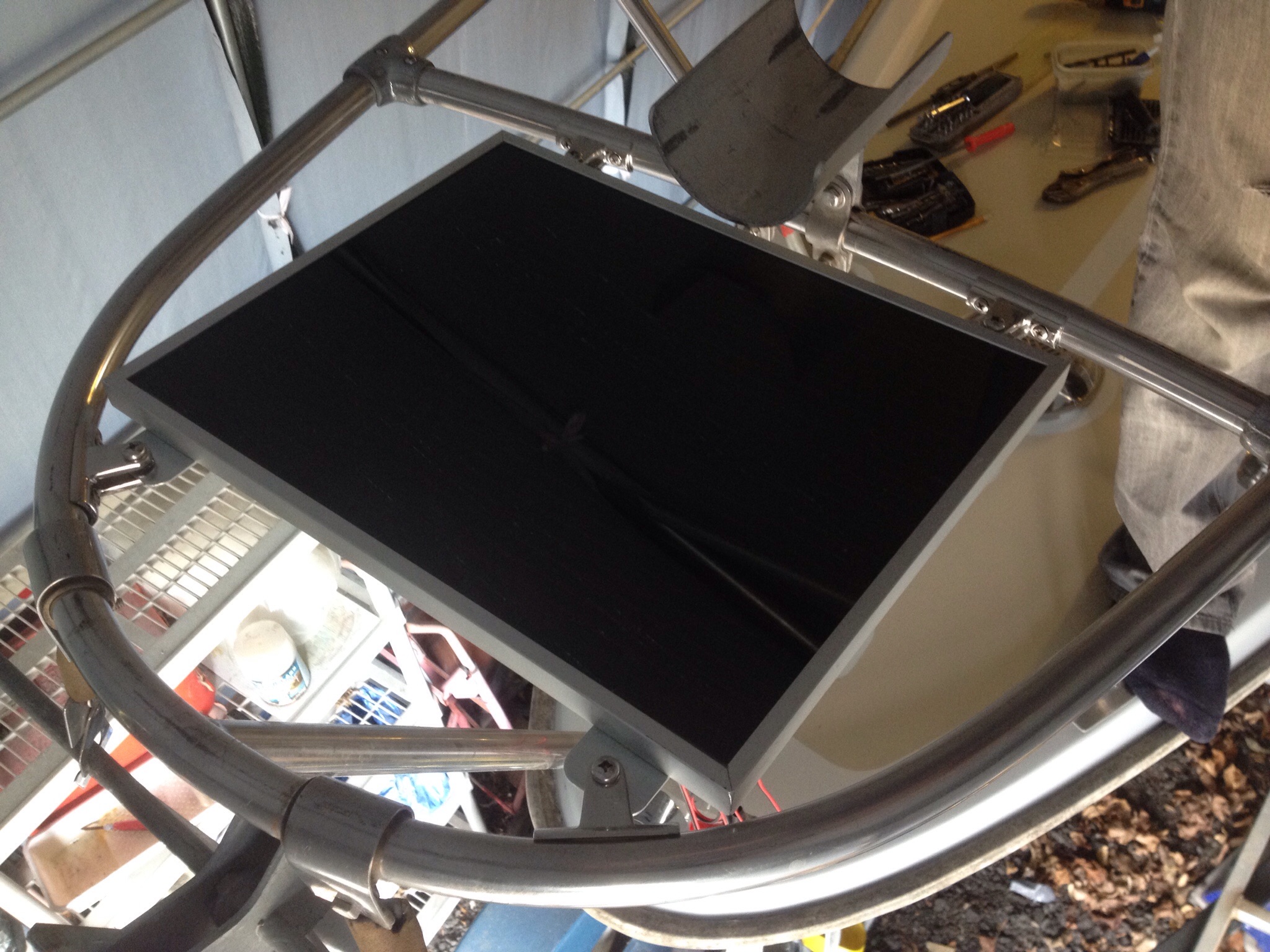

View attachment 127758 View attachment 127759
Lived aboard and cruised full time for 2 1/2 years using a single 32 watt panel,, and a single battery. In that time,, had to go in and plug in a battery charger twice, due to prolonged very cloudy weather. Charged laptops and phones with no trouble.

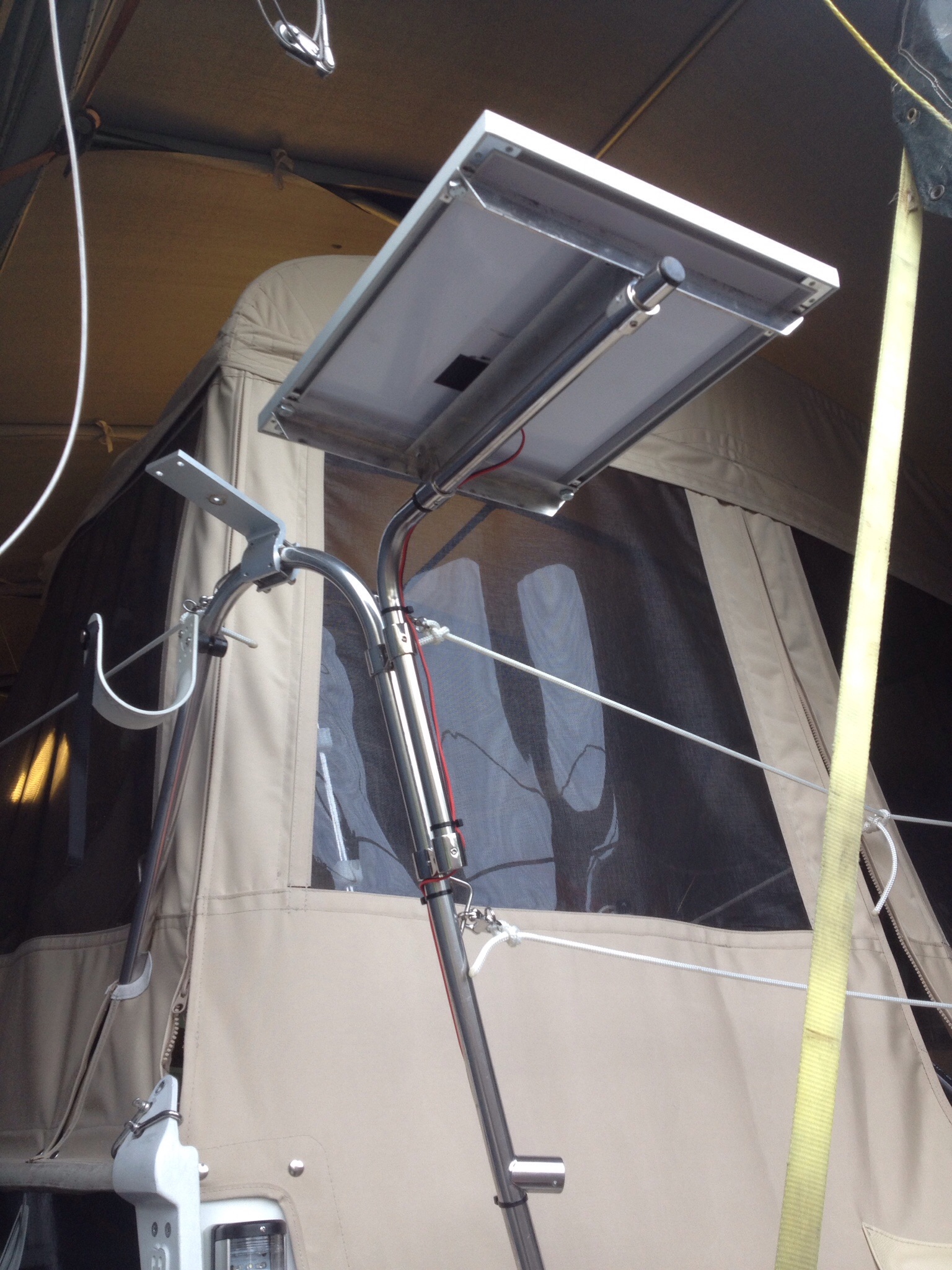

Three 7 watt solar panels...2 aft (for 2 house 27N deep cycles)....& 1 forward (with a smaller 24 for the bow thruster)
Both set ups have charge controllers, and never need charging otherwise

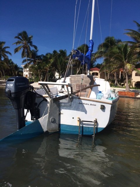

On My Neptune 24 I mounted a mast on the stern opposite the outboard motor. The 55 watt panel was 6'6" off the deck when horizontal so it was not a head knocker and it also protected it from flying beer bottles on tacks. When docked or anchored I would tilt it to the sun.
