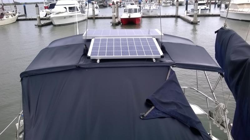

I have just installed two 100 watt go power flex panels on my bimini. I have only temporarily lashed them down until I decide for sure where on the bimini they will stay…. When I was playing around with just one panel hooked up and pointed that panel directly at the sun it produced up to 7 amps, with a blue sky 2000(mppt) controller. This was confirmed with my link lite battery monitor. On a good day down here one panel more then keeps up with the fridge. It would be worth well to make a system where you could easily direct the panels to the proper sun angle….. It would really help with power output…. But for now just lashed down solves most of my power concerns when on the hook.

Stu, they are well clear of any shadows... The angle to the sun makes a lot of difference in power output… if you made a hatch cover type push rod to change the angle on light flex panels you could get more power on the hook...
