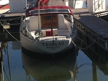

My flex panel has been mounted on the bimini for years, and many miles, with zero problems. Sad to say, it has reached the end of it's life and needs replacing, which has me a bit stymied since I haven't found another flex panel like it. It's just lashed to the bimini supports at the four corners.

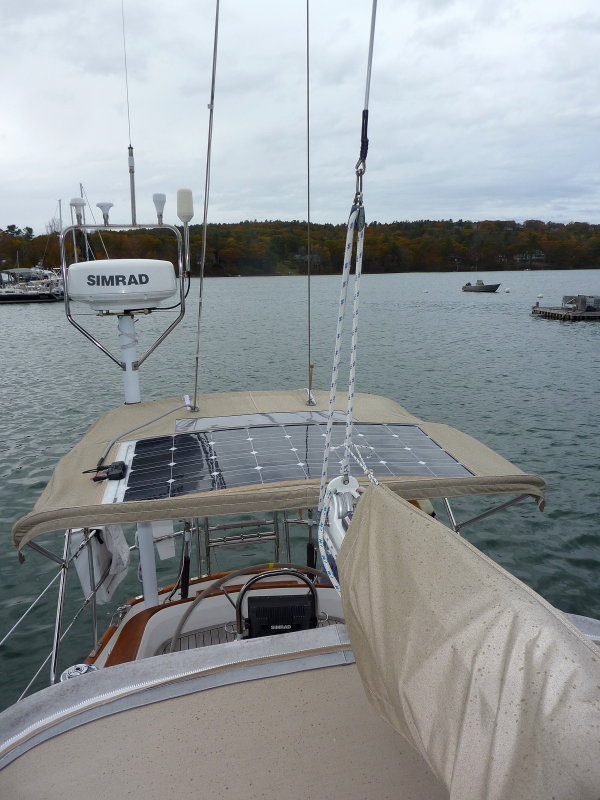

SV Delos showed an installation of flexible panels recently -
They sewed an extra pocket on their Bimini that the panels could fit into, so they aren’t likely to get blown around. Doesn’t solve the problem of getting airflow under them though.

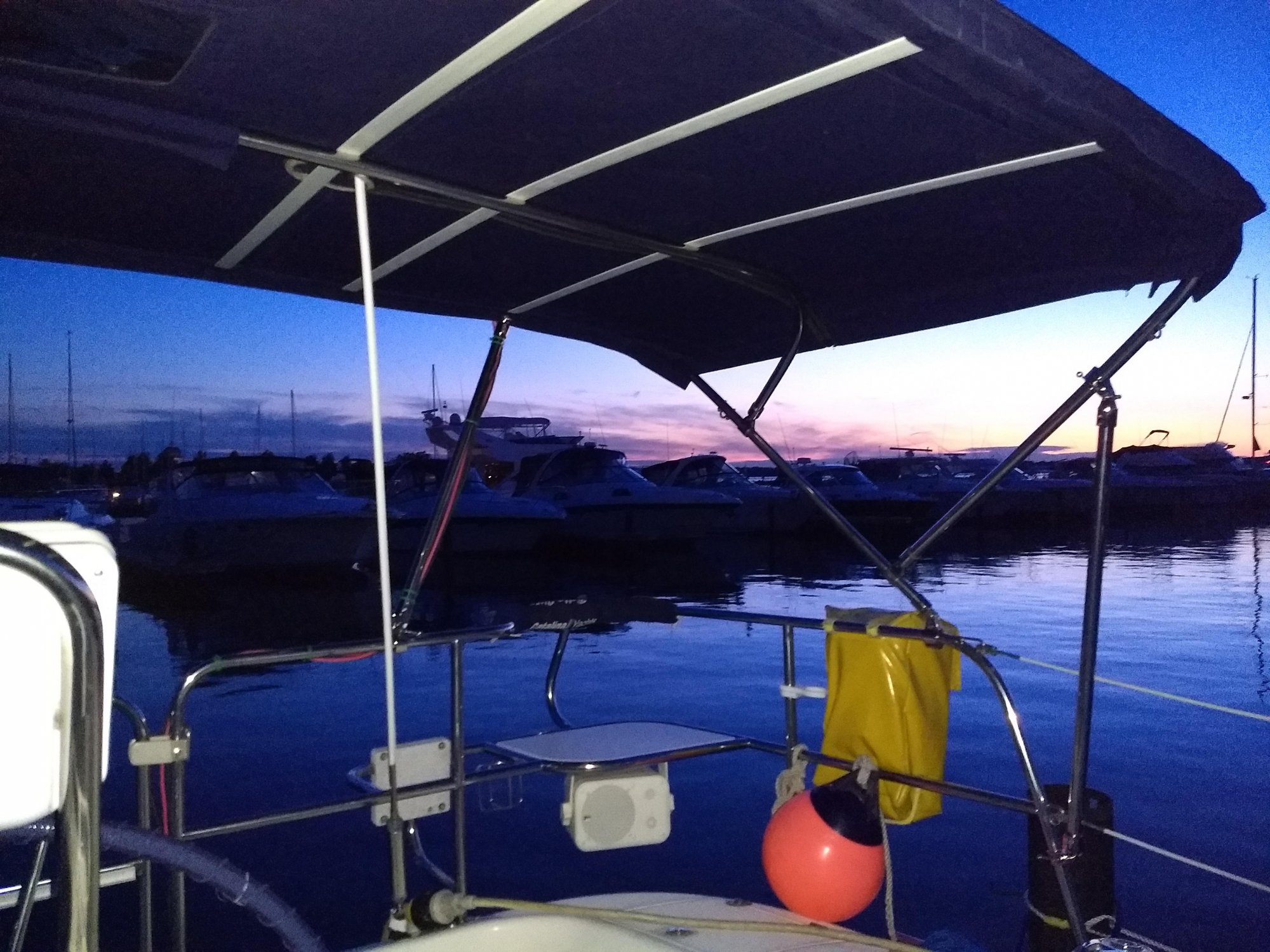

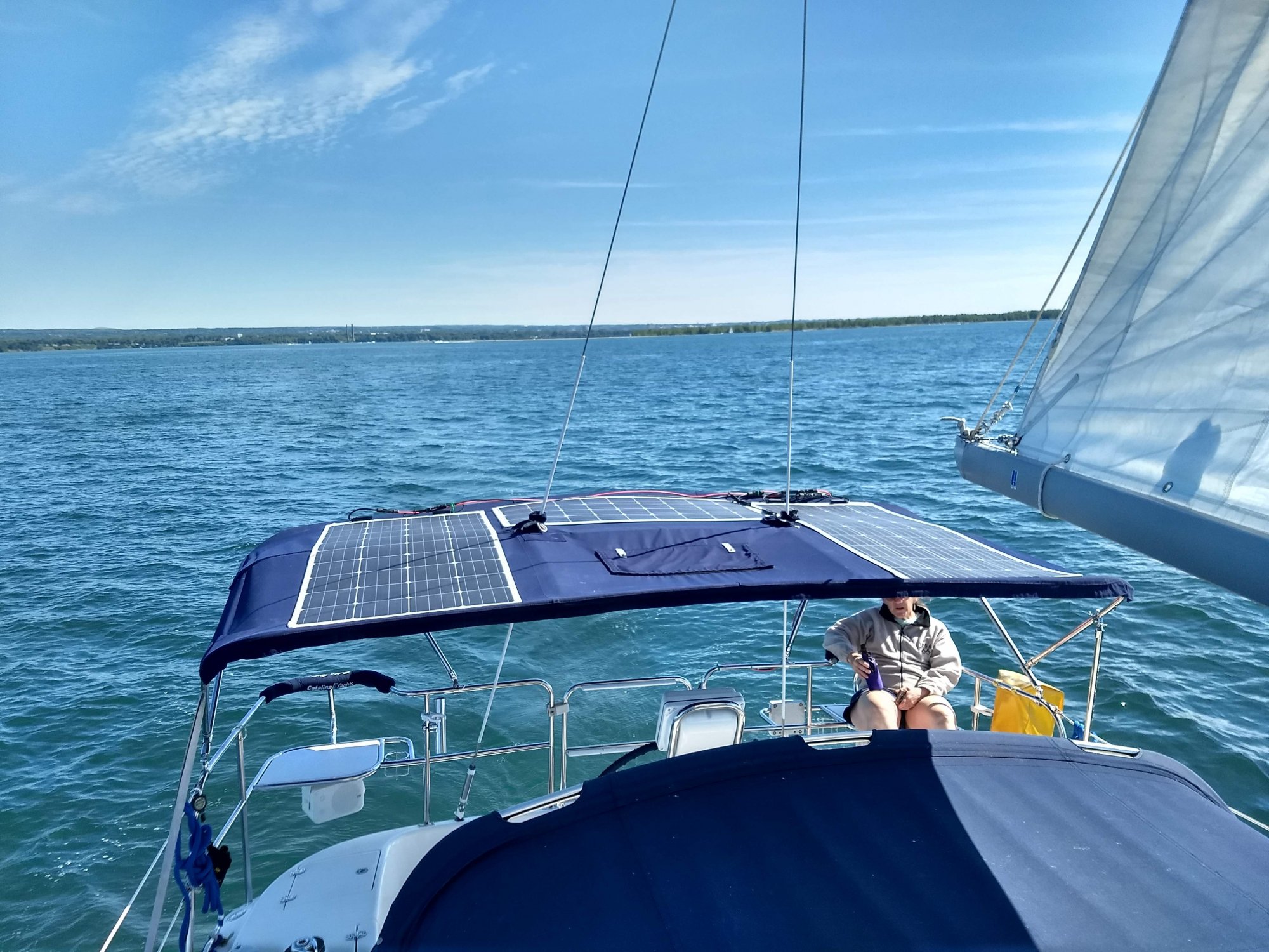

I put 420 watts of panels on our bimini last year. I used Renogy flexible panels. Way too early to be able to tell you how long they will last but so far so good. I'm sure they won't go as long as rigid panels, so not expecting that. Being able to do a low profile mount rather than deal with building an arch was more important to us. I had to beef up the bimini by adding rigid struts in place of the straps. I also added fiberglass battens under the fabric and up over the center arch to keep the panels from hitting a hard spot at the point over the center arch. See pics below.
To attach them, we used 3-m Dual Lock (part # SJ3440 for the fabric side and SJ3870 for the panel side from itapestore.com). The dual lock on the bimini fabric can be sewn in place with a decent machine. My wife did this and also added the pockets for the battens. The panels have been through 60 mph thunderstorm winds last season without issue.

Sesmith. Thanks for input and I like the idea of adding battens to support on Bimini. One problem I’m having is sag on my Bimini due to added weight of flexible panels.

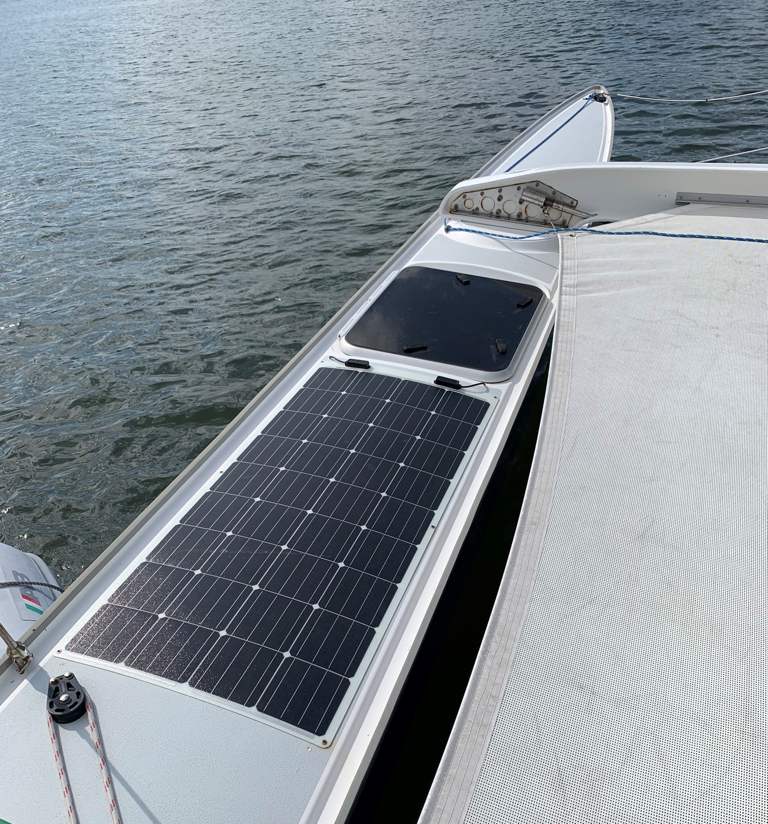

Don't let them flex repeatedly, or they won't last! I've been using solar panels since 2001 and have been through 4 generations. The latest are 2x Renogy 160w panels and a single Lensun 50w ahead of the mast. Mounting on the (curved) deck was done with 3M VHB 2-sided tape. No holes and it holds well even in high winds and decks awash (especially the amas).
I should add that the Renogy quality is not great, but the output has been good and (so far after 2 years) they are holding up (after 3 early returns). The eyelets are brass plated steel that rusts. I would recommend Sunware or Solbian, at a higher price point. Lensun is also good quality. I stuck with the Renogy only because they exactly fit the area (see image) but the defect rate of the new ones was not good. Hopefully these will last (they're inexpensive so I have a spare still in the box).
