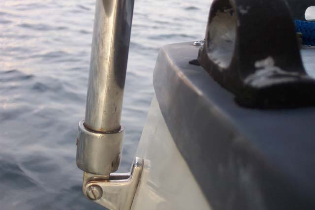

You guys with davits on narrow-sterned hulls, do you ever need to fold them? Is there any reason, during the in the water season, that the davits might need to be folded in? I am considering a set and then mounting a solar panel across them. I have an idea for a mount that would permit some degree of angle adjusment in both directions. But it would be difficult to also allow easy folding. The dinghy would be ashore most of the time since overnight anchorages are going to be rare.

Our 33.5 isn't exactly a narrow stern. When I installed the Martek davits I considered making them foldable, but in the interest of time, decided to install them fixed. Thoughts were I could always make them foldable later. (We had heard rumors of being charged for the overhang length, even when the dinghy wasn't hanging from the davits, by many marinas.) We have used the davits a couple of years and have never seen the need to make them foldable. I installed two 85 watt panels in Feb and are very pleased with the setup. A friend with a H40 and the same davits recently installed a single 130 watt panel across the davits.

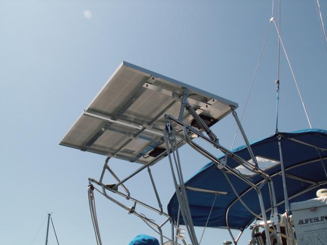

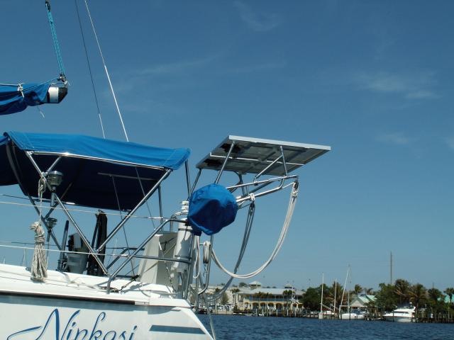

No need to fold. You'll want some sort of cross bars to keep them from swinging when the dinghy is in them. These cross bars will hold a solar panel quite well, ours do.

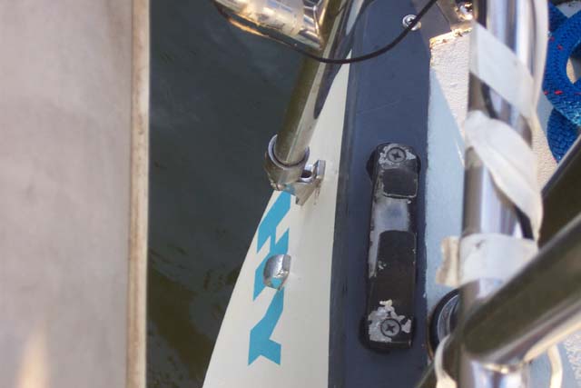

Ed, we are looking into solar panels also. Guys here with narrow stern boats don't fold the davits, they remove the dingy. I have some pix of a tartan 37 with folders, and I am over due to visit a neighbor with a Catalina 34. Both echo someone's comment that it brings a whole other dimension to docking.

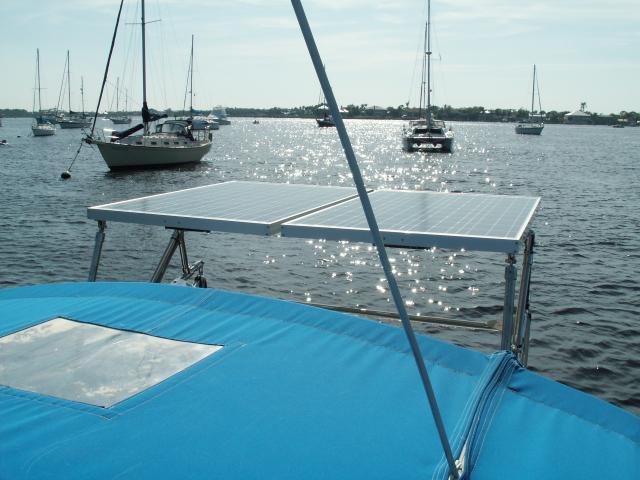

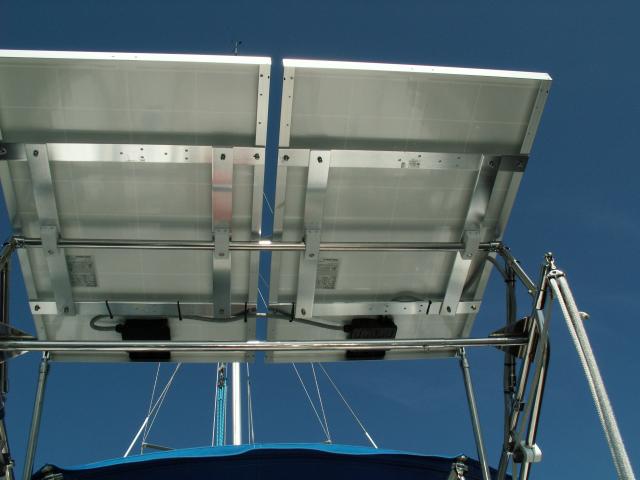

Ours is not fixed it simply rotates around one of the 1" SS cross bars with two friction adjustable clamps. This level of adjustment works well in getting the most amps in based on where the sun is in the sky. I'll try and find some pics of the clamps..

Ed, Our installation is "sort of fixed". By loosening two hex cap screws, the panels can be pivoted some. I checked with a bunch of cruisers who had adjustable installations and the consensus was that most used a fixed setting and never bothered to baby sit the panels to optimize charging. Lots of data out there, most of it way over my head, about the optimum angle. I went with the rule of thumb I found which said
May 5th - Set at the same angle as your latitude minus 15 degrees.
August 5th - Set at the same angle as your latitude.
November 5th - Set at the angle of latitude plus 15 degrees.
For my local summer cruising that means an angle of only 23 degrees. Winter cruising to FL it means about 40 degrees. In either case it's enough angle to keep the cat off of them and water from pooling when it rains. I rarely make adjustments. Then again, the backup Honda is always available too.

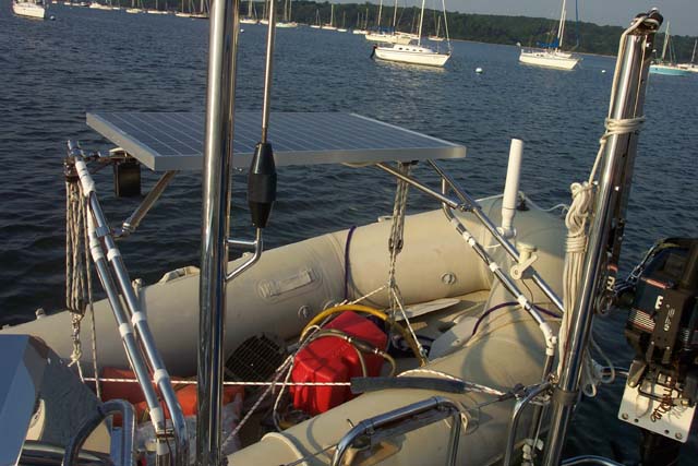

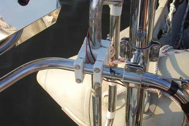

Ed, I installed the Martek davits on my old 1981 H33 along with an 85W solar panel. Talk about "narrow stern"!!! But it worked perfectly. Although I opted to the non-swivel type that was never an issue. If my pictures were posted properly and show up below, you'll see that the installation was simple, only requiring the two transom mounting plates and the two stern-rail "stand-offs". With a friend, the installation only took about 3 hours. I added the cross bar and the two bracing bars at each outboard end for rigidity and that was that.
The only modification to the boat (aside from moving the GPS antenna and Sirius radio antenna) was that I had to purchase another stern light to mount on the crossbar. I realized that after I had the dink up and secured it blocked the existing stern light.
I also installed the Isotherm refrigeration system on the boat and with the input from that 85W panel, I was able to leave the reefer on Monday-Friday while away from the boat and only found the house bank down about 30% when I'd get to the boat on Friday afternoons.
As an FYI, aside from the Garhauer motor lift, the other vertical pole in the picture is the radar mount - also from Garhauer.
