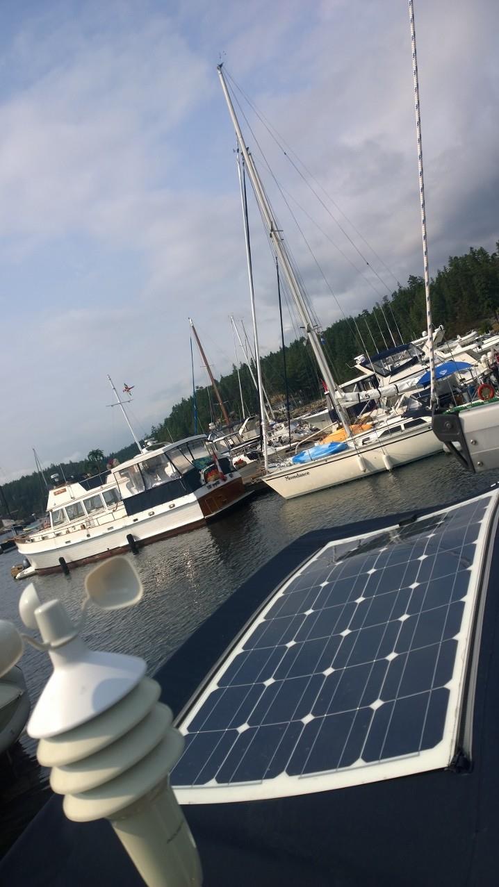

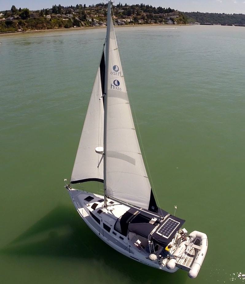

On my 326, I've been extremely pleased with a light weight Soliban branded flexible solar panel that uses an optional zipper style attachment system that's sewn into the Bimini fabric. The panel cost a pretty penny, but I saved quite a bit not having to worry about mounting hardware or clearances. The panel gives me 8 amps in full sun.

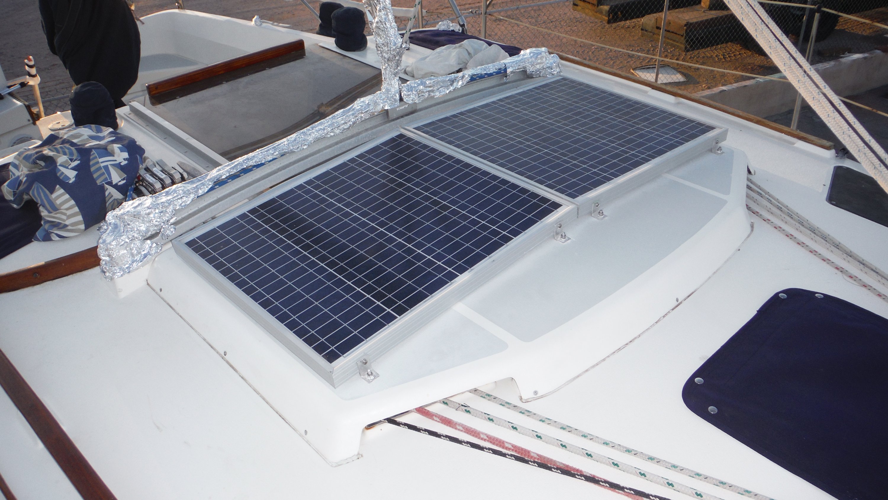

I added two 50W panels on my Sea Hood. Wiring was easy to route through the head. It was a quick way to utilize unused space and add some solar without major structural additions Made the mounts myself with some aluminum from Home Depot. Best PV only charger is a Morningstar Sunsaver with remote display. Allows charging and monitoring of two banks of batteries, a three-stage charge algorithm and periodic equalization. It also allows you to divide output equally or 90%-10% which is great for maintaining a house bank and starting bank of batteries. You might argue that shading will reduce output but the shading in this location is so diffused due to distance it is minor.

You don't have to use giant wire, you can use multiple wires in parallel of smaller gauge for easier wire management. Best place to buy wire is "Greg's Marine Wire" online.

Steve what's with the aluminum foil on the traveler?
24,926
SF you have a funnny side. Is this a 2017 thing?:confused:
24,926
Protects the boat from aliens
Did to want to start the year out being presumptive. It is right their with the solar panel. So... possible.... :laugh:
Aug 15, 2013
193
Hunter 35.5 Legend 003 San Carlos, Sonora, Mexico
Haha, you guys are too funny. It keeps the voices in my head at bay..... No really, I keep the boat in San Carlos, Sonora, Mexico, west coast of mainland Mexico. It may spend several months on the hard in the sun, especially in the hot summers. So until I can get around to canvasing the entire boat (which I am working on with my Sailrite LSZ-1 sewing machine) we typically cover all plastic items, blocks, etc with aluminum foil as the sun can be brutal. I put two layers of automotive reflective bubble wrap under the Sunbrella on my window covers and my boat never gets past 90 inside during the summers. I know that because I have a datalogger in there....
