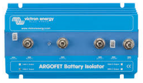

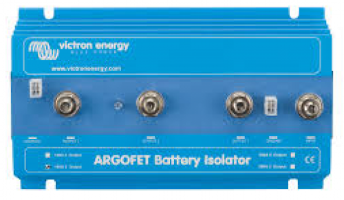

Presumably, what you would like to happen is the current from the PV goes to the battery that needs it the most and less current goes to the battery that needs it the least, the more well charged battery. To make that happen the batteries need to be isolated from each other. One popular method is to use a Blue Sea ACR and do not leave the switch on Both.
