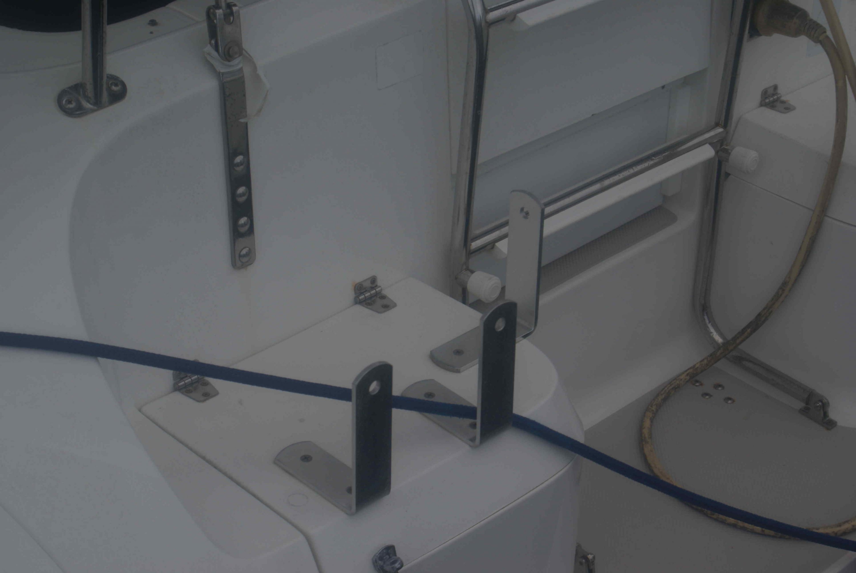

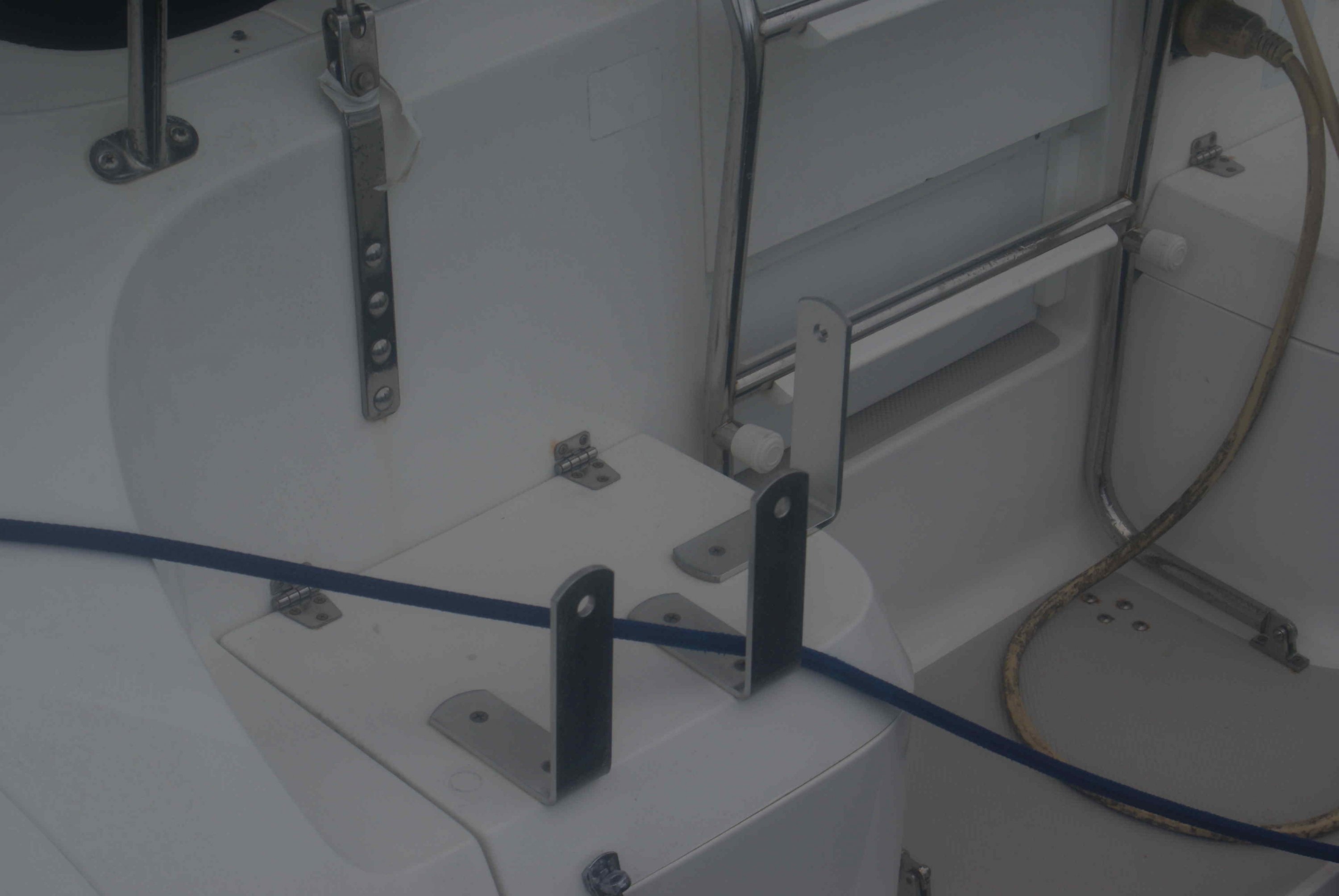

Do you have any pictures of the bracket you use to hold the generator? Would love to see that. AC is a significant factor for me since all of my cruising is in FL & GA.
bob
The picture shows the bracket on the port propane storage locker lid. I put the generator here only when at anchor when it is running. Otherwise, it is in the cockpit, drained of fuel and covered. The generator is only on the boat for those trips in which we think it will be used. Otherwise, it is at the house.
D
Deleted member 117556
Very simple solution to using the generator. Thanks for posting!
