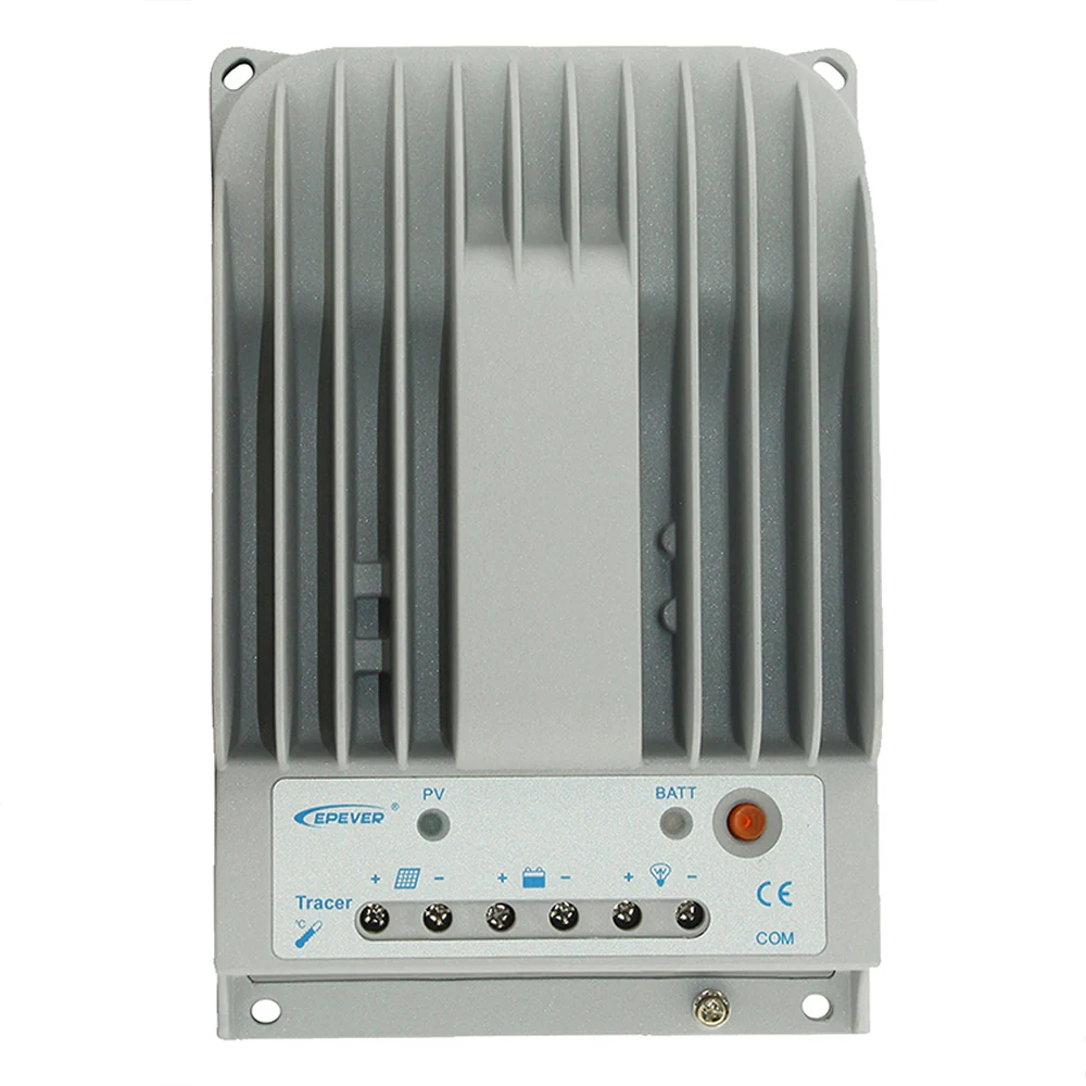

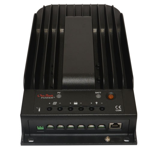

Epever is not a cheap Chinese controller. They produce some of Outback Power's controllers (Outback rebrands them), and those are considered first tier. While maybe not the top of the best, they are leagues ahead of Renogy and the no-name controllers, and tend to be a good budget controller.
I would love to know why you think Outback re-brands EPever? I Don't see any indication of that? Please explain..,.

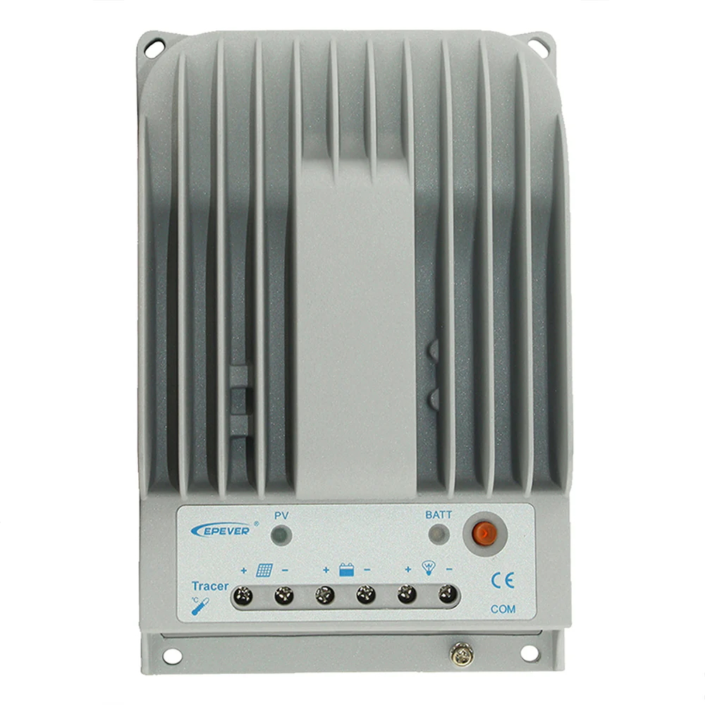

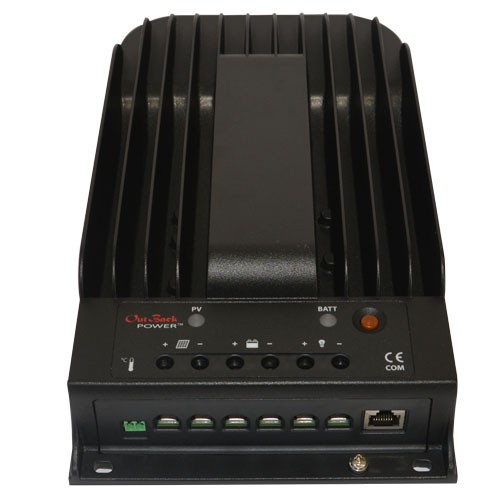

I didn't say they rebranded all of them, just some of them. The Flexmax Micro line is made by Epever for Outback. Here is a link mentioning that. 40A 12v/24v MPPT charge Controller - Tracer 4215BN - 150VOC PV - LIMITED STOCKS OF THE BULLETPROOF BN SERIES
While that might not seem like definitive proof, the two look identical.

Yes those look similar but this is not uncommon as there are Chinese companies that make the heat sinks & housings for many. When I look on Panjiva I see no shipments from EPever to Outback and Outback does not seem to be using a cloaking service.....? I agree they are one of the best Chinese MPPT's but I have not found the EPever to be quite as fast at tracking which is critical on sailboats.......
I don't know what Panjiva is, but is it possible someone else makes that model for both Epever and Outback? A Chinese contract facility that builds for OEM's?
It is more than just a similarity of heat sink and housing. The communication port, external load connection, lights, and reset are identical, so those must be reproduced in the electronics and control too. Seems unlikely Outback independently reproduced and manufactured an electronics board with those functions in those places. And wrote firmware for it.

Based on the design of the hetsink it is very outback looking, design wise .Having imported from Taiwan and Mainland for business I think the more likely scenario is they got robbed by their contract manufacturer. They are known for selling proprietary info out the back door. Remember Aurinco Solar..They got put out of business from this.. They sell designs, out the back door to another manufacturer. Happens all the time. It is why it is so tough tho prosecute.. The contract manufacturer is not rebranding them, a third party is, and likely giving a kick-back to the guy that stole the designs...
