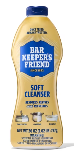

I am a devoted fan of this stuff
It is essentially soft scrup with oxalic acid added. Oxalic acid dissolves rust stains and attacks tannins (i.e. leaf stains). There are few stains that I have not been able to get rid off using this stuff. I've even pulled rust stains out of a sail. Just let it soak for a bit.

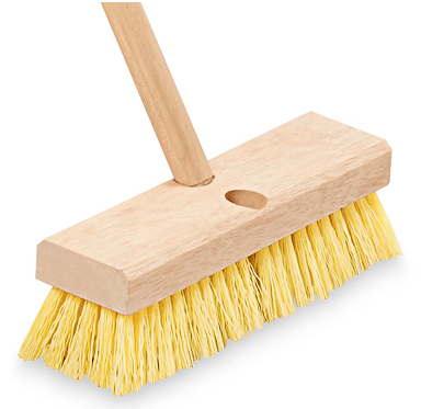

After a gentle pressure wash, I'd squirt a bottle of barkeepers over the affected areas, get one of these...
Scrub it really well and then pressure wash again.
Then go back with a scotch bright pad and more barkeepers to attack the difficult spots.
13,054
BTW: Sometimes it is hard to find the liquid/slurry version. You can get the powdered form at Walmart. I don't like the powdered form as much but I suppose you can make it work. The powedered form functions and feels a lot like Comet powder. I usually find the liquid slurry form at Lowes, Home Depot or Amazon.
13,054
I don't want to sound like a nut (too late) but I have even used Barkeepers on laundry when I have a difficult stain to remove. I've even gotten blood stains out of a white towel before. I had to let it soak a while but it came out.
If you have cheap stainless steel that is starting to get a little bit of rust on it... wet a rag with Barkeepers and rub it on the rust stain. It will come right off. If you have rust stains in your gel coat, work some Barkeepers into the stained area and let it sit for 10 min... then buff it out and rince.
