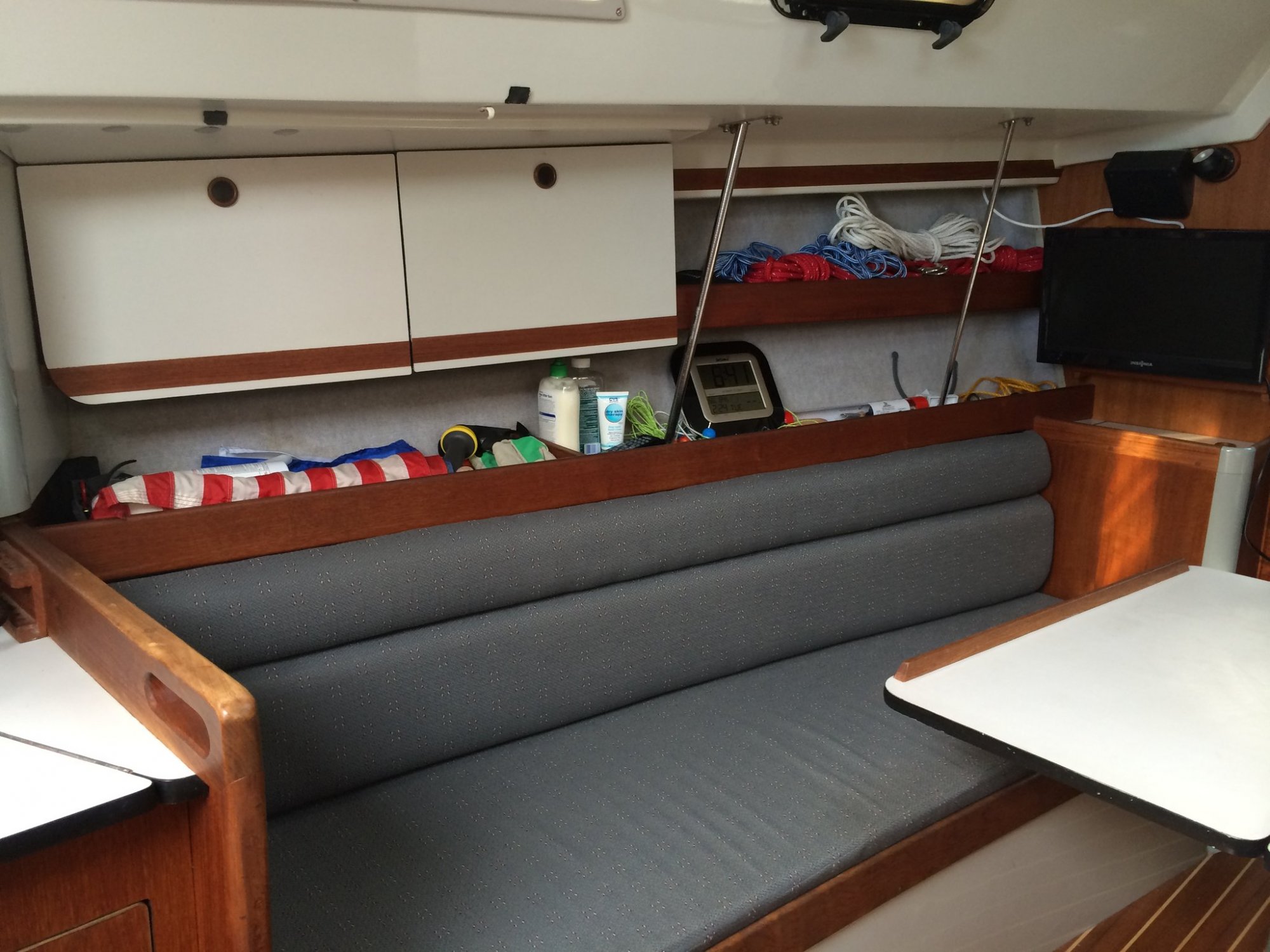

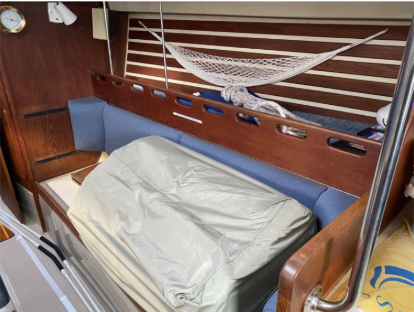

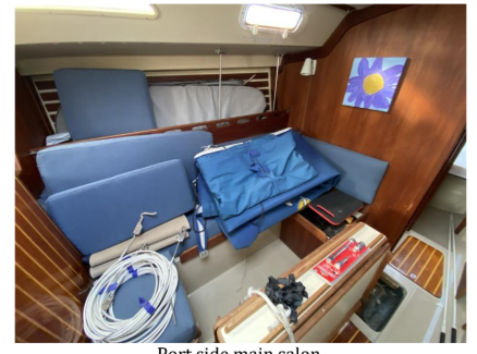

Thank you for your response.
Two of the three chainplates are bedded into fiberglass bulkheads below/ behind the settees, with the forward lower bedded just into the hull. From what I can tell the connection is secure and there isn't any sign of issue with these connections. Pictures to follow.
Sep 25, 2008
7,569
Alden 50 Sarasota, Florida
The pictures will help us better understand the potential for any chainplates issues.
