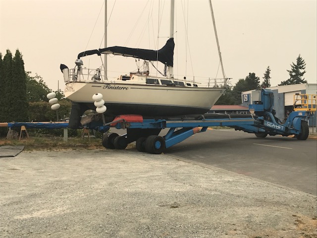

This is the way to haul a boat! No slings. Drive the boat between the rails up on to air bags. Vehicle is very articulated!
