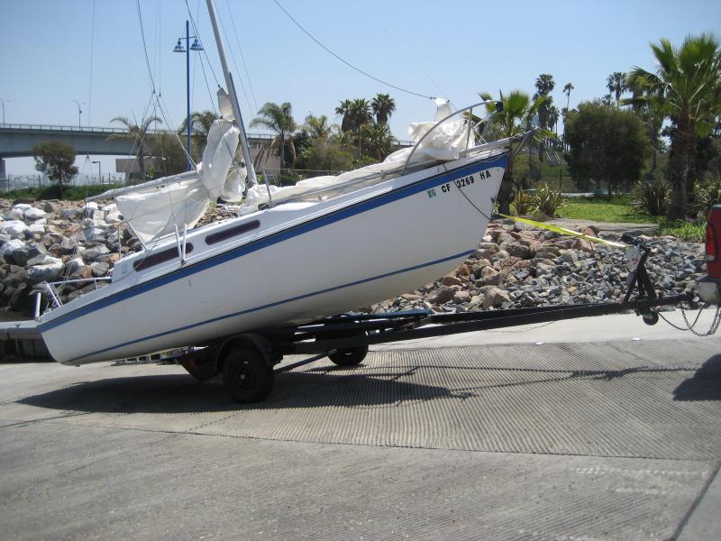

centerline. on the 26 classic's the factory trailer ends well before the end of the boat. so rear straps don't stop forward motion.
a strap around the boat at the cabin, helps, but not sure I would want to test it.
plus it wears on the rub rail.
I use a bow strap (rope) to keep it from bouncing, (Bass boat trick), and the safety chain.
you really want 10% or a few hundred # on the tongue. there's plenty of videos of boats jackknifing from low tongue weight and too darn fast.
before I moved the factory single axle back, I wrapped 50' of 2" chain around the tongue to add about 50# of weight... finally I got a double axle trl.
