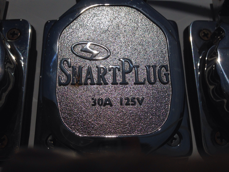

I do not believe in coincidences. There seems to be a problem with the plating process around the letter "M". What is your take on it?

i could maybe see one doing that but not two what does the back side look like
Oct 2, 2008
3,814
Pearson/ 530 Strafford, NH
Behind the cover have any soot. If it wasn't the plating could it be an electrical issue?

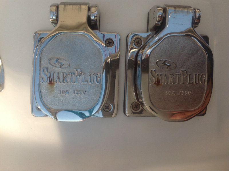

I have rust trying to form in the same place, on both of mine, two months after installation.
I recently cleaned with Barkeepers Friend and then wiped down with Sheila Shine.
No question this is a manufacturing defect.

I have a rust mark on my cover also. It showed up within two weeks of installation. The components are supposed to be 316 stainless and that would mean this is a contamination issue in the manufacturing process.
10,536
-na -NA Anywhere USA
Where was the cover plate manufactured. I have seen stainless steel from China and there are impurities in some depending on the manufacturer. Thinking out of the box but may be off.

I contacted SmartPlug and they said they found that a small batch of their first run of inlet covers were made with 304 stainless steel and not the 316 stainless that is their standard specification.
They're replacing both of mine when we return from the Abacos in May.
Quick response and excellent customer service.
