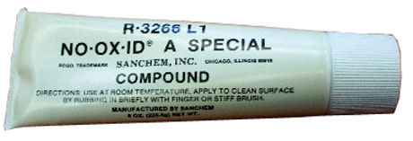

I use a few products for anti-corrosives on terminals. One of the best is NO-OX-ID:
This can be purchased from Sailors Solutions (image Sailors Solutions)
NO-OX-ID is an electrically conductive grease not a "dielectric" which, by nature, blocks or inhibits electrical contact. I use this where the starter case meets the engine block and alternator and battery connections and terminal strips etc. etc... It prevents rust from forming and provides a clean electrically conductive path for the case ground.
I also try to connect the engine neg directly to the mounting ear of the starter case. This yields a direct path back to the battery without the need to pass hundreds of amps of current through a rusty engine. This product kicked butt in the recent Practical Sailor testing. I have known how well it worked since well before then and was the one who recommended that Nick Sailors Solutions begin stocking it.
