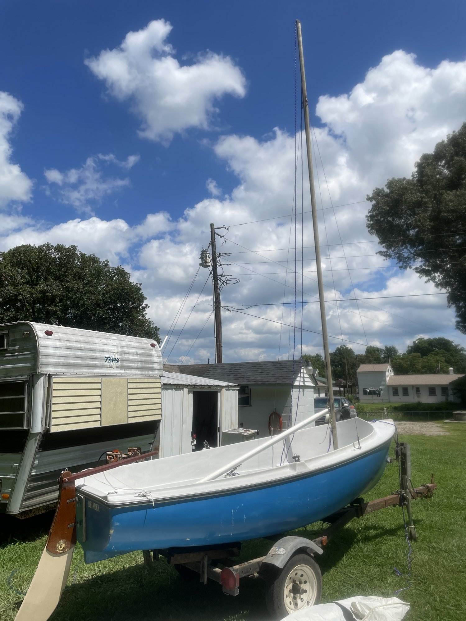

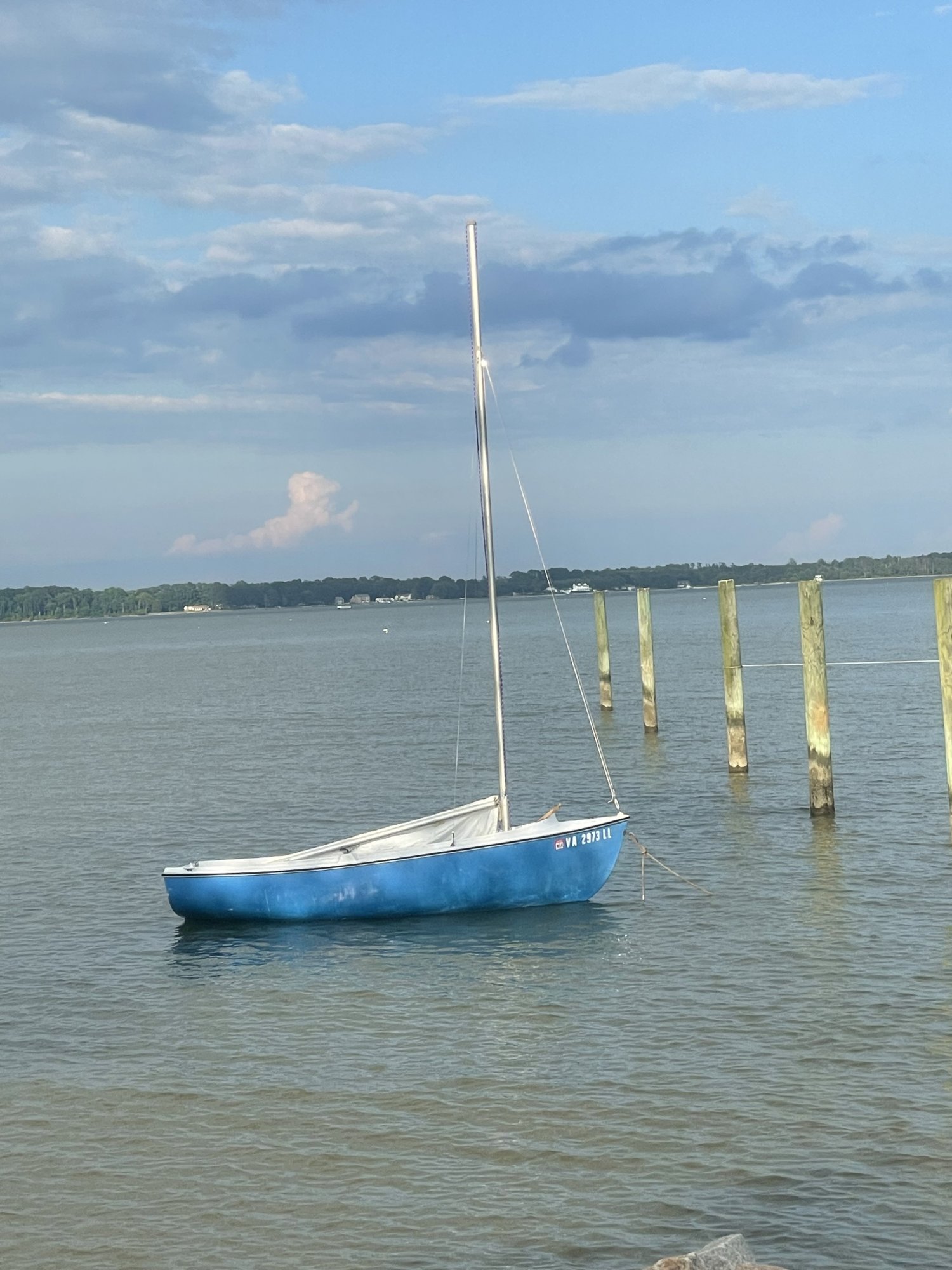

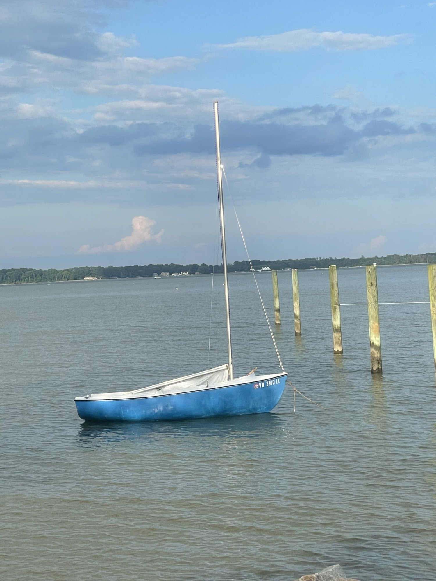

Hi this is my first post on sailboat owners and after taking my skimmar seagull out in the water I had a dumb idea that I thought could work so I figured I would ask some people with a lot more experience than me as this is my first boat and I don’t have but about 6 months of experience the idea was could it be possible to put a genaker sail on it for better light wind sailing like I am doing like I say I apologize if this is a really dumb question but I guess you don’t know until you ask the mast is an 18 foot damco and I’ll add some pictures I will update with better photos in a little while as it is in the water right know and it’s fairly early in the morning any replys will be strongly appreciated

I was also wondering what extra hardware would need to be added to the mast.

Welcome to the forum! While I share Joe's frustration with the lack of punctuation, I thought I should at least try to be helpful while expressing that sentiment:
"Hi! This is my first post on sailboat owners. After taking my Skimmar Seagull out in the water I had a dumb idea that I thought could work, so I figured I would ask some people with a lot more experience than me as this is my first boat and I don’t have but about 6 months of experience. The idea was could it be possible to put a genaker sail on it for better light wind sailing, like I am doing. Like I say I apologize if this is a really dumb question, but I guess you don’t know until you ask. The mast is an 18 foot Damco and I’ll add some pictures. I will update with better photos in a little while as it is in the water right know and it’s fairly early in the morning. any replys will be strongly appreciated."
Not a dumb idea at all, and your boat looks like a ton of fun!
Wanting a sail that I could use in light wind (especially on downwind runs), I am in the process of ordering a light wind genoa, which some refer to as a "drifter". In my case, I am ordering it without hanks (my foresails are hank-on as opposed to roller-furled), so instead of hanking the sail to the forestay, the tension between the head and the tack is what holds the luff in position to achieve proper shape for sailing. Gennaker rigging is, in essence, similar to spinnaker rigging and usually calls for a bowsprit, which your boat is not equipped with.
For my requirements (and perhaps yours?), the drifter is a logical choice. It is far simpler to deploy and manage since it does not require a bowsprit, spinnaker pole, and as many control lines. It also can be sailed to windward, though not as close to the wind as a standard foresail. For instance, on my boat my sailmaker (Mike Lipari at thesailwarehouse.com) says that I should be able to sail around 55 degrees to the wind (as opposed to the 40 to 45 degrees I can do with my regular jib). You can't do this with a spinnaker or a gennaker.

You had asked about the addition of mast hardware hardware. I would say regardless of what you go with, you will want to add a halyard pulley at or near the top of the mast. With a gennaker or spinnaker, you will likely need to add a bowsprit. This would be the most challenging addition.
Keep in mind that all of these solutions significantly complicate a course change (such as jibing) that would require changing which side of the boat the sail is flown on, but that just comes with the territory.

I think you would want to put your light air drifter sail a bit forward of the forstay and sweep it back about half way past the mast. And adjust it so the "pocket" is about halfway between the bow and the mast.
Do a google for "homemade bowsprit". You will find a bunch of articles for carbon fiber sprits but your boat will not have to deal with the forces a carbon fiber sprit would endure. Find one that you can use for inspiration for your own design. Some aftermarket commercial bowsprits may also give you inspiration. You could buy one but they will likely cost more than what you paid for the boat.
This should be fun... we want pictures.

Looks like your boat could also benefit from a topping lift.

I hate to be a stick in the mud but I don't see that much to be gained with a gennaker. You have a fractional rig with a really small foretriangle. I don't think the sail can be that large. It will live in the shadow of your main which is your main engine. It will be difficult to sail wing on wing without a pole. Going upwindish it will choke the slot when you try to sheet it in. I think there will be a very limited range in sailing angle and wind speed for which it would be useful.
I'd look at a symmetrical spinnaker, with a spinnaker pole for improved down wind performance. For upwind light air improvement on a fractional rig, a main with increased roach area is sometimes the ticket. You have no backstay so this is possible. You would want a single reef for windier days.
Don't want to spend that much? Sail it as is until you've learned what you can and if you still want better performance move to another boat.

@shemandr makes some very good points. If you are willing to spring for a new main, consider getting a "fat head" mainsail. These are sort of a hybrid between a true Marconi rig and a Gaff rig. The main will have a small "gaff" at the head which allows the leech to sit back a few more inches.... and when multiplied over the entire area of the sail, notably increase the sail area. Here are some examples

Do you already sail with a jib? Just noticing how far forward the mast is situated…working on an improved mainsail as already suggested might be a good option.

Well, I'm kinda stuck with being a stick in the mud, so I will throw in with shemandr when he points out the small foretriangle and with rgranger's point regarding the advantage of adding a bowsprit with a drifter in order to maintain proper center of force balance.

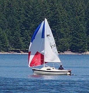

I say why not, because I had the same idea in my Montgomery15. Put together the hardware. Sails made in a California loft.
She sailed like a dream.
