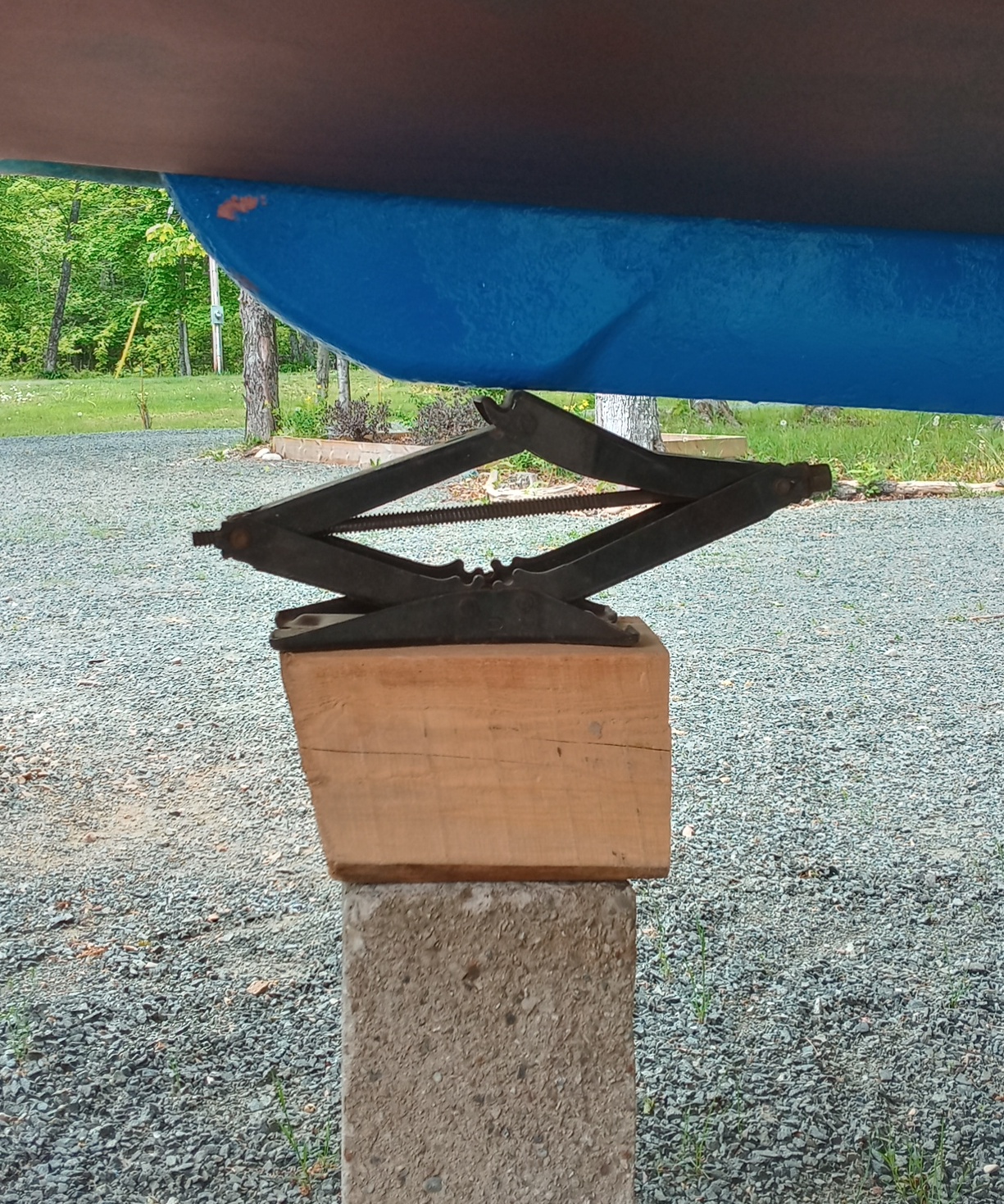

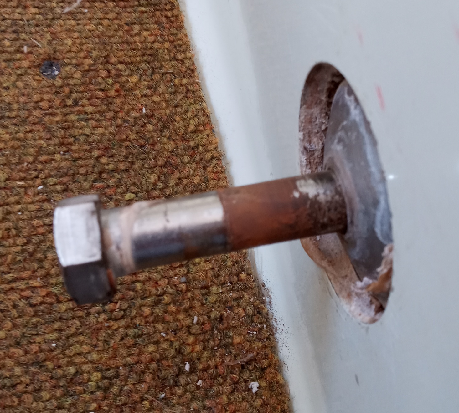

Ok so I left the keel up and used a car jack at the front of the keel to pick up the weight, then tapped the pivot bolt about 1/2 way out see image its a 5/8" bolt. Very little rust and little wear. Bit of a pain getting it back in, but if you stick your head in the storage compartment you can see the bolt alignment, I had to jacked the keel up a little and put wedges on both sides of the keel to line up the bolt.

Also I used a large clamp on the flat part at the front of the keel to tip the keel you'll need to pull the clamp down if you're on port side lifting the keel parallel as it will drop to starboard when the bolt comes out of the starboad housing.

Good to see the info and pictures. Seeing as how the bolt is in good shape, I think I won't worry about mine too much. At my club and the sail shop they said they've heard of cables failing, but never bolts - unless it had to do with someone running aground at speed.

Happy to share, as you see, you can service the bolt while on the trailer. While I was at it, I put heavy wheel bearing grease on the bolt and in the hole. Fingers crossed happy sailing :)
