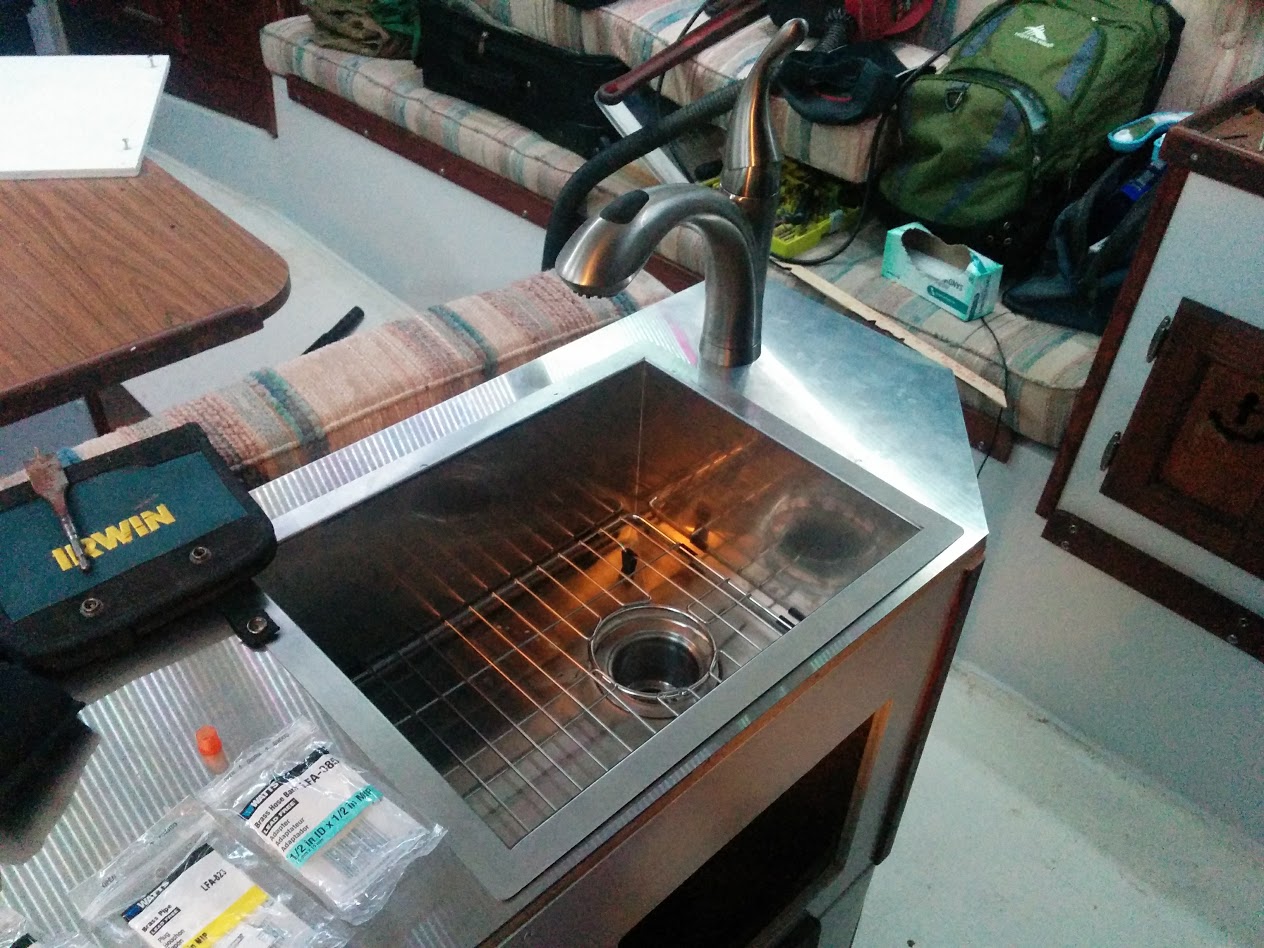

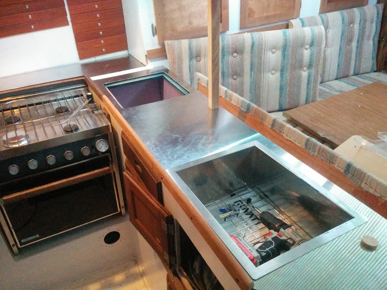

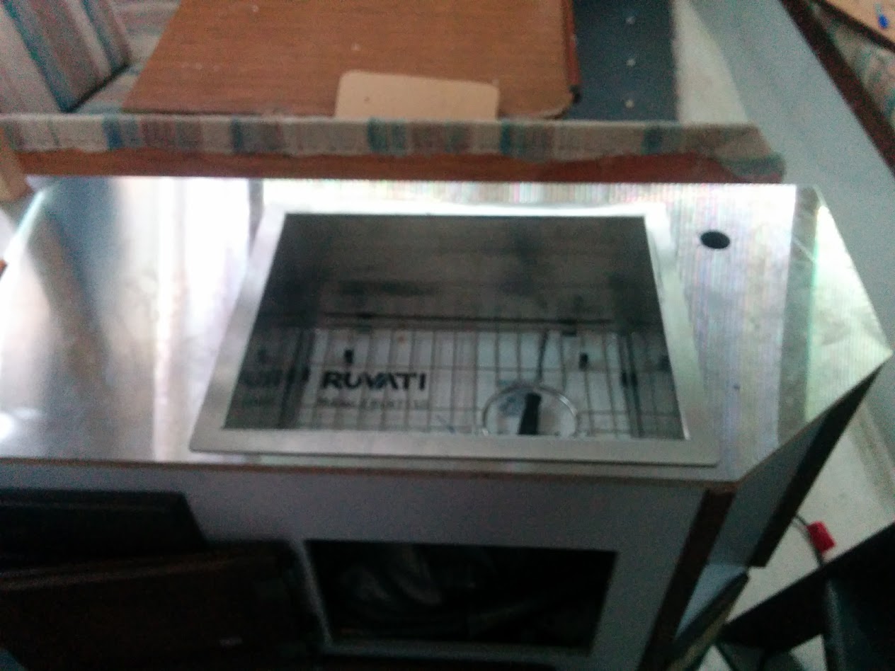

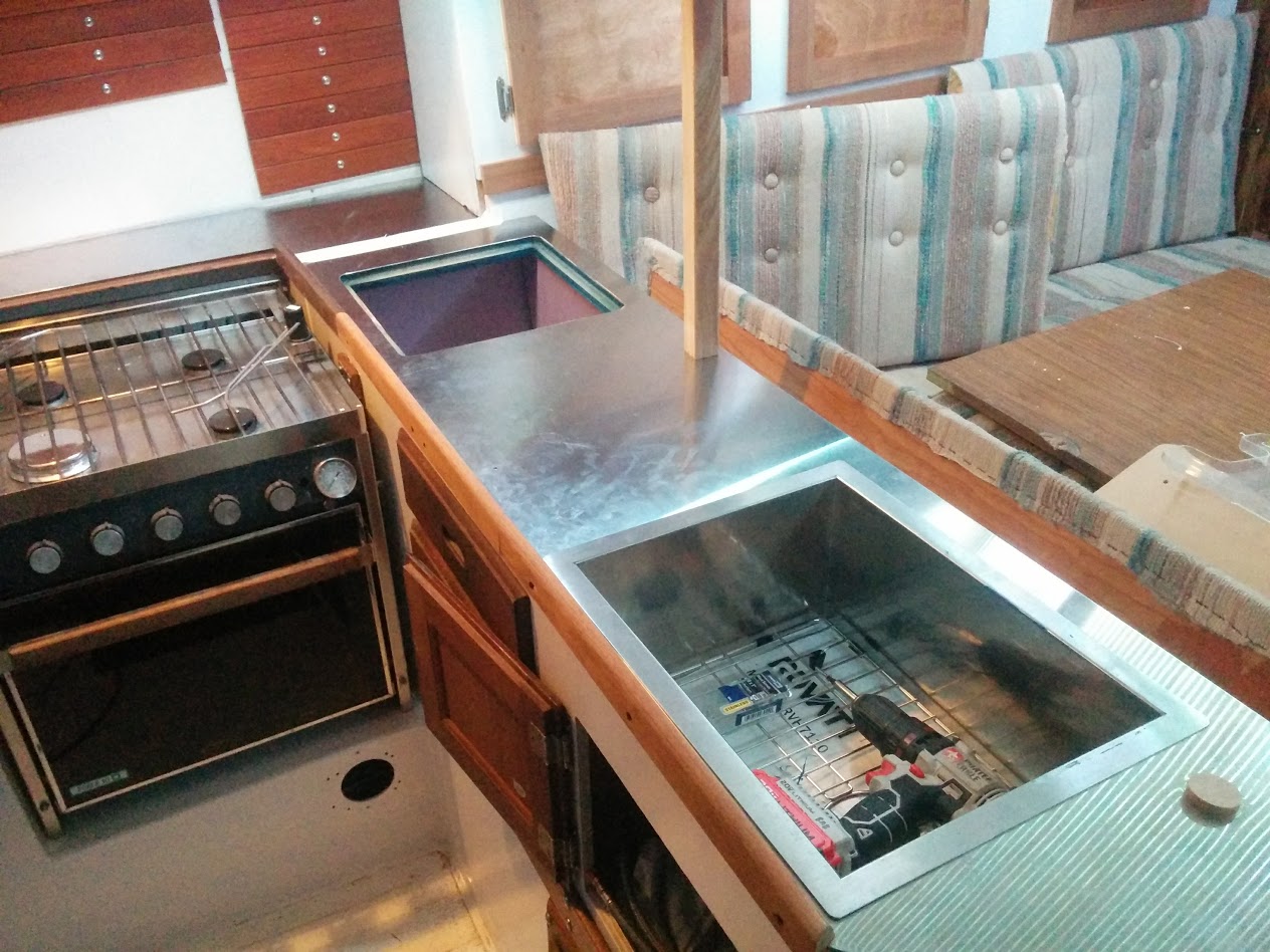

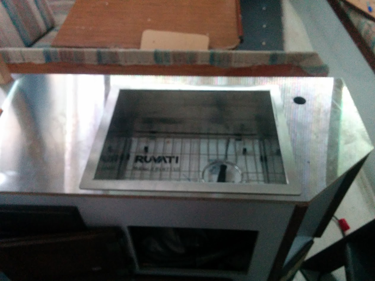

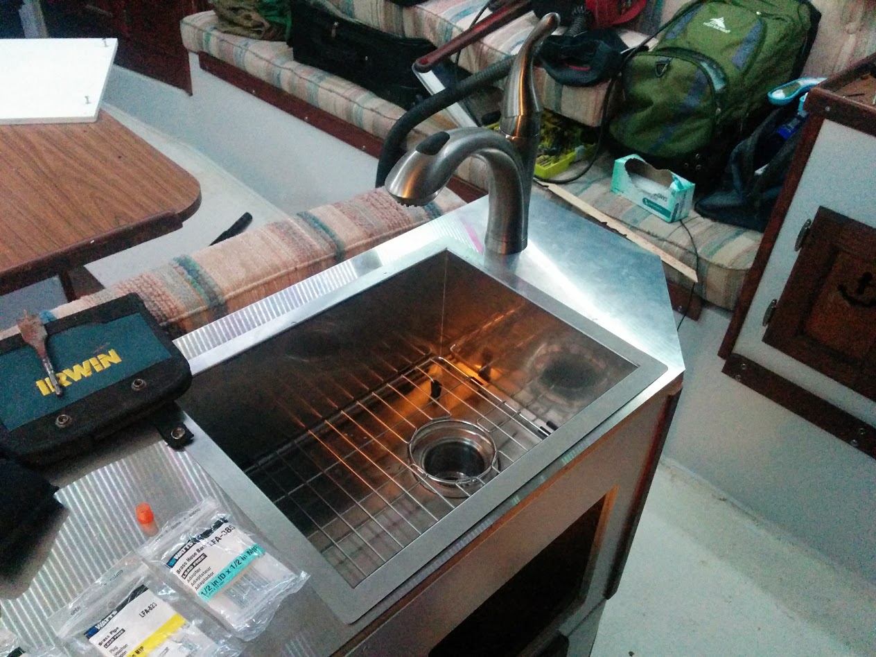

I've redone the galley counter area, made it a bit wider to support the sink. I installed a Ruvati RVH7110 that I moved to the center, and where the old sinks were made a dry storage area.
Wow, that looks really nice!
