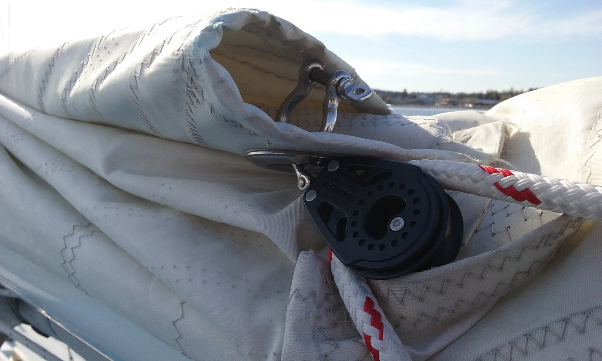

Here is how I rigged the bearings on the cringles. It has now been upgraded from a D shackle to welded SS rings. The bearing blocks did a great job on reducing friction. I have them on both tack and clew cringles.
I used to have the Carbo blocks at both the clew and tack, but a rigger told me to try it without the clew block, essentially increasing friction back there. His argument is that you want the tack to be seated first, and then the clew to make sure the foot is pulled taught (substituting for the outhaul. Also, twice the line goes through the tack block as it must pass both double the length of the tack and the clew, where the clew only passes double its own length. I tried it, and like the set better that way. Give it a try with only one tack block.
