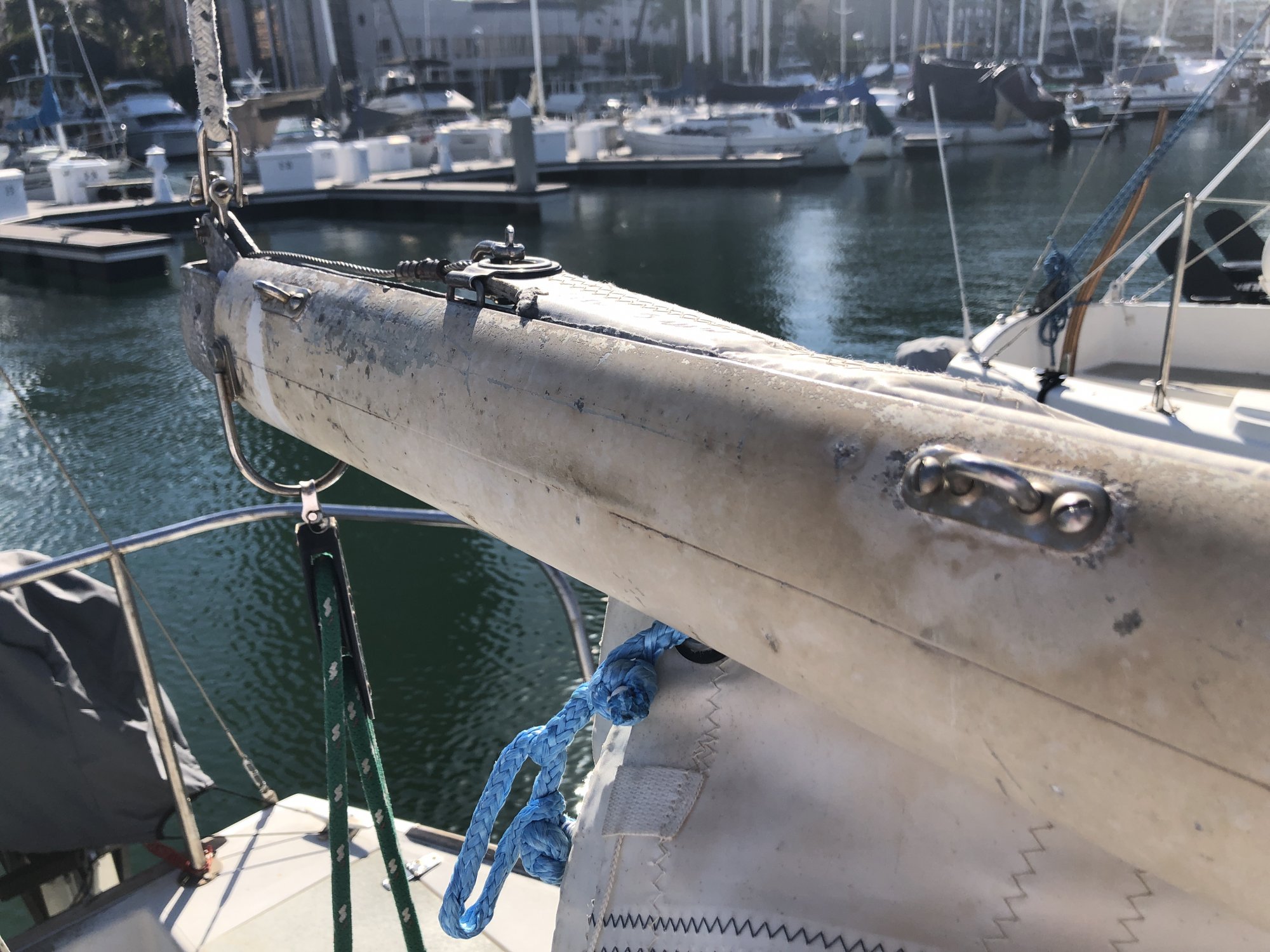

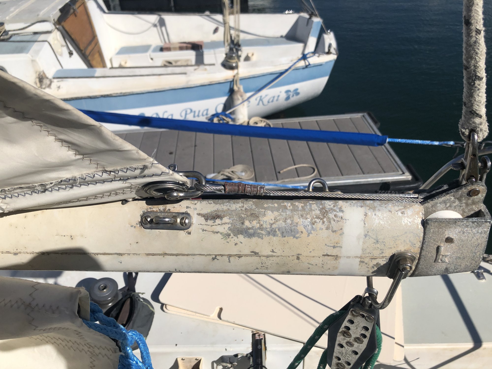

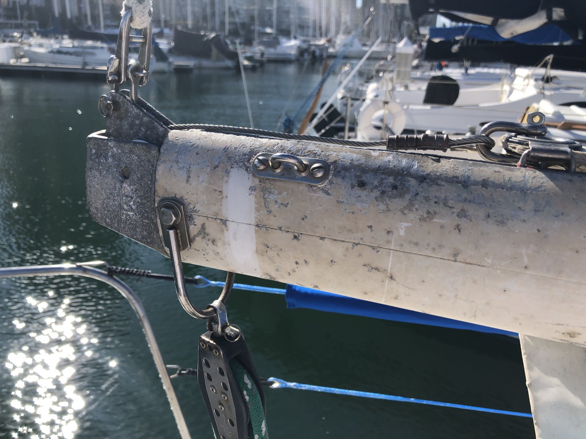

Trying to establish a simple reefing setup and hoping to avoid adding any hardware, if possible. Pics of the existing hardware on the aft end of my boom are attached. There are reefing hooks at the gooseneck, so I'm good there; but, having some trouble figuring out the clew.
Seems I can tie a line to one of these eyes and then run it through the reefing cringle. But, do I need to install a pulley on the other cheek of the boom to run a line forward through a cleat to tension the reef point? Is there any reasonable way to accomplish a reef with what already exists here?

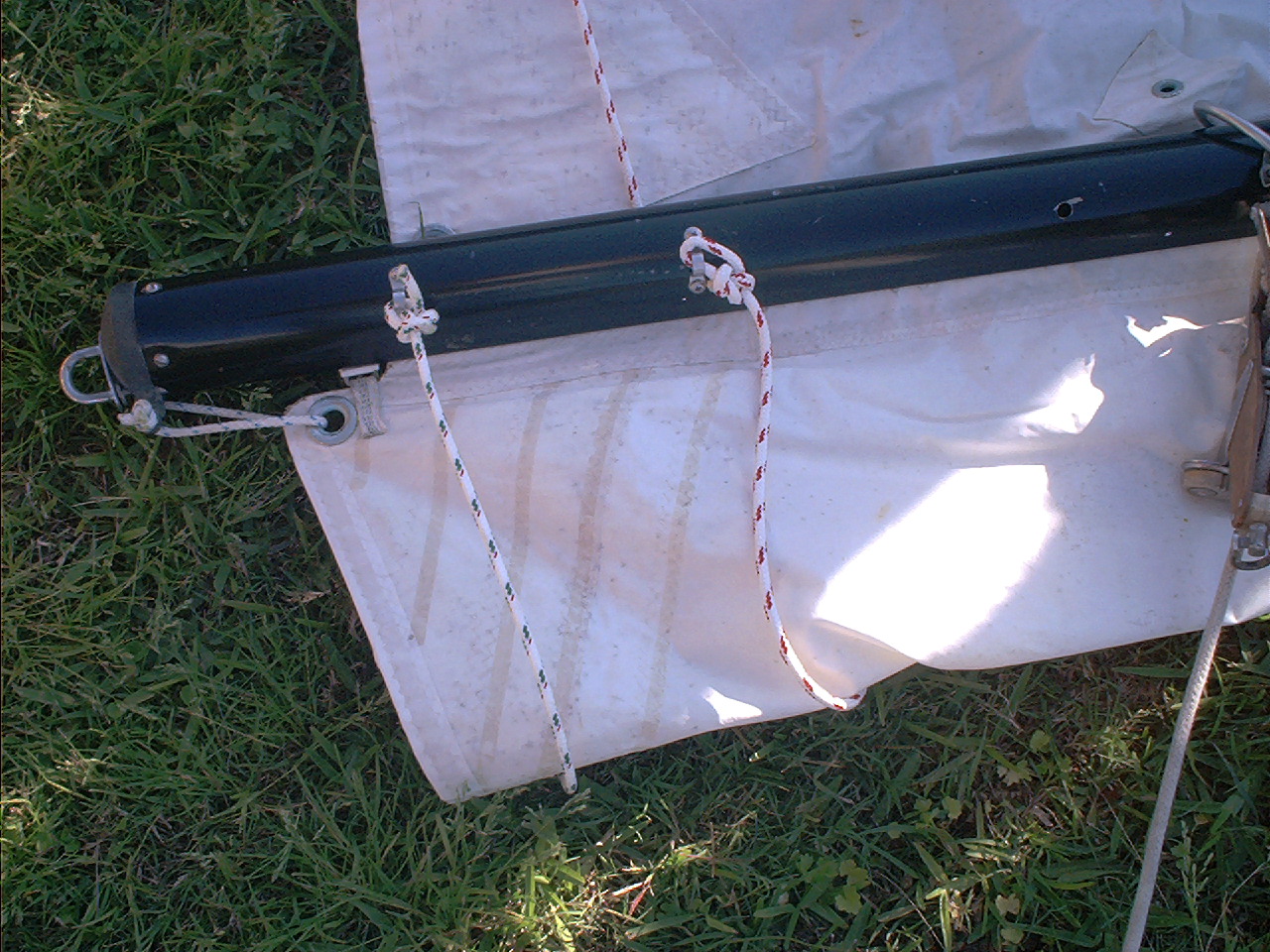

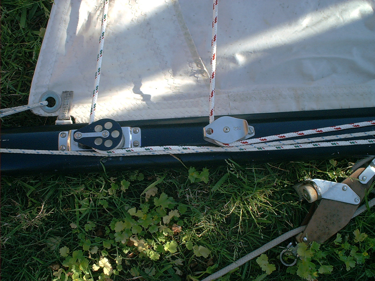

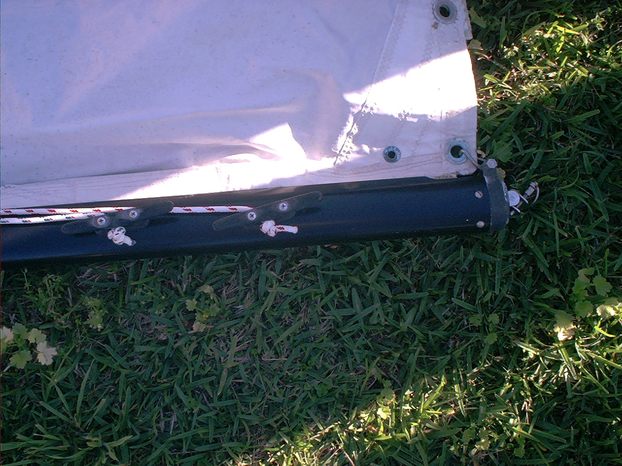

Here's how mine are set up,on both boats-2 reef points
Cleats up close to gooseneck
Off side of boom where lines begin
Blocks on other side where lines lead forward to cleats
And yes, the clew needs to pull down the luff. I use a separate line for each reef, and tie it under the boom

I had the same Kenyon boom end on my Starwind 27. You have 2 sheaves, one on each side of the outhaul for 2 reefing lines (assuming your sail has 2 reef points). You probably have a jam cleat for each side at the tack end of the boom. You can tie your reef line (both if you have a 2nd reef) to the pad eye on one side, pass it thru the reefing cringle and then directly to the sheave on the opposite side of the pad eye that you are secured to. From the sheave the line is inside the boom to the tack end. You can either use the jamb cleats on the boom or not use them and pass the line(s) thru a block at the base of the mast, a deck organizer and eventually a cleat or clutch on the cabin top at the cockpit so that you can secure without going to the mast.
When you don't want to employ the reefing line you can simply untie the clew end of the line and pass it out from the cringle then re-secure the end at the pad eye. I typically just tied a stopper knot and pulled the lines to the end at the sheaves. On my Starwind, I used cheek blocks on the boom directly underneath the reefing cringles to draw the line down before it passed to the sheave at the clew end. I don't think the cheek blocks really added anything. Our Catalina 320 has Gregs set-up, except our single line system works fine as long as the halyard is adjusted correctly, which isn't always easy to get right, I admit.

It looks like you have Kenyon spars and end parts. I'm going to suggest that you look at the Rig-Rite web site and focus on the Kenyon Spars section. It looks like you have the "E-Section" boom or something similar. I'll bet you can find the mast, boom and all of the parts in their catalogue. Since you have a gooseneck with rams horn, I am going to guess that you might have the E-Section Boom Kit with internal outhaul and reef lines. If it's not that, you should be able to identify what you do have. If that is what you have, there will be sheaves at the tack end and a jam cleat that looks like a lever to pinch the line at the boom. I removed my jam cleat levers because I ran the lines down to the deck and back to the cockpit.
You can try with fish tape, but it would probably be easier to simply take the boom off and turn it vertical so you can simply drop the lines thru.

I use a two line reef system with lines running through the boom. My boom has the end sheaves like yours. Near the mast the boom has two exit fittings. The port or starboard reef lines exit the boom there and tie to a cleat or are clamped depends on your choice.
Yes you will need to fish a messenger line through the boom to draw the reef line into place. My boom has a plate which when removed allows you access. Be sure in running the messenger that your lines run fair. It is easy to get them crossed over. Goal is to avoid any crossing lines. Crossed lines add friction and an opportunity for chafe.
Opinion: I tie my reef line with a bowline to the boom. Run the line up on port side of sail to the clew reef cringle then down to the starboard sheave. This keeps the line fair. I tie on to the boom because my sail is loose footed and I can. I figure. The reason I am reefing is because the winds are up. I do not want to trust my sail control to a screwed into the boom padeye even if it looks substantial. I suspect the screws do not have backing plates (you can check). All the force of the sail is being applied to the screw threads into the aluminum boom. In my thinking a bowline on good line is a safer attachment.

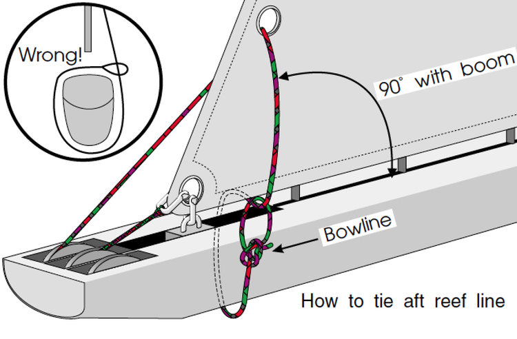

Pretty sure it was @jssailem who posted this image showing how he ties the reefing line to the boom. Works well.
To run the line through the boom, I used “fish sticks”, 6‘ fiberglass sticks that screw end to end to make a long rod to pull wires through walls, ceilings, etc.
24,623
Yep... Ward you have a great memory... That is the way I rig my reef lines.
The system pulls the clew down toward the bowline, and then back towards the end of the boom. Sweet.

Thanks for all the advice. I fished the line through a few days ago. It's running through the track on the port side of the boom, so I'll take the aft end, pass it through the cringle, then tie to pad eye on the starboard side. My sail has a bolt rope, so I'm not sure I can tie directly to the boom, unless I'm missing something. Anyway, the line runs forward through the boom and comes out as described by Scott and John. I'll give the system a try this weekend.
