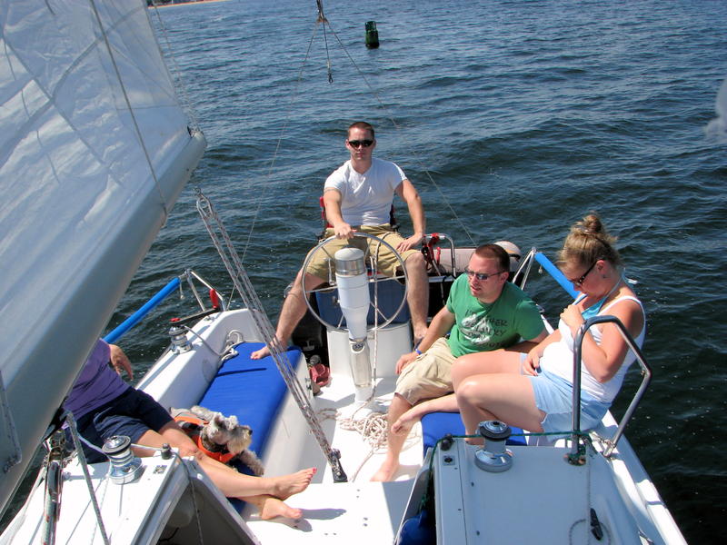

If you spent some money to run the Genoa sheets back to the coamings close to the wheel like this boat you would be fine.
Nov 8, 2010
11,386
View attachment 118846 If you spent some money to run the Genoa sheets back to the coamings close to the wheel like this boat you would be fine.
A great idea when possible. How did you get the Genoa sheet back there from the tracks on the cabin top? A quick look shows no really good way to get a fair run and end up with a correct approach angle to the winch.
Jul 14, 2015
840
Catalina 30 Stillhouse Hollow Marina
Not my boat jack. Just found photo on internet. Do not know how he got from tracks to coaming. only photo of end result.
Nov 8, 2010
11,386
Gotcha. I'm guessing those are spin sheet winches... Our First 260 has a similar set for spin use. But getting the Genoa sheets back there is very problematic.
