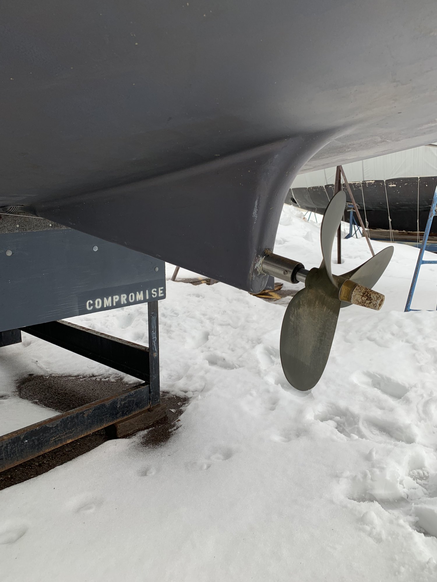

Last year, we moved up to a Beneteau 393 and it seems that we have a singing prop. It is quite loud and takes some of the enjoyment out of gliding along with only the sound of water and wind. I brought this up with a Beneteau forum and since I got some inconclusive answers, I thought I'd root around here to see what comes up. My search through the forums here yields similar results but I thought I'd try again with a new post on the topic. I'm almost 100% certain that the singing prop is the issue but I'll lay out my case. The boat makes a very pronounced hum similar to a wine glass rim when rubbed with a wet finger. It only appears at certain RPM, and it doesn't matter if the boat is under power or sailing with the transmission in neutral (Yanmar says not to sail in reverse). The boat has a three blade fixed prop and I've heard some suggest filing an "anti-singing edge" on the forward edge of the prop blade. This "fix" seems pretty contentious as many people argue that this will make the prop unbalanced and will do more harm than good. More research on the subject shows the edge should be filed to a rather sharp edge 40-45 degrees. Others have said the edge of the prop should be squared off to prevent singing so there is quite a conflict in blade edge geometry.
I'm considering buying a feathering or folding prop because this will surely remedy the situation but I thought before I invest such a heavy amount in a new prop, why not see if I can get a relatively conclusive answer to whether or not the anti-singing edge is worth a shot.
Thoughts?

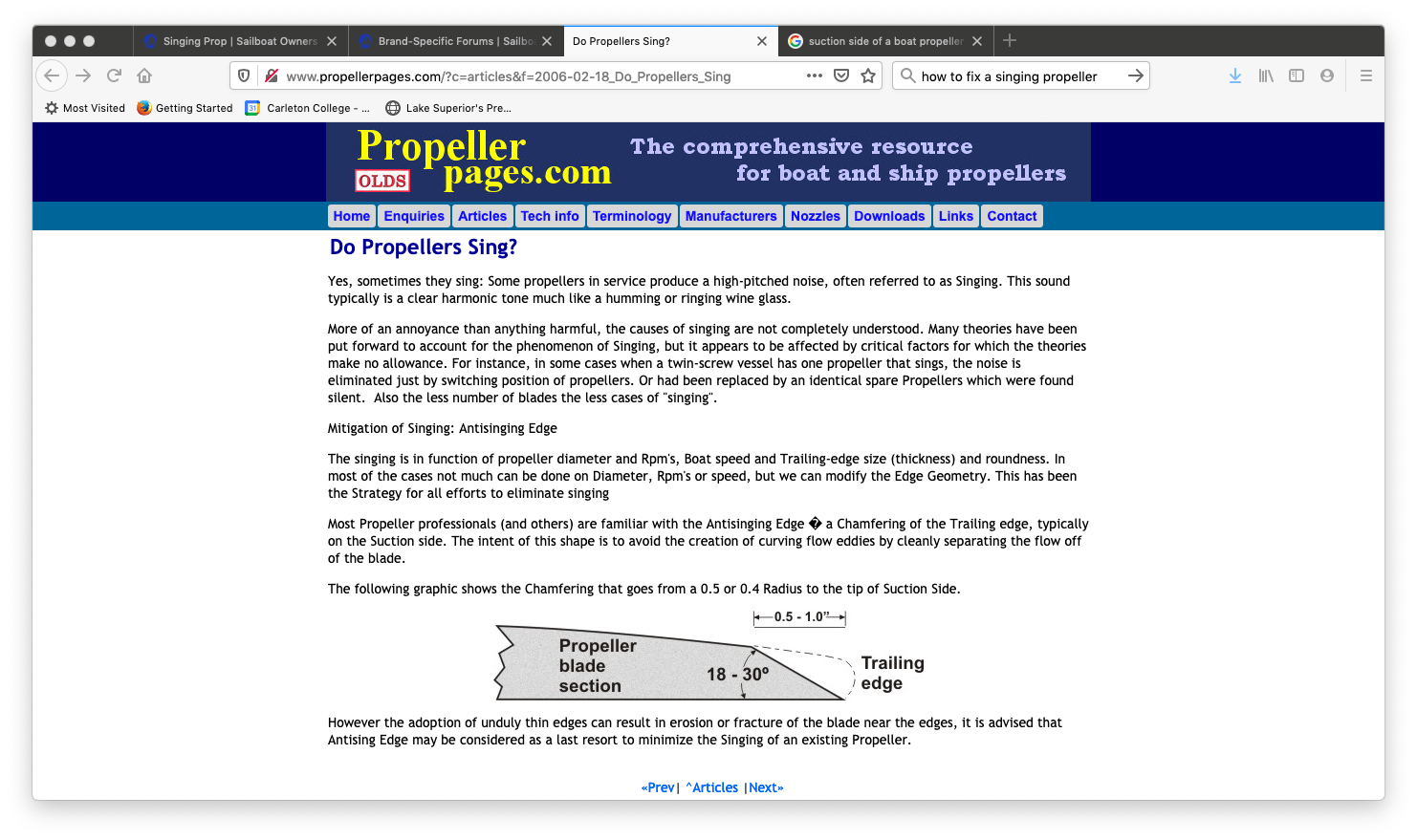

The singing prop is definitely a real dilemma. Here's one diagram noting how to file this onto the prop but it seems like a last resort.
This article speaks to filing the trailing edge and your initial post says forward edge so it would be a good idea to figure out where you will file it :)
To me it doesn’t make sense that the RPM’s of a prop would generate a high enough frequency - vibration to make the prop itself sound like the wine glass noise. The drive shaft rotation causing something else to vibrate makes more sense.
As a test is there a way you can lock the prop from rotating for a short while or remove the prop or borrow a different prop like a two blade or .....to help pinpoint the source?
You see my dilemma! Props have a leading edge and a trailing edge and each of those edges has two sides so figuring out where to file is pretty critical.

Here is what the old prop looked like.
Not only did it groan, but it provided a lot of prop walk and when under power pulled the stern down a good foot bring the exhaust beneath the water line and depositing a lot of diesel soot/grime on the stern.
Here is the image of my new prop.
Better thrust, no issues with exhaust
The new prop, a Campbell Sailor, does not make the noise. I think it is more efficient in design. It does have a blunt leading edge and a progressive curve to the blade not on the old "michigan wheel". This leads me to believe that the noise I was hearing could be associated with cavitation that happened on the edges of the prop blade and tips as the blade speed increased.
That would suggest your altering the prop shape might change the harmonic sounds from such cavitation.
Mind bending for sure :) Not kidding hard to visualize!

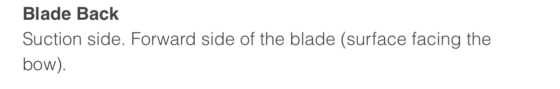

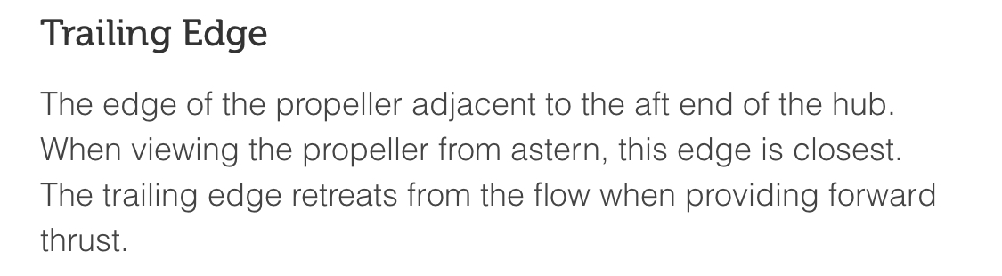

This might help
This is my guess ;)
I think your photo link above is “thinking”that the chamfering would let the water “slide” off the blade without causing turbulence. Way above my pay grade on this one ;)

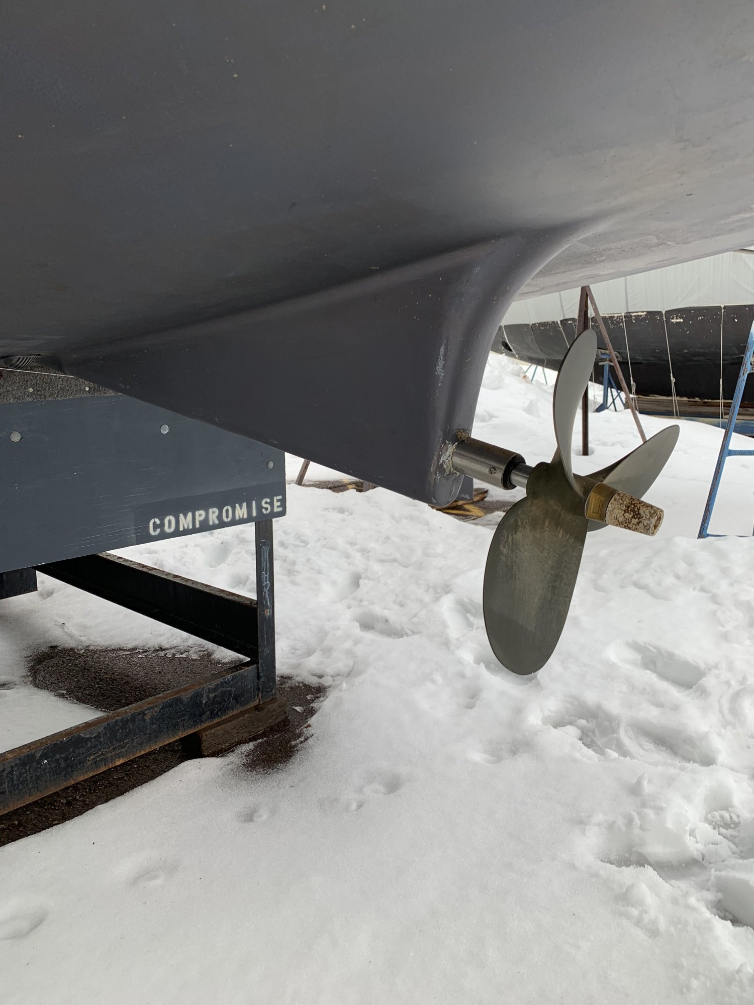

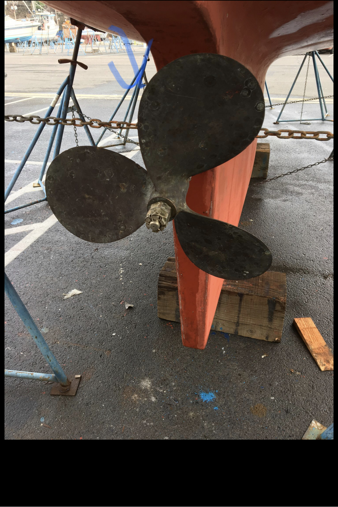

Looks like I have a similar prop to the one you replaced. I looked at that Michigan Wheel page and I think we’re on the same page about the portion on the prop to modify. Now, would you do it?
Sep 22, 2018
1,869
Hunter 216 Kingston
Looks like I have a similar prop to the one you replaced. I looked at that Michigan Wheel page and I think we’re on the same page about the portion on the prop to modify. Now, would you do it?View attachment 188733
Not sure who you are asking. If it’s @jssailem I would value his opinion. If it’s me @Hunter216 then I would be careful as the power on my “Yacht” is a tiny Honda outboard. :)
Since you might be asking me ;) I wouldn’t do anything to what appears to be a pretty expensive prop on the “speculation” it might fix your problem.
Take some time to pinpoint the source of the noise and then go from there OR if you are convinced it’s the prop - change it while you are on the hard and cross your fingers you are right:)
