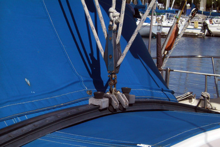

I'm in the process of slowly and modestly improving a 1980 C-30 tall rig which is currently in the water.
The current traveler arrangement is factory original which makes getting the boom upwind much more laborious. I would like to rig the original traveler with updated controls improving my ability to trim. It does not have to be beautiful state of the art, I am aware Catalina offers a brand new drop in replacement.
I included an image of a boat I noticed in my mooring field which accomplished this upgrade and I was wondering if anyone could comment on what hardware to purchase or if they have done this already. Any specs, a parts list or recommendations would be very helpful.
Also included is a stock image from Catalina Direct (just to refresh your memory:) of how my traveler is currently configured.

Prime, you have no lines to adjust your traveler? Is that second picture a manual, hand-adjusted setup?

Yes it is , I have the same on my 1982 and also wondered if an upgrade of the original was feasable without going to a flat traveller

IMHO, I would go with a new straight traveler package. By the time you've purchased the materials to modify your old one, you're close enough to buy the new one.
We have the curved traveler with end blocks and lines. There is no problem getting the traveler car windward or leeward, plenty of purchase . We cured the mainsheet easing problems by going down to 3/8" 12-strand line and removing one block (at the gooseneck).
BTW, the first picture seems to show the fiddle block at the traveler car having a cam cleat. With the green mainsheet coiled up there, it looks like the sheet can be worked from the helm, while at the same time, the other end is lead forward and can be trimmed at the cabintop winch too? This double-ended method looks REAL handy. All I'd have to do is replace my current fiddle with one having a cam. Thanks for the pic!
The second picture is the current setup on my boat. I'd like to install end controls and amend the current track car, just need specific suggestions on hardware. Thanks, Alex K.
