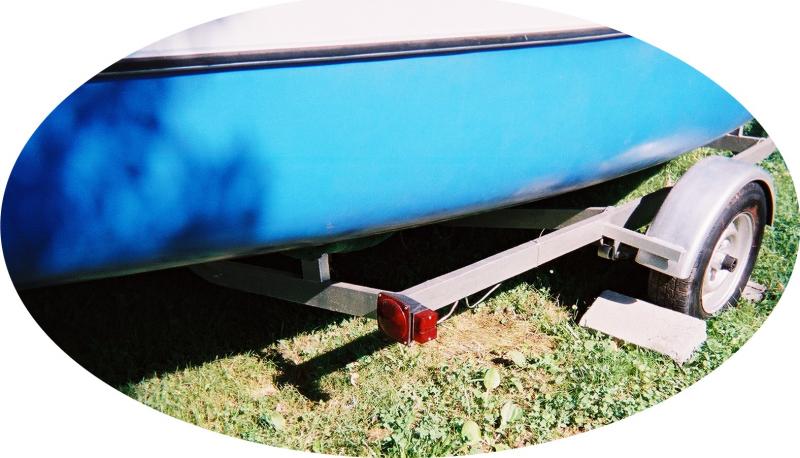

Roll and tip is simple...
You want to use the rollers made specially for a smooth finish...
they look like this...
... and you can find them at Lowes or Walmart.
Roll the paint on... and then using a dry 2" cut brush, gently drag the very tip of the brush over the top of the rolled on paint. The idea is that you are "knocking down ... or tipping over" the high spots in the paint. You don't want to drag so hard that you leave brush stokes... very gently.....
Then the paints natural leveling will give it a nice smooth finish. Use high gloss rustoleum for great shine. The Mac 22' pictured above has rustoleum on the bottom..... you can see the trailer's reflection in the bottom paint.

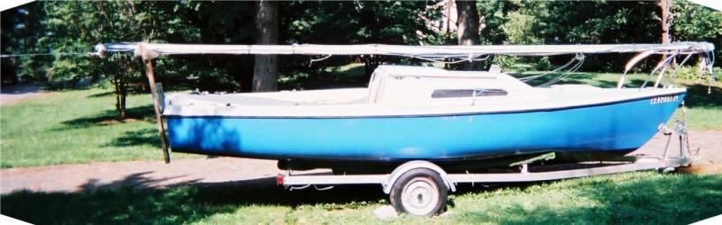

This was my Mac 22-2. The bottom is Rustoleum, the sides are something else... all roll & tip.
If you go with a sprayer, you should wear a respirator... and it is a lot more work for something that is a toy and should (if used properly) get banged up again.
Just 2-cents...

A couple of thoughts on that.... first.... the big advantage of Rustoleum is that you can find an exact color match years later... so beach on my friend.
Second... it is roll and tip, not just roll. I think if you use the roller method without tipping, you will be disappointing in the paint job. Here is a pic of the first boat I rolled and tipped, it is a Mac V21. The entire sides are a Rustoleum blue called "Sail Blue".
