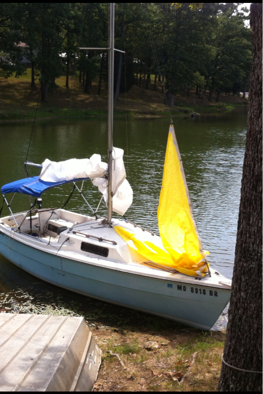

Newport 17 17 Trailer
Before you say it,yes I have look at other threads talking about bottom paint,but there were way to much info to come to any definite answer!
With that being said:
1. Only sail in fresh water
2. Boat never is in water for more than 8 hrs
3. Boat sits on trailer most of the time
4. My wife says "paint that stupid boat"
5. Low budget!
There it is,please simple answers, don't need information overload.
Thank you in advance.

My lovely wife hates the powder blue, wants it a darker blue.

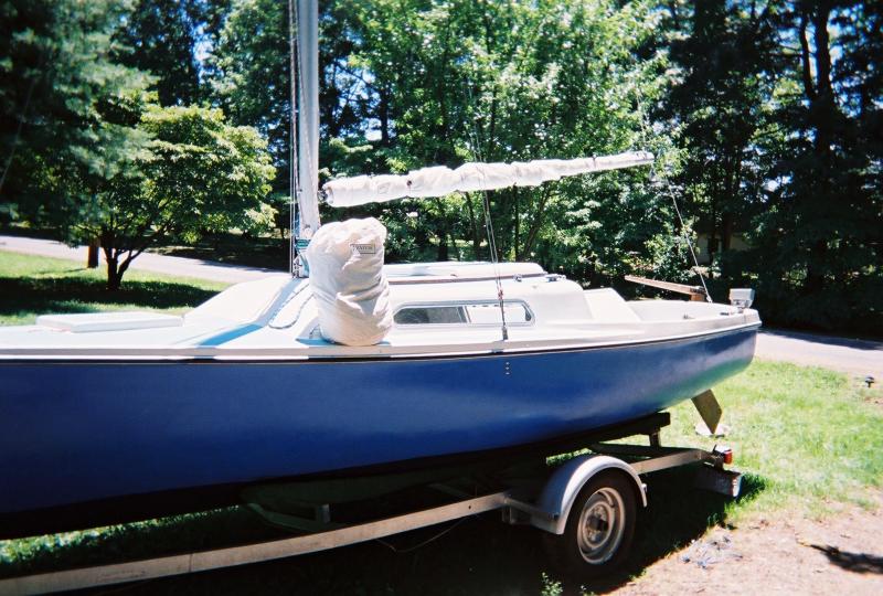

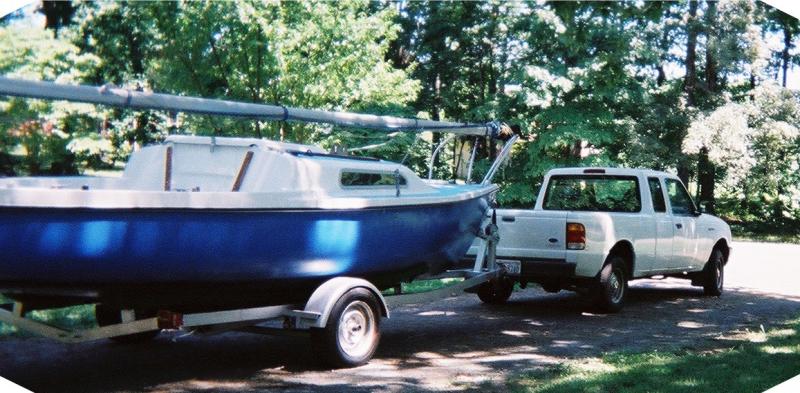

I Love LOVE the results I have gotten with Rustoleum on GRP boats. See pic of a MacGregor V21 below. I have used rustoleum on three different boats with great success. Get a gallon and use the roll & tip method.
Get a foam roller that specifically says it is for smooth finishes. Get a few 2" cut brushes. Then clean and lightly sand the boat. You HAVE to clean it first and get all of the old wax off of the boat. Then a light sand and a pressure wash.
Roll on the paint and follow with the cut brush. You want to very gently "tip" the tops of any marbling in the paint with the very edge of the cut brush. The cut brush is dry and has no paint on it... and periodically you need to clean the cut brush.
It is a two person job and will take about 2/3 of a gallon of paint, two rolls of masking tape, 4 roller pads, two cut brushes and about 5 hours of work (including the sanding).
The particular color in the pics below is called "Sail Blue" by Rustoleum,,, you can even see the reflection of the trailer in the paint.

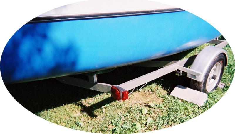

... the red paint in these pics is also Rustoleum. I recently fixed up a Balboa 26 and repaired the keel ... stripped the ablative bottom paint... put on some barrier coat and then covered with rustoleum....
I've used it a lot and have always been happy with the results.
The other paints being suggested are good (maybe even better) paint but ... we have trailer sailboats and we don't let your boats sit in the water for 2+ years at a time. For me, it does not make sense to pay the extra for protection I don't need.
