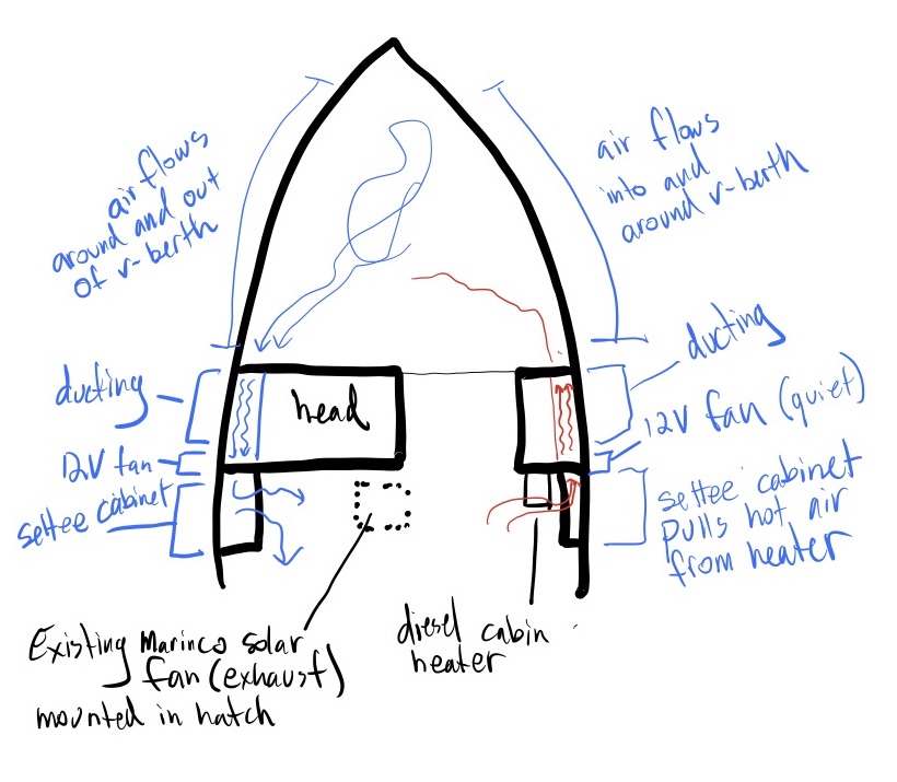

I am admittedly a bit of a dreamer (not always congenial to the median straight-forward engineer attitude in this forum!), but has anyone ever designed a highly integrated air circulation system into a boat? Possibly one that approaches true silence?
I am thinking mostly to circulate temperature gradients within the boat but also possibly fresh and stale air from outside to inside the boat.
See photo of my Catalina 30 concept. I know this is "over-engineering," but are manufacturers doing this sort of thing on newer boats? Or are they all just using forced-air or hot water baseboard heating/cooling systems that accomplish the same task?

We had our bathroom re-done several years ago and had a new vent fan installed that reduces the noise of the fan by placing the fan & motor up in the attic on the rafters several feet away, which is probably not practical for a boat. For computers they install bigger fans in the rear of the case and then just run them slowly enough that they don't make as much noise, while moving the same amount of air.
