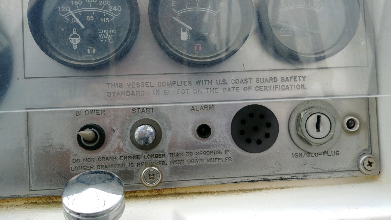

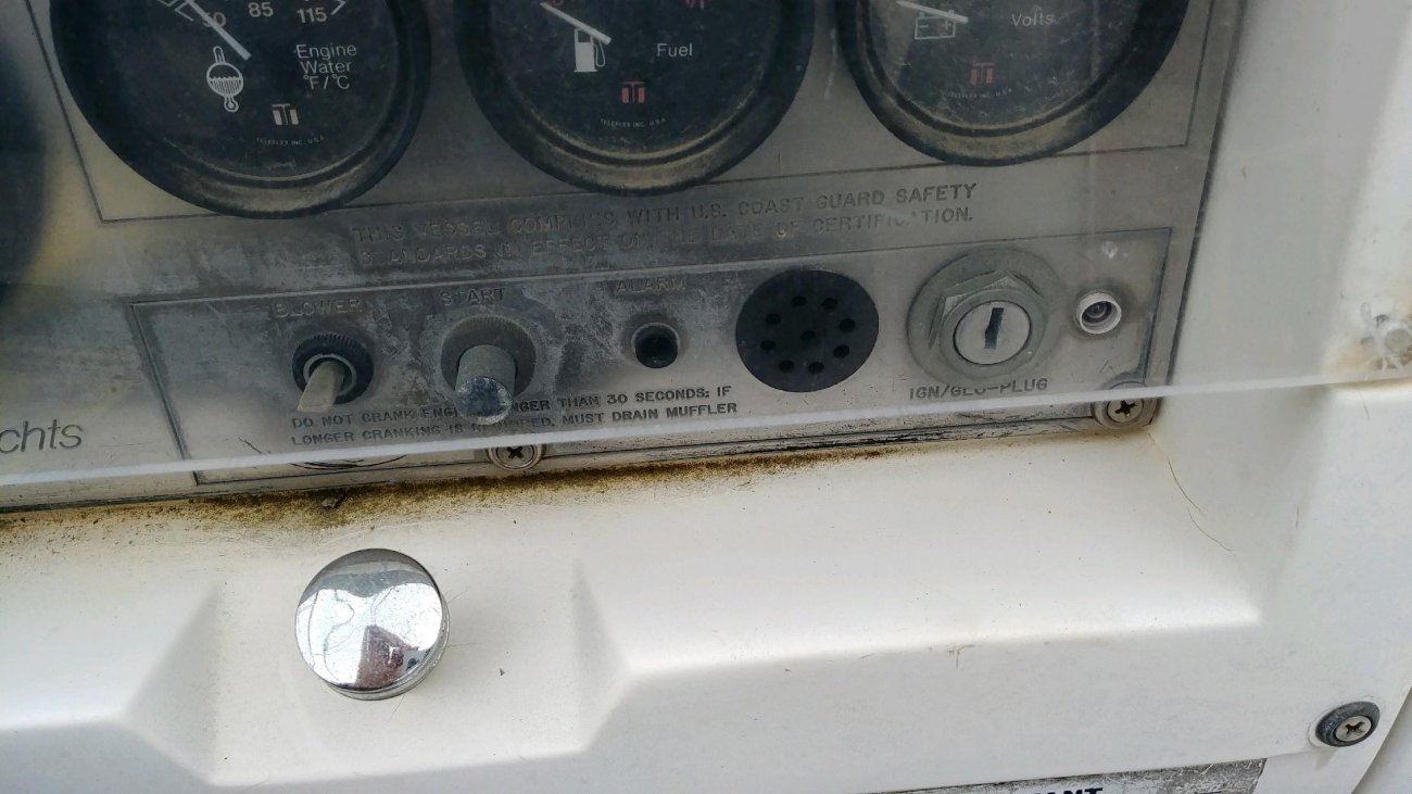

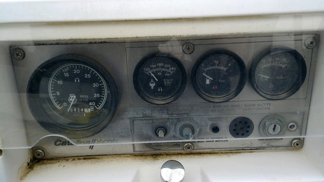

The Universal Diesel Engine Manual states that the M-25XP has a separate stop lever for shutting down the engine.
It also states do not use the decompression lever to stop the engine .
I'm sure I'm missing something simple but I only see one knob. Is this the shut-off or decompression lever.

I've never owned a Catalina 30 but I'll take a wild guess and say that big silver knob is the fuel shut off to stop the engine. I've never seen a de-compression lever in the cockpit of a boat and neither my Universal M-12 nor my Perkins 4-108 have a de-compression lever.

Decompression lever should be close to the engine. My guess is that the knob near your engine panel is the stop lever - should stop fuel from flowing to the engine.

I can tell you just about anything you need to know about the M-25 series. The cockpit panel has the pull knob on the cable that controls the fuel rail. OEM, Catalina installed a black T handle cable — a PO night have replaced a failed one w/what looks to be a carburetor choke cable.
The compression release is a spring loaded lever on the back end of the head cover (valve/rocker arm cover in USA terms). You don’t use that one to shut down. One of its purposes is to spin the engine quickly if your battery is down ( close it while spinning and hope she starts.). Check the spring on the lever — the hook has a tendency to come off one end.
C’mon over and join in on the International Catalina 30 Association forum and connect with 1,600 C-30 experts (fellow owners) there as well.
https://groups.io/g/Catalina30
If you look (in the oil dipstick hatch) on the engine stbd side near the front, you will see the (labelled) “STOP” lever that the cockpit cable actuates to shut ‘er down.

It appears that you have a Mk2 C30 like my 1988 tall rig / bow sprit. The knob on your engine panel is the fuel cutoff for shutting down the engine. The decompression lever is about 3" long at the rear of the engine on the starboard side. To test it to see if it works, have someone hold the lever open (against the spring pressure) and crank the engine. It should spin smoothing without the normal surging you get from the compression stroke on a 3-cylinder engine.

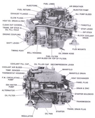

23,500
When we bought our boat with an M25 engine, I went to the TOAD website and downloaded the engine photos, which showed all the parts.
