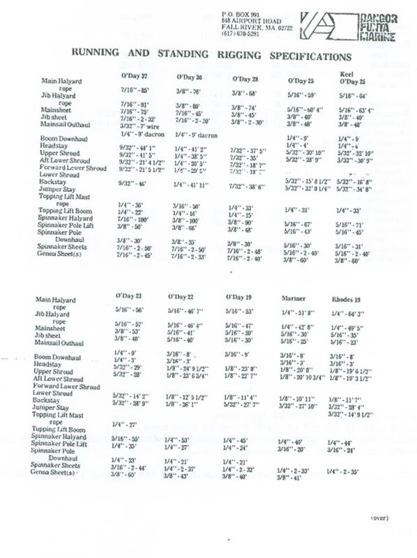

If that was the memo from O'DAY circa 1979, listing the dimensions for all models offered at that time, then the lengths are with the turnbuckles fully closed (that is tightest rigging, since shroud/stay lengths are as short as can be). Most riggers base measurements on having the turnbuckles about 1/2 open, so I would check the difference in the turnbuckle adjustment between fully closed and 1/2 open and add that to the lengths.
This is the O'DAY 25 info from that memo:
O’DAY 25 RIGGING SPECS
(Taken from a 1979 O’DAY memo)
(All Lengths and specifications are approximate and are subject to change without notice)

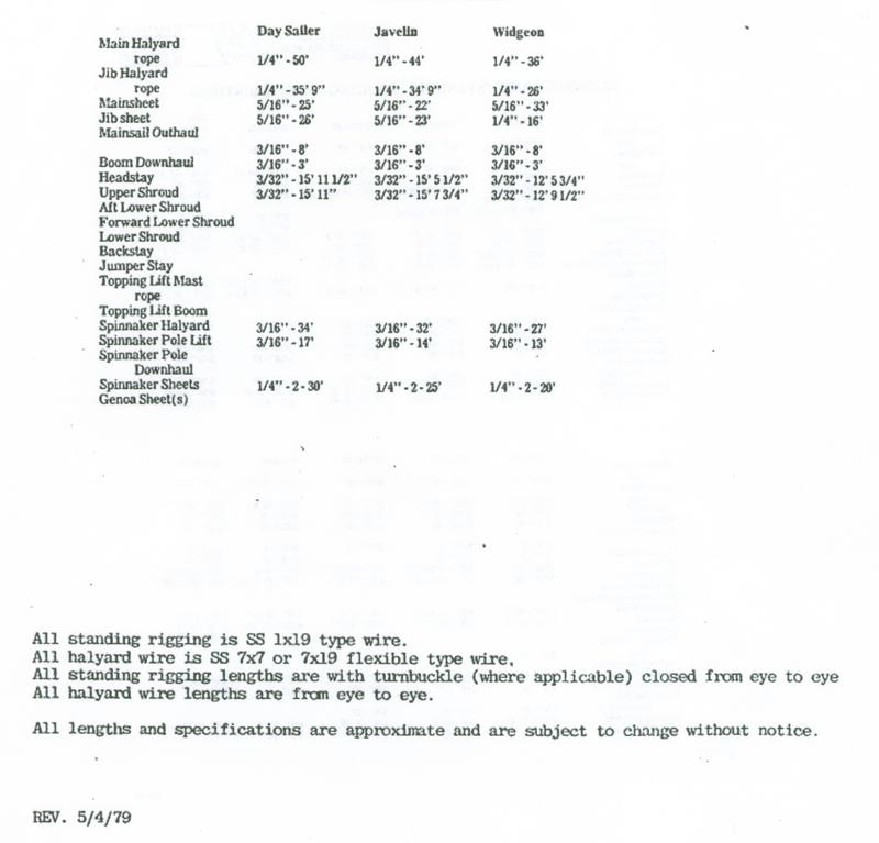

All Standing rigging is SS 1x19 type wire and lengths are with turnbuckle (where applicable) closed, from eye to eye (most riggers measure with turnbuckles half-closed, so be sure to note this and/or bring old rigging to rigger to measure for replacement)
