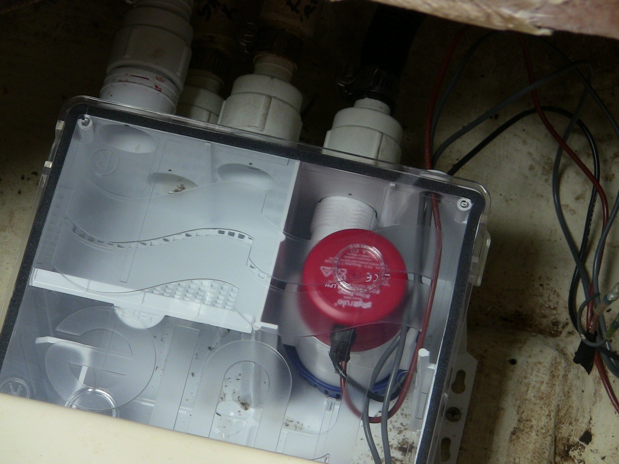

We have spent years with the Rule drain boxes like shown above, and while they do trap the gunk, they are obnoxious to clean out, leave gross smelling water in them, and the small pump fails often from accumulated hairs that do find their way out of the strainer and around the shaft. Or they just burn out. The pump isn't difficult to replace, and it is a commonly found one, but it is annoying.
On two boats with these now, we have replaced them with the Whale Gulper pumps that you consider too expensive. We consider it some of the best money spent on the boat. These things just eat and expel anything that goes down the drain. We make no effort to strain and do no maintenance or cleaning of them.

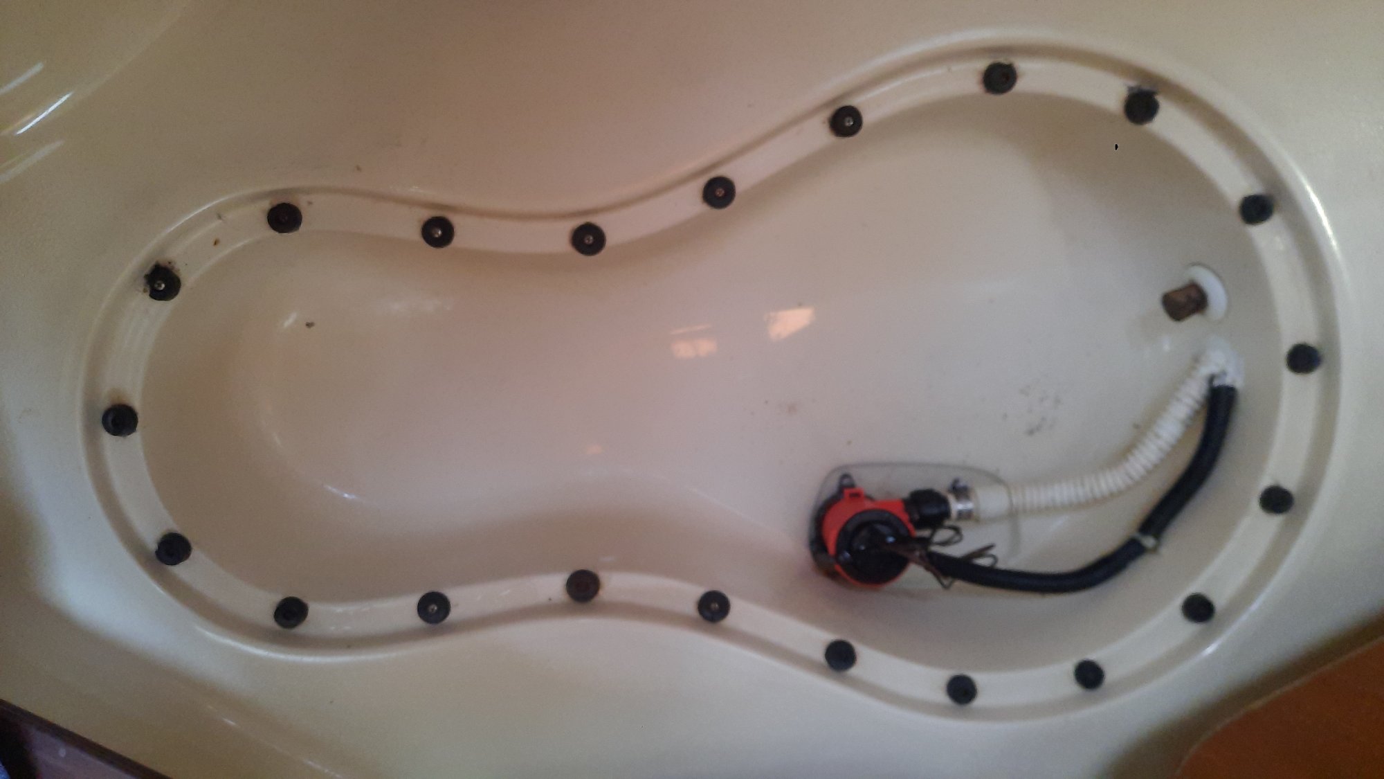

Feb 10, 2004
4,228
Hunter 40.5 Warwick, RI

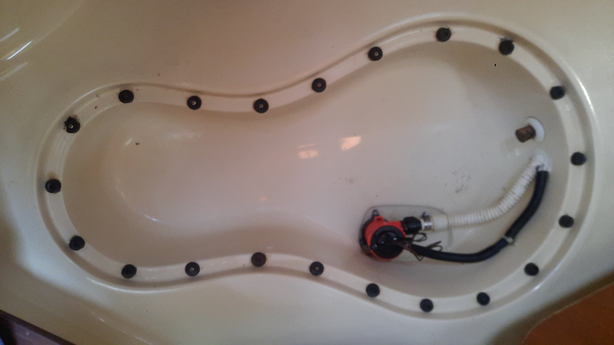

Here is a picture of my shower sump(s). I will look at the gulper pump again.

That picture is helpful. I'm not sure you can fit a diaphragm pump in there, but I also can't tell the depth. I also don't think they are submersible pumps. Pretty sure they are not.
You would need to install a strum box or similar where your current pump is, and a diaphragm pump somewhere in-line in the hose leading from it.
The valves used in the diaphragm pumps are rubber flapper valves, and there is a double layer of them. Similar operation as used on toilet pumps. At most, something might get caught enough to temporarily prevent the flapper from fully sealing, but this just gets carried off soon in the flow.
Mark

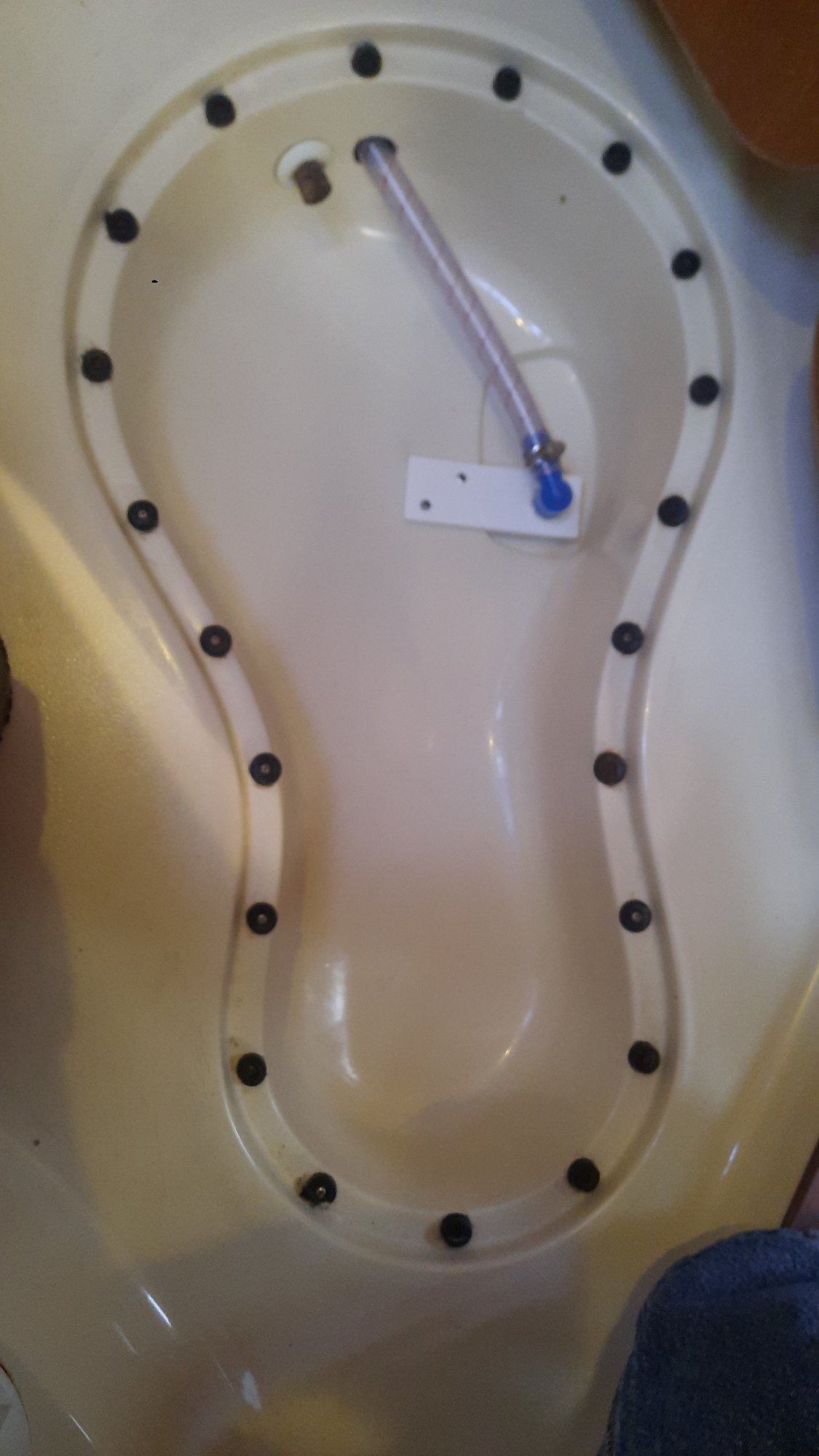

My final solution:
All of you were correct. The Whale Gulper 220 pump is the way to go. I opted for the non-auto one and I installed it on an existing shelf under the vanity sink. I first removed the shelf and cut a couple areas to allow slight re-routing of the hoses. Post #11 above shows my original sump. It is about 6" deep and the old pump sat in a shallow area that is the lowest point in the sump.
All of that was removed and a new hose was routed from the Whale pump to the sump. I cut a piece of 1/4" sheet PVC and drilled a hole to hold an elbow with a 1/2" short PVC pipe that was fastened to stand about 1/8" off the bottom of the shallow area.
This system works GREAT!! All of the water is sucked up and expelled from the pump. After a shower, there is just a trace of water in the shallow area and no standing water anywhere else.
Thanks to all for your advice.
Here is what my sump looks like now:
