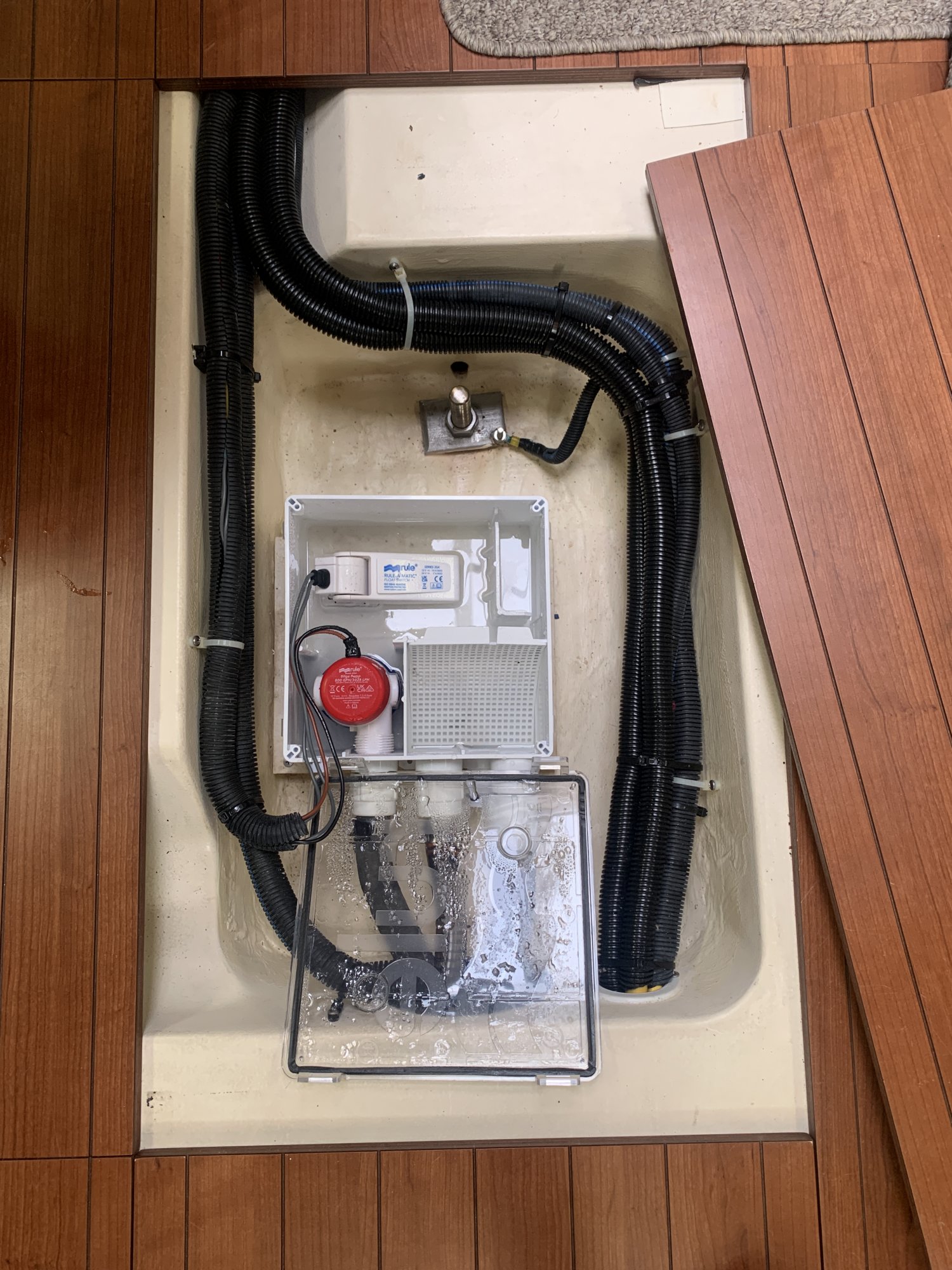

On our new (to us) MH-31 sailboat, we’ve got a Rule 800 GPH shower drain & sump pump, which services both a free-standing shower and the vanity sink drain in the head. I’ve noticed that there's always about 2”-3" of standing water in the white plastic box that houses the pump and float switch.
Is this typical? The float switch is working but I wonder if it’s waiting too long to activate, at too high of a water level? ...and perhaps I should replace the float switch...

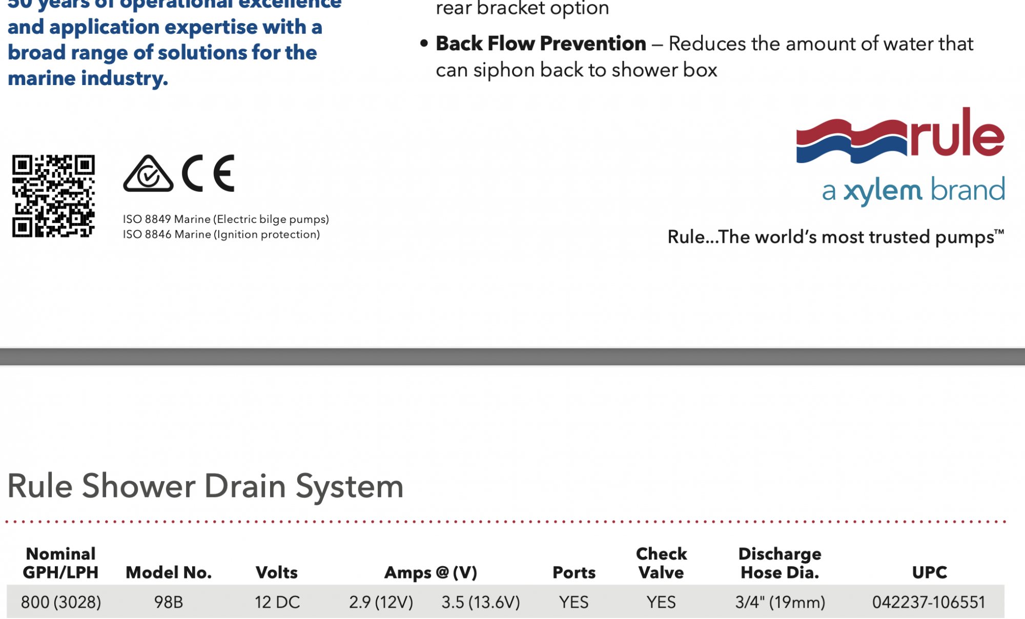

Not True on the newest model of 800 GPH sump pump.

It seems to me the only difference between the OP's setup and the 98B system is a check valve in
the 98B system.

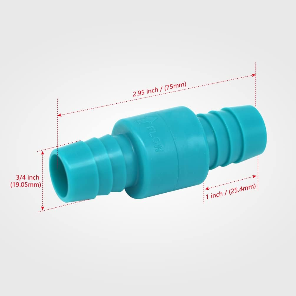

The OP might be able to re-rig his boat with a check valve in the discharge line without the cost
of a whole new system.
Am I missing something?

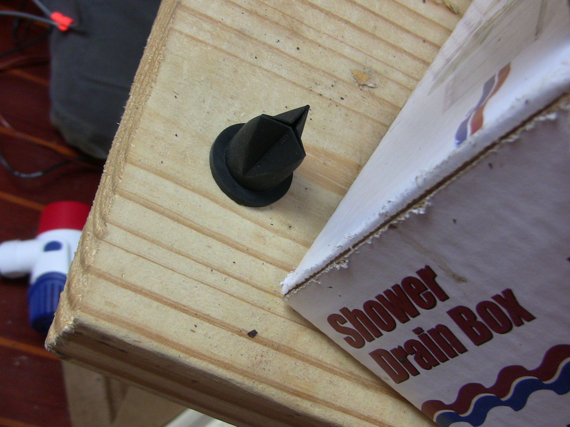

And it may or may not fit into the older 800 gph pump but a universal 3/4" inline check valve may fit into the output hose.
Well since I installed a new 800 GPH look what is stalled on it.
A Mini-Joker valve.
Not damaged by CLOROX either.
Jim...
