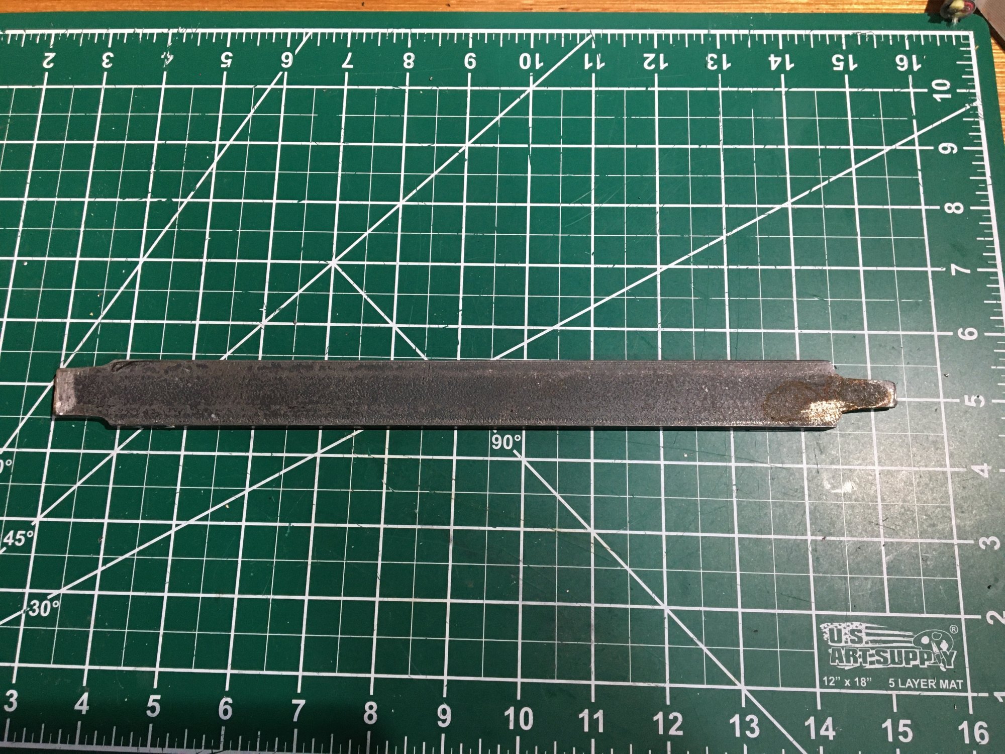

You didn't ask, however, there is a simple tool you can make that is inexpensive and makes this job easier. Take a piece of iron bar stock (available at any big box hardware store) and grind the end of it to fit into the through hull. There are 2 ears inside the through hull for this purpose. Each bar can support 2 different size through hulls. In the photo below, one end fits a ¾" through hull, the other a ½" through hull. I used a bench grinder to shape them and a file to clean them up.
Thanks! I didn't ask because I already bought the Buck Algonquin step wrench. I figured I'll be replacing a lot of through hulls in my lifetime.
