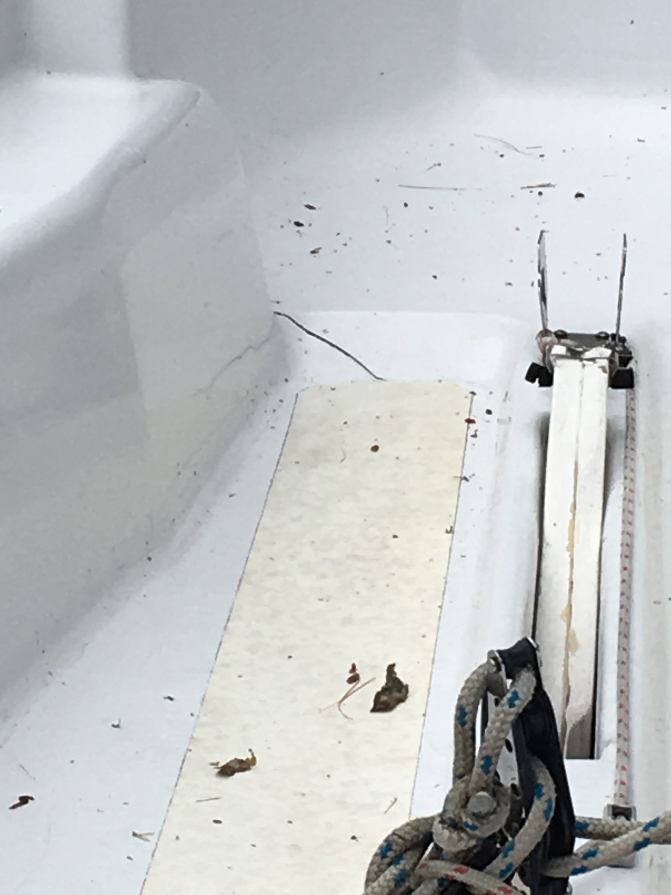

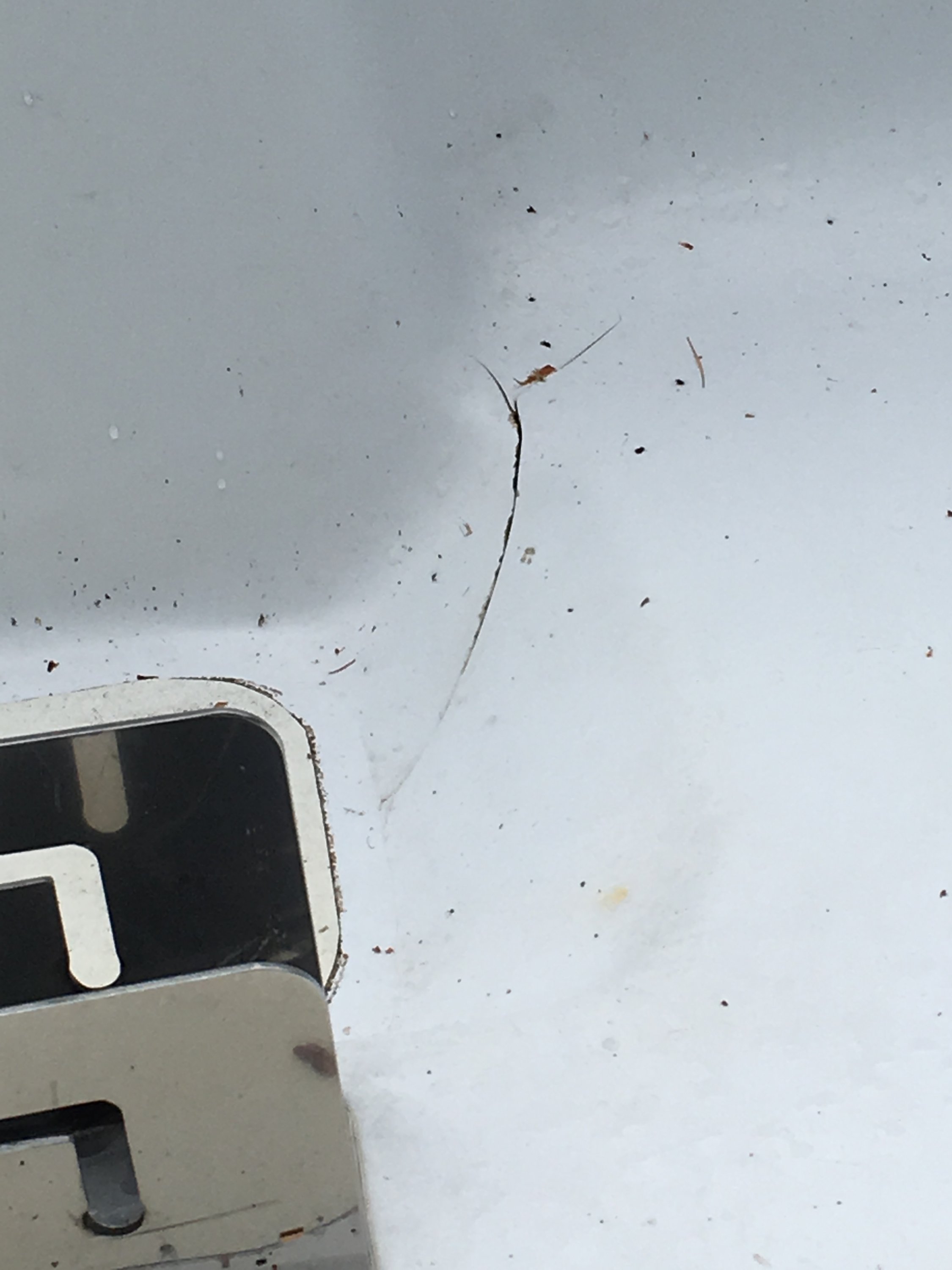

Isn't that a liner that's cracked. Since there is a hatch board there, I would think that the hull is beneath and not shown cracked. So it's free and hopefully complete what's the down side? Someday you may have to take a 17' boat to the dump? Not so bad.
I sail a lot of Wed PM races in a boat with a lot of cracks in the liner, which happened in races in rough weather when the liner and the hull couldn't bend in unison. I don't worry about those. And sometimes I sail on this boat when the water is very cold.

As Crazy Dave suggested, you will want to repair that to keep it from getting bigger. It looks, to me, very repairable; hours not days. Others here will have more experience and better advice about that, but I'd jump on the chance for a boat like that.

Thats not a hatch. Its grip tape.
That crack is above where the hull rest on the front trailer bunk. Winch might be too tght pulling bow down onto bunk pad. Bow eye is in wron gplace so this happens.

That is a great video. There is just one thing that will be different when fixing the cracks in the little hunter. The H-170 has a skin that is made out of Luran, not fiberglass, so you will want to use epoxy, not polyester resin. Since you will be working with epoxy, you need to be careful to get a mat that is compatible with epoxy. Some of the older versions of mat only worked correctly with polyester.
Also, like Bobby said, stop crack drilling gets you by for a while & buys you some time. It is a common industrial technique that is frequently used in aircraft repair.

Guys I will handle as to correct way of repair. Good call on drilling at each end of crack but do not sail yet till we see the cracks

In non destructive testing(NDT) of pipe welds we would find surface cracks with ultrasound. We were allowed to grind the crack out as long as the weld depth met specs. If you see hairline cracks it is probably a good idea to grind it out with a dremel until you cant see it anymore. Ideally, look for some uv dye penatrant to verify its gone. If it goes all the way down then drill end holes to stop them from spreading, then, use plastic welding or epoxy to fix. Luran (asa) is the same material used for 3d printing.

If I were you, I would take the boat but with anticipation of having to do some work. I have learned over the years that there is no such thing as a "free" boat! I restored a Hunter 212 made using this same plastic/structural foam construction. The plastic is just a skin to protect the structural foam....think of a foam snark sailboat on steroids. The cracks are fairly easy to fix using Devcom plastic weld you can buy at your local Ace Hardware store. I wrote down the procedure I used on the Sailboatowners.com owner mods forum (a great source of information as you work on your new boat) https://hunter.sailboatowners.com/mods.php?task=article&mid=9&aid=100105&mn=212 . Only change is to not use bondo or epoxy to fill and level as neither sticks to the plastic skin or plastic weld. Just use the plastic weld and then sand it down once it is hard. Make sure you terminate the cracks by drilling small holes at either end. Also, try an eliminate any air spaces that have developed between the foam and the plastic. This is the same plastic used in car bumpers so it is strong but is vulnerable to cracking if there is a big temperature differential between the two sides....like when there is trapped air that heats up on the back side. There are two articles on ACP plastic repair and cleaning here: https://hunter.sailboatowners.com/dl/downloads.php?task=model&mid=9&model=212

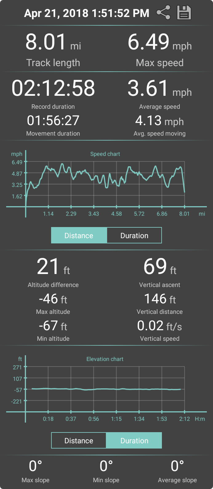

The main power in this boat comes from the jib, if you furl it you will dramatically reduce the speed of this boat.
Check out this speed chart. We always start with a reef and no jib. Note at about 1/2 mile we got bored, lost speed as we set up the jib the got a good groove going once trimmed out with jib. This was saturday at noon with 10knot gusting to 15.
