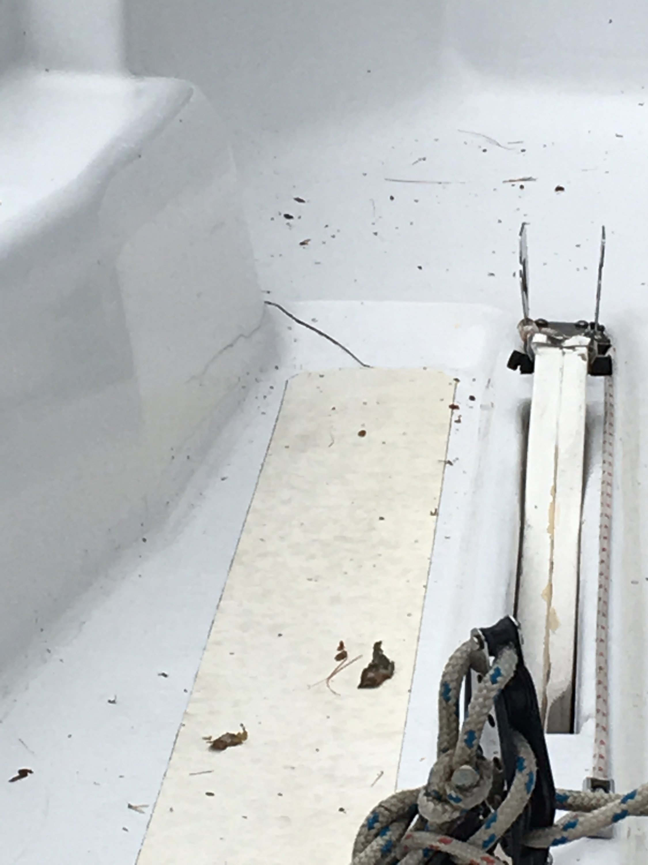

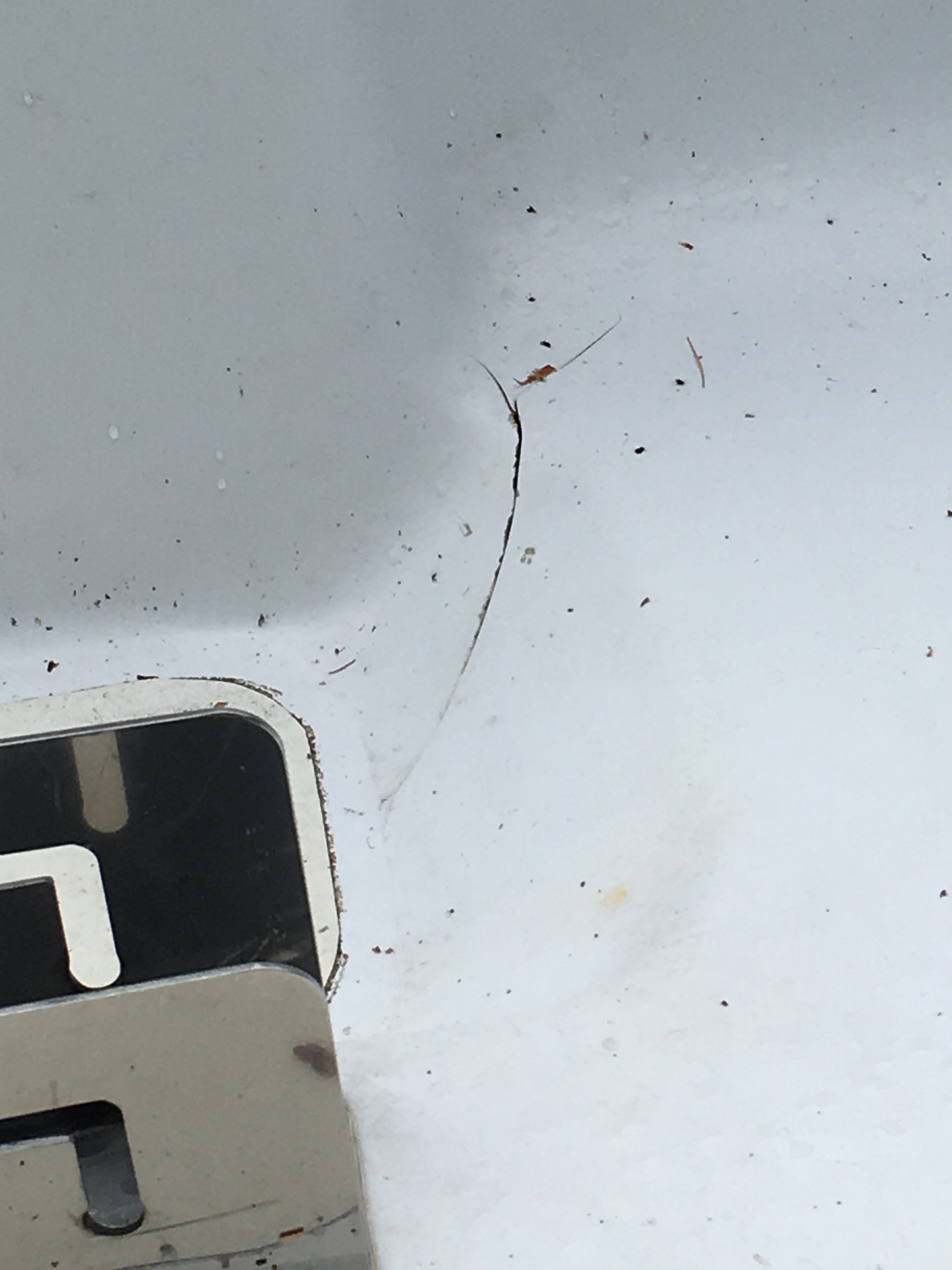

Take photos of cracks and post. Then I will respond
Thanks CD. I'll do my best to get photos and any other info about the cracks from current owner. He did tell me there are 2 cracks and are not leaking, but I'm sure that can mean a lot of different things until you see it....

Contrary to what is said the cracks do need to be addressed to prevent further cracking which is why the request for photos
Right on. I emailed the owner for photos and I'll post ASAP, but the boat is up north at his cottage so it might day a few days before he goes up (we actually had snow on the ground last week) !
