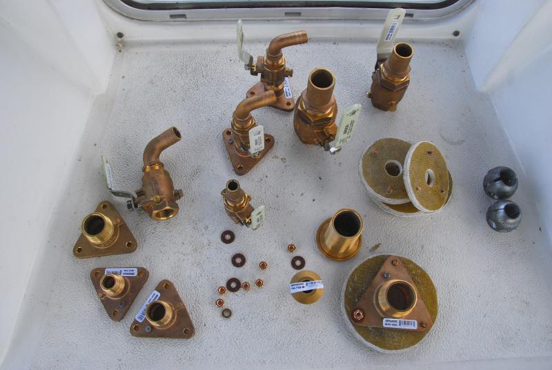

Should I replace seacocks?
Sep 24, 2010
34
Beneteau 321 Edgewater, MD
I just pulled all of the seacocks and thru-hulls from my boat (Beneteau 321). I have no doubt that they were the factory installed seacocks from 1995. One was stuck in the closed position even though the handle worked smoothly, one thru hull snapped off when I tried to thread the seacock off of it. All of the other had corroded elbows that broke when the hose was removed (total of 6).
I am so glad that I decided to look into them even though the surveyor said they were acceptable in his report. I will be replacing them properly with backing plates, and flanged seacocks.
My point is that if you have any doubt, replace them.

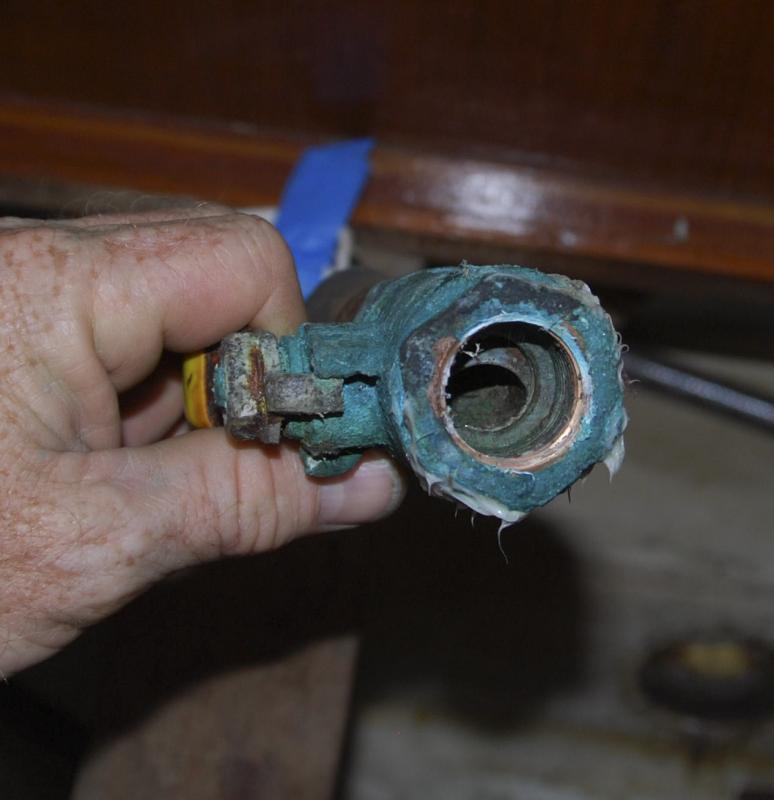

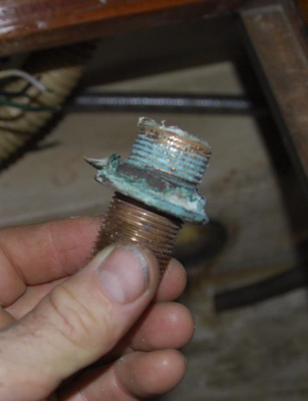

If your thru-hulls and valves are from the factory
I doubt seriously that they are true sea-cocks. I'll bet they're valves screwed directly onto mushroom fittings.
BigEasy is spot on. You very likely have some very mis-matched threads, kinda like the first two pictures I've included here. Care to guess how many turns that valve took to fall off? I damn near crapped my pants.
Love the Groco flanged adapter design.
Rick,
Those are some SCARY pics... Would you mind sending me those images and allow me to use them in my seacock article when I reference mismatched threads? I will give you full credit for the photos.

No sweat, in fact, at that time I was inspired by your most excellent website. You sharing your knowledge was REALLY helpful. I'll get 'em to you this weekend (I'm not home right now.)
Scary is right . . .

Yup. They were.
Wow. Not only do you have only two, or three threads holding, they look galled.
It's those mismatched threads.
I'm always amazed (after this experience) that boat owners will be diligent about double clamping hoses onto a fitting such as this.
Makes me think of arranging deck chairs on the Titanic.

That's the problem.
I will ensure that each seacock is sufficiently threaded onto its thru hull.
I'm guessing that what you are calling a seacock is actually just the valve. An actual seacock is an entire assembly that will include a large flange which can be securely attached to the inside of the hull (Maine, help me out here.)
If so, the valve threads (tapered) are mismatch with the thru-hull threads (straight) so that they cannot thread together properly.
