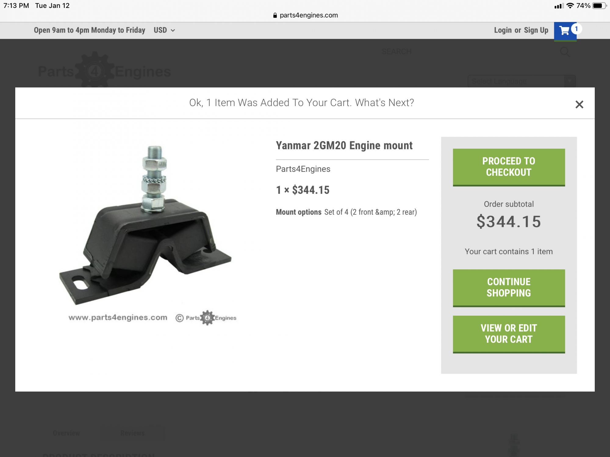

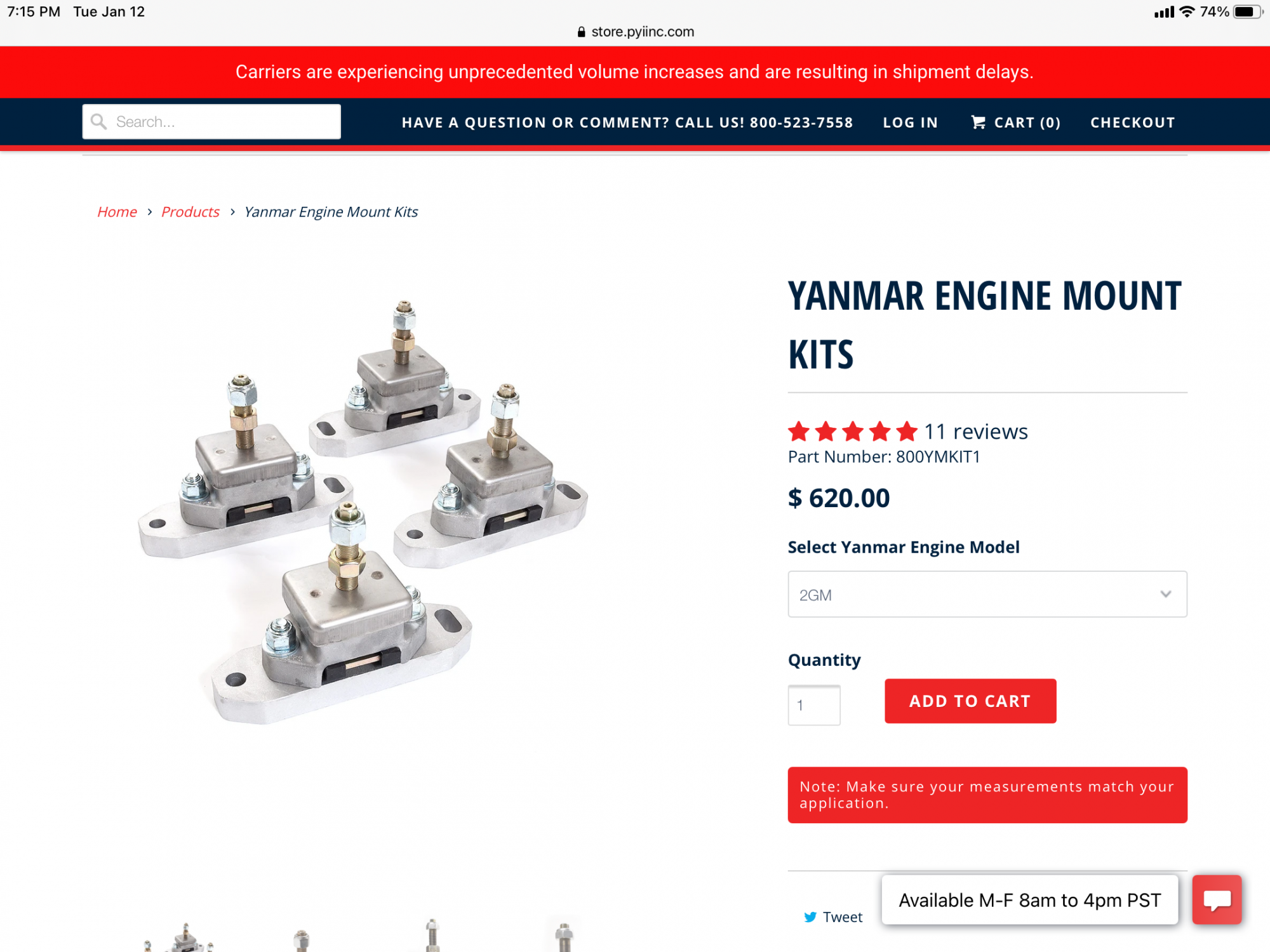

I found these for $396 US:
If I read correctly, the 'kit' listed above costs $620 US.
That's a 56% higher price than the EU made replacement mounts.
OUCH!

it seems like the Yanmars for a 2GM20 are $344
the PYI’s are $620.... right?
BA18397D-AF53-4BC9-B685-5CC1873A631D.png 7FC6A282-671B-46D3-B4B0-09D7394C8F59.png
on edit...I see the “Yanmars” are the UK ones of unknown origination... sorry.

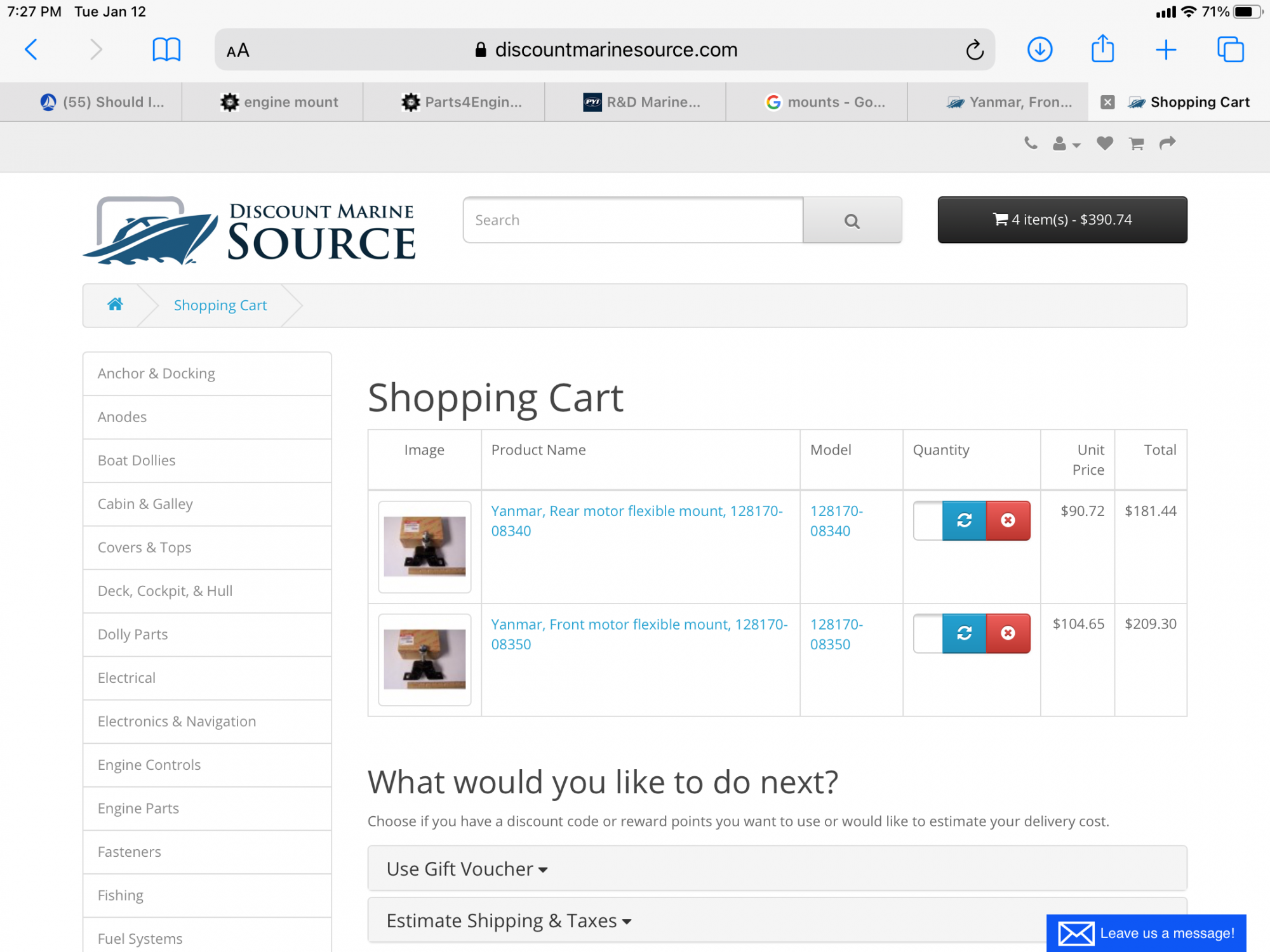

Tally Ho, I came across the ones on discountmarinesource.com today as well..and only ~ $8 shipping to Seattle. Much cheaper than Yanmar retail, which is $165 each, excluding shipping, according to my local Yanmar parts dealer. The part numbers are a little different than what I see in the 2010 Yanmar parts catalogue (the latest one I have), so I’m checking this out before I order from them.
Ken13559: I’m replacing my engine mounts because the entire engine has been pulled for a major rebuild and mine are 25 yrs old and very rusty. I’ve also experienced increasing engine vibration over the past couple yrs, though that could be partly the result of the engine problems that led to the rebuild, not necessarily the mounts.
