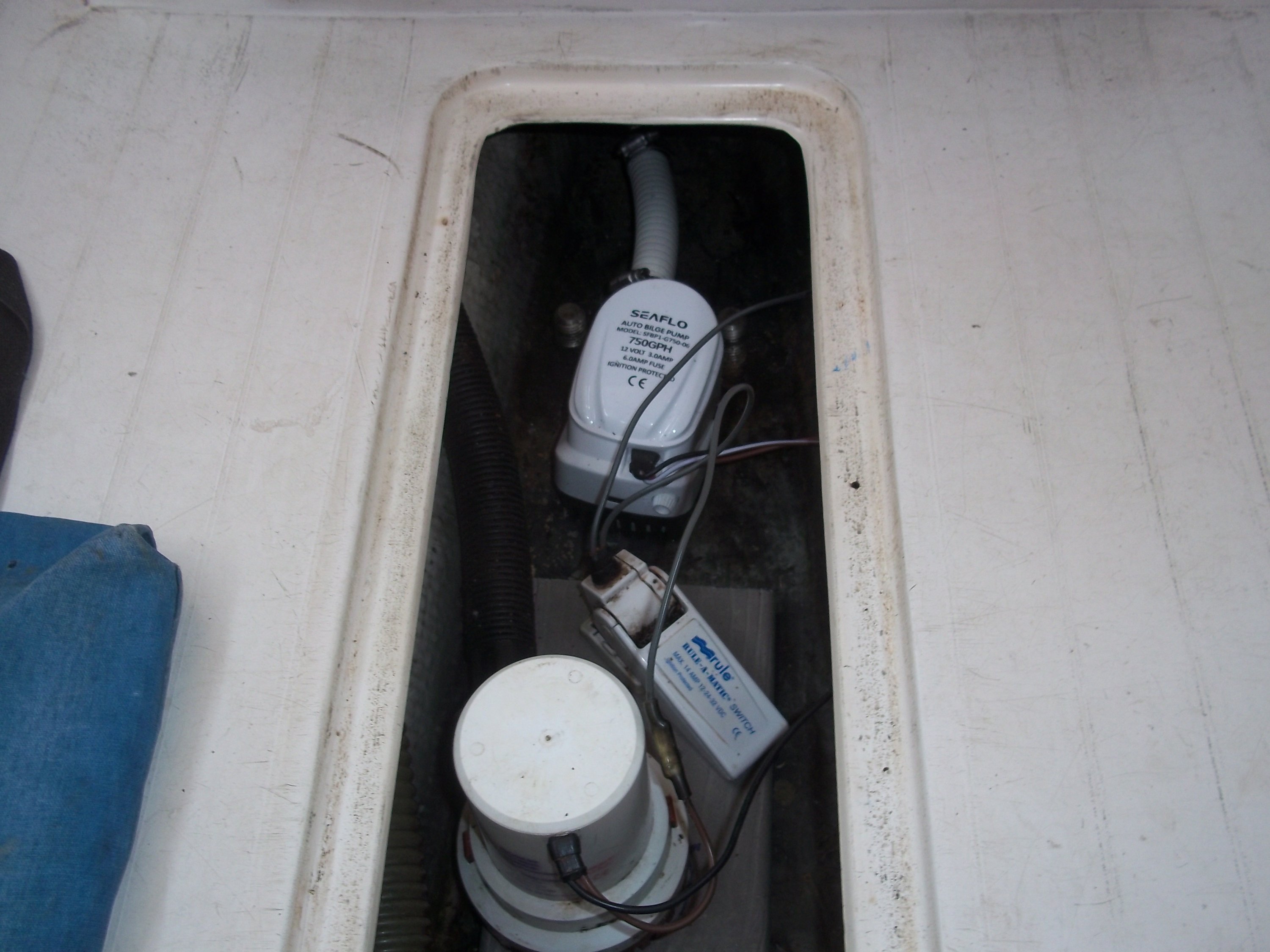

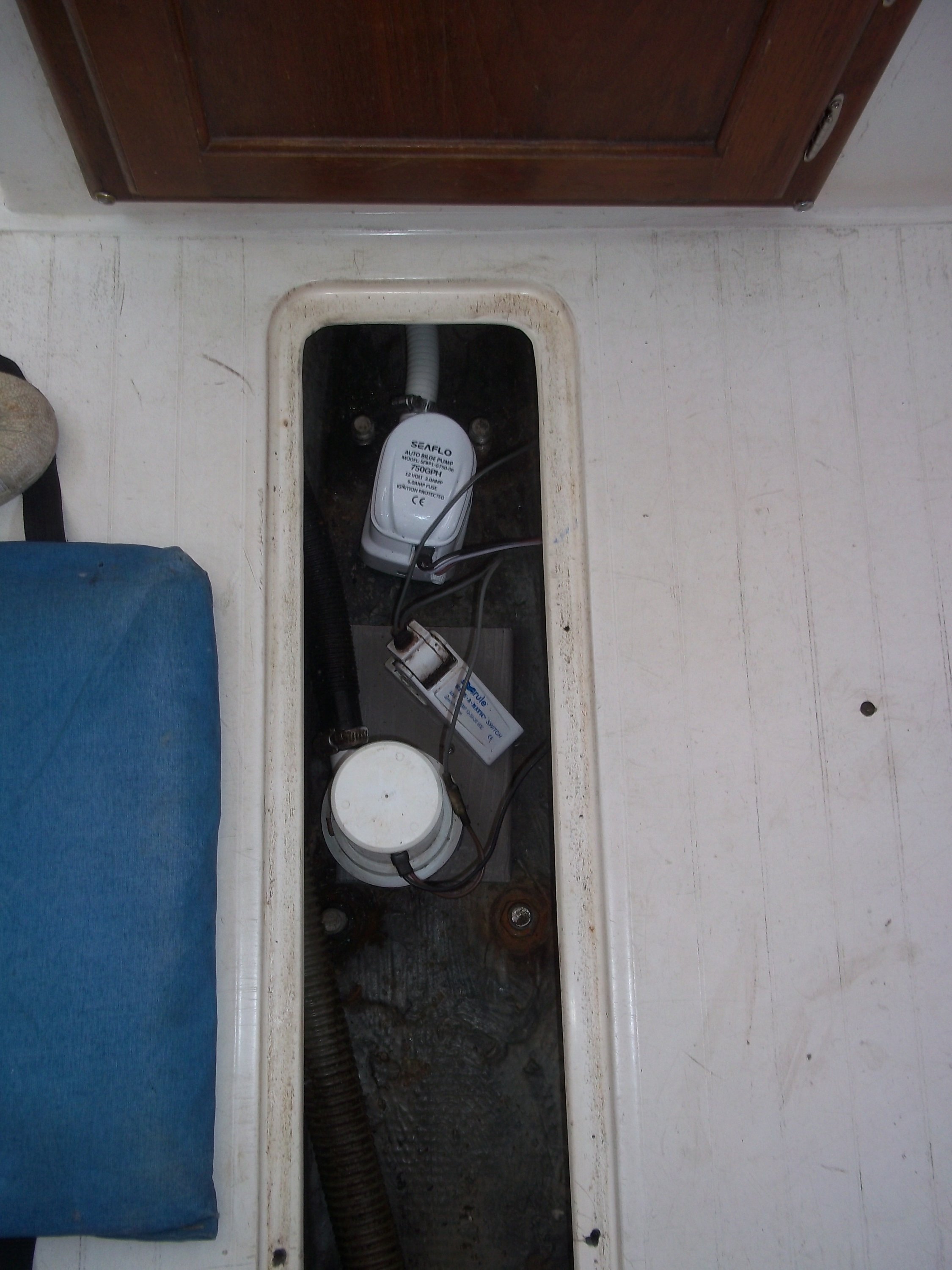

Here's what I recently did. Not
recommending, just what I did.
750 gpm with small discharge hose on
floor of bilge. 1500 gpm with
larger discharge hose elevated 1 inch (because
that is all the depth there is).
(Since I took this picture, I secured
all wires up and out of the way)

Following on from the "Tupperware Box" install....At the end of the Whale Pump hose I installed one way valve, a "T" piece with one branch of the "T" covered, so with the vertical section attached to the hose, and the blocked part of the "T" uppermost, the remaining part is in contact with the sole of the bilge and removes virtually all the water that the electric bilge pump does not.
