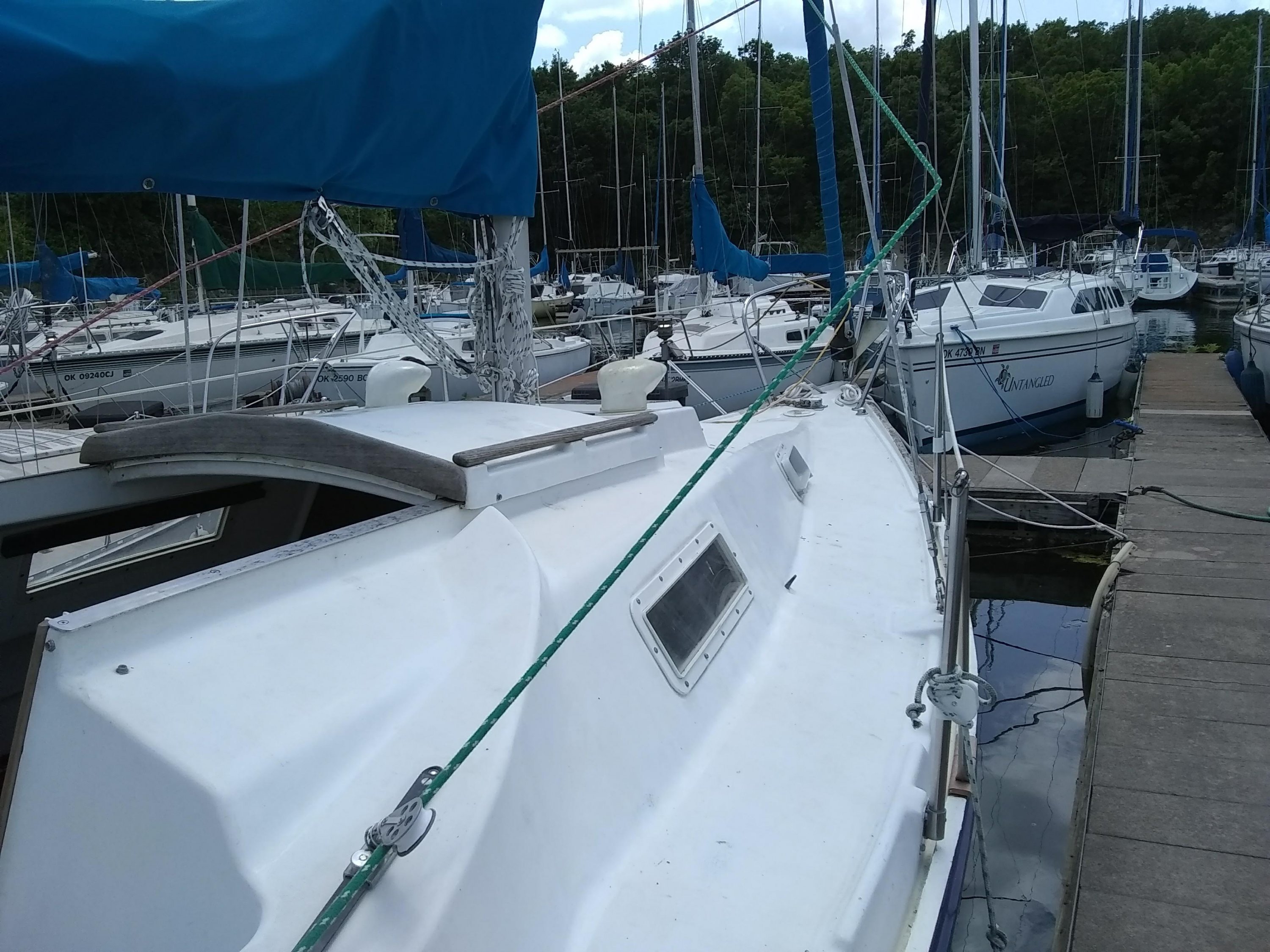

View attachment 150663 I can't sheet the genny in very tight with the sheets going outside the shrouds and the placement of the jib fairlead results in a lot of chafe with the sheet dragging on the shroud. I'm thinking if I bring the sheets inside and don't unroll the genoa all the way so the leech doesn't quite touch the shroud I might be able to point better.
For downwind maybe I could use a snap shackle to attach a sheet running outside the shrouds.

It looks to me as though you do not have the sail to match your track/block arrangement. Perhaps there is a place on the rail where you can attach a snatch block to get a better fairlead to that block.
If you really want to do this, then I suggest you get together with a local sailmaker and have him design and build a sail for sheeting inside the shrouds. A partially rolled genoa will not give you a very good sail shape or the performance you are seeking.

This may sound bad (stupid) but I would consider running two sets of sheets. One inside for close hauled and one outside when reaching or running down wind. Can't say I have ever seen that done. You may also consider installing a new track along the toe rail. Some of us run PVC pipe up the shrouds to facilitate tacking, however , you may want to think about that to protect your jib sheets in the current condition. Not sure what I would do.

First design of boats differ from model to model and manufacturer to manufacture. Can you take a full side photo and what boat do you have?

With outboard shrouds, you definitely need to go inside and use a genoa small than 115% or so.
That being said, looking on your boat on sailboatdata shows the boat with large genoa as an option.
Very odd.

I know a guy with the same issue. He always complained that he could not get a good sail shape close hauled. I can see from the picture that the sheets attach the same to your sail as his. The issue is the jib is cut for reaching and running versus one that is cut for close hauling. You can either live with it like he did or get a new sail

I would consider adding a jib track or at least block outboard near the coaming for that jib, though this would not be inexpensive. If you use that jib all the time, amybe even move the existing tracks.
I worked at the Seafarer factory in about 1971 and depending on your year may possible have installed the ports or other hardware. Unfortunately due to the way Seafarer attached the deck to the hull (essentially gluing it on with thickened epoxy) there is no metal toerail that makes it easy to attach a block.

That's a very odd picture. The ability to adjust the sheeting car allows you to shape the sail for the angle and wind conditions. If the sheet is intersecting anything in that process, the car placement amounts to a null input.

If you REALLY want to get a couple of degrees more pointing out of the boat, put a jib car track on the deck inside the shroud and re-cut the genoa (or get a new one) with a very small overlap - say around 105%. Something like a J88 http://portsanilacmarina.com/product/jboats-j88/#iLightbox[product-gallery]/0
You will loose sail area so less drive in light winds and you don't have the foils underwater to support the closer angles so you will end up with more lee way but boy, it will feel like you are pointing better.
Unfortunately, close pointing angles come down to more than just sheeting angles. In some cases you can gain a bit by re-leading sheets. New sails also helps. If you do want to try your existing sail lead to your existing track with the sail partially furled to fit under the spreader, pay attention to the lead angle. You may want to put a tweaker on to pull the clew down or in and get proper sheeting angles.

No. It will not point better with the genoa partially rolled up. It will not do anything better with the genoa partially rolled up. Get a nice crisp new headsail that does not come all the way back to the shrouds and put a track in the deck.

Lots of good replies. I do have some older plastic shroud covers on the lower shrouds and port side upper shroud which I plan to replace soon.
I appreciate the remarks about nice lines! She is purty, ain't she?
Isaksp00, she was built in '76 so a few years after your tenure at Seafarer.
From my Navionics tracks I find that my course made good upwind in light air with the genoa completely unrolled and sheeted in to just about touch the spreader amounts to about 60* off the true wind angle, I think about 10* of that is leeway.
New sail or extensive modifications are not in the budget this year.
I think I'll give my idea a trial and see what transpires. Judging by the consensus probably won't help, may hurt. I'll let you know what I find.

Install a reaching lead block on the rail for running the genoa sheets outside the shrouds. Use the inside lead block for running the sheets inside the shrouds when sailing close reach or close hauled. You can use one set of sheets for this... simply re run the lazy sheet for the next tack. However, for convenience.. such as bearing off on the same tack... it helps to have two pairs of sheets that you can tie on when needed. Do not use a single sheet, doubled and cow hitched to the clew... use separate sheets attached with a bowline knot for easier changes.
Shackle the genoa (reaching) lead to a stanchion base or a padeye.... if you have the bucks install a track on the rail with a sliding car..
In any event, you should never have the sheets rubbing the rigging as pictured... sailing or otherwise... so when you roll up the jib remove the sheets from the lead blocks and tie them off to the mast or anywhere they won't rub.
