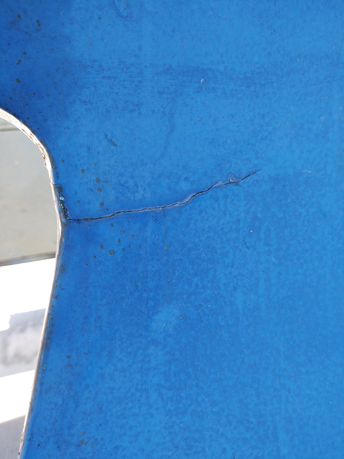

Looking to purchase this 1994, Hunter Passage 42. Had boat pulled and cleaned for survey yesterday. Found this smile, aft end of Keel. Not very long. Surveyor said not to worry, everything is tight but to retorque bolts. Previous owner removed nuts recently to replace rusted keel washers in bilge. Like to know what any of you experienced Hunters think. And if anyone knows torque specs? Thank you in advance.

Suggest getting repair quotes from the haulout boatyard and other qualified contractors while it is out of the water. Then request a repair allowance from the Seller, if you are still interested in the boat. The forum can provide keel torque specs, which are published on the internet, but the boatyard should know. Please keep the forum updated.

hmm, an aft crack... when the aft bolts can no longer keep keel in proper position due to corrosion, that can happen. what's the length of those aft keel bolts ? could there be water intrusion into the keel at the crack, which is affecting integrity of the aft keel bolts ? development of the crack aft could be because the aft bolts have lost their ability to hold the keel to the hull in proper position. if so ---get a quote to repair and/or replace ALL those aft keel boat, s and subtract cost of this worst- case analysis from the offer. (and note most surveyors have a 'hold ahrmless ' clause --meaning, if i'm wrong you can't sue me..)

It looks like a crack in the fairing at the keel/keel stub junction. These are pretty common. I think because the boat bends and the keel doesn't. There should be some flexible sealant under the fairing that has kept its seal. If you owned the boat, you could grind away fairing and maybe discover if the sealant is in tact. Or lift the boat off the keel and re do the whole thing. But as a buyer it's different. First you could ask the surveyor what his recommendation for repair/re seal is. Or get the seller to have the yard grind down and re seal it as a contingent of sale. The problem with holding money back is that you would have to ask for the whole re do, in case that is what's necessary. You won't have the support of the surveyor's report and the seller would probably move on to another buyer.

Wow, thanks for the links! The Surveyor even used the term "Smile". I will search forums next time before wasting folks time. Answers were already there. Looks like I'm about to become the proud owner of a Hunter smile.

Would also like to add. While boat was in the straps, dried quickly being warm windy San Fracisco day. Used my hands to wipe away and dry area. To see if any water would seep from the Smile. None did, I feel if there were depth to the crack/smile. Depth would of revealed intself with latent weeping.

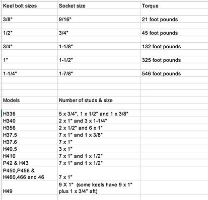

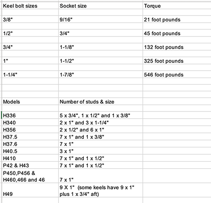

Big difference in the pdf torque table value above for a 1" bolt above from @sail sfbay and the Hunter provided numbers from @Phil Herring
From the pdf file table 1"- 165.2 ft/lbs torque
Frome th Hunter table 1" - 325 ft/lbs torque
The Hunter value is twice as much torque - seems like a big difference in specs
Anybody have an explanation for the difference?
I don't know which number to put my faith in for retorquing

Wow, :yikes:
Hunter knows the specific material they selected for there bolts. There are many types, grades Stainless, even different types of 316. Only they know what there bolts are made of and how much torque, to get the results there enginears designed for.

Hi Easy, similar situation here. It appears from your original pictures that the keel stub joint has been compromised, likely from some sort of a hit. Sea water is seeping in, thus the water coming out while on the hard. Understanding how Hunter constructed these boats, it is unlikely that crack resulted from normal operation.
The correct way to fix it is to lift the boat off the keel, clean and fair the joint, re-bed with 3M-5200. Also, have the yard doing the repair add washers to the keel studs in order to raise the keel nuts up into fresher threads just in case the hit damaged the original stud threads. That is how we had our keel stub joint repaired in 2004.
After the boat was placed back on the keel and studs torqued, the joint was sealed with two coats of barrier paint, followed by two coats of hard bottom paint, then two coats of ablative. The joint remains solid to this day after sailing thousands of miles all over PNW waters.
We used to keep our boat at the Everett Marina, but found Shelter Bay more accommodating and much closer to the islands.
