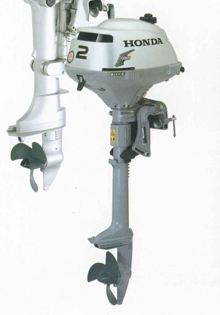

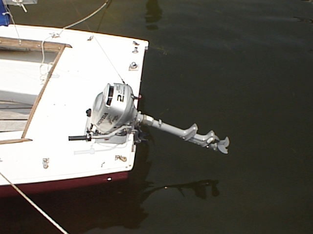

I've attached a picture of a HONDA 2hp on a Rhodes 19, this would be the long-shaft model. I also attached a scanned copy of the short-shaft model as shown in a brochure.
