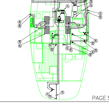

5. As shown in the diagram below, the Hunter 46 shore water supply enters at the transom through a water connection (12) regulator/check valve (13) then tees into the cold-water line to the transom shower (11), which is downstream of the water pump. Happy to show you the installation since I am close by.

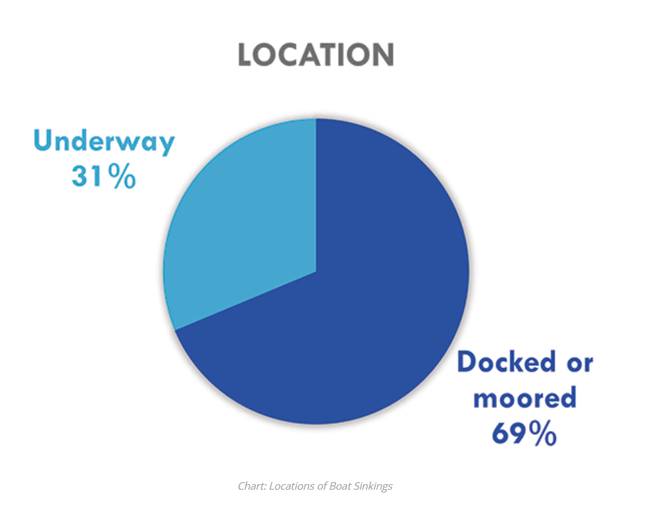

After looking at BoatUS, they had this to chart:
So there must be some truth to it. Quite impressed with BoatUS' published material. And from someone who knows first hand. Will definitely spend time going through their archives.
