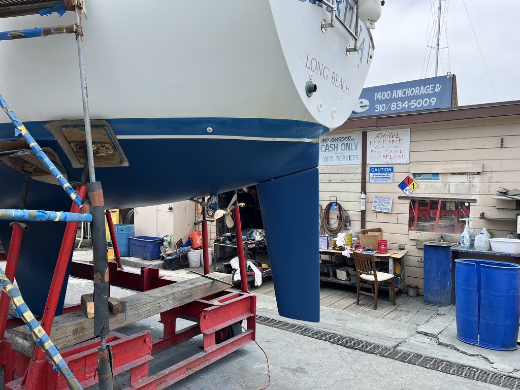

There is not much gap between the top of the washer that sits atop the rudder blade--you have one of this on you C30 also--and the underside of the hull.
How much of a gap would you say? Half an inch, or less?
I ask because I'm looking at a 1988 26-2 and there is a fair gap there, with some - fairly minimal - lateral play in the rudder. You can see the exposed rudder post between the hull and top of the rudder. It's about a half inch gap.

I'm referring to the gap between the top of the rudder and the bottom of the hull at the rudder post - not the gap inside the tube.
I'm looking at an Ericson 26-2.
