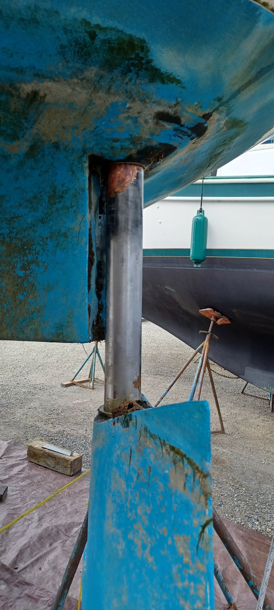

I have some lateral play in my rudder. Does the shim repair technique require a complete rudder removal?

If there are two (top and lower) bearings, I don’t think you can access the lower one any other way

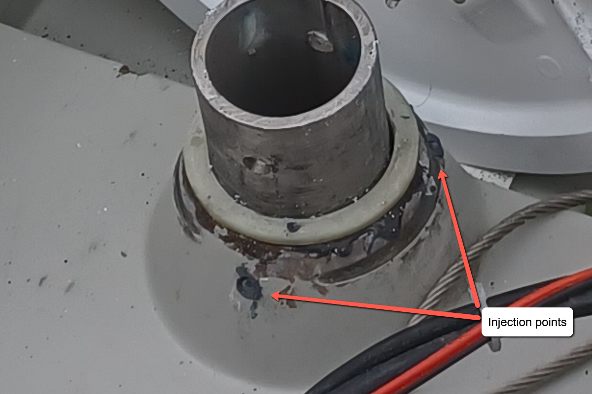

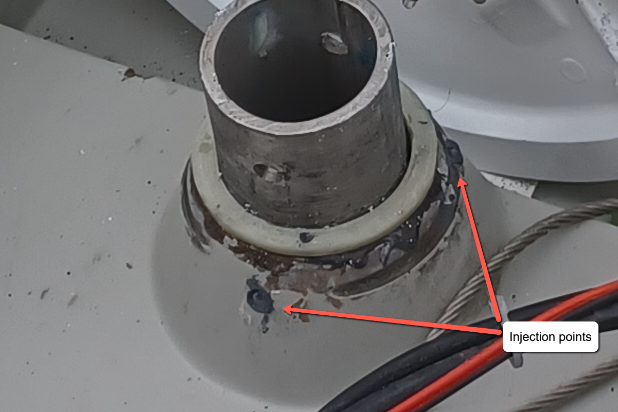

My 88 had brass shims when I got it 28-years ago but over the years, the rudder still developed lateral play due to the shim wearing.

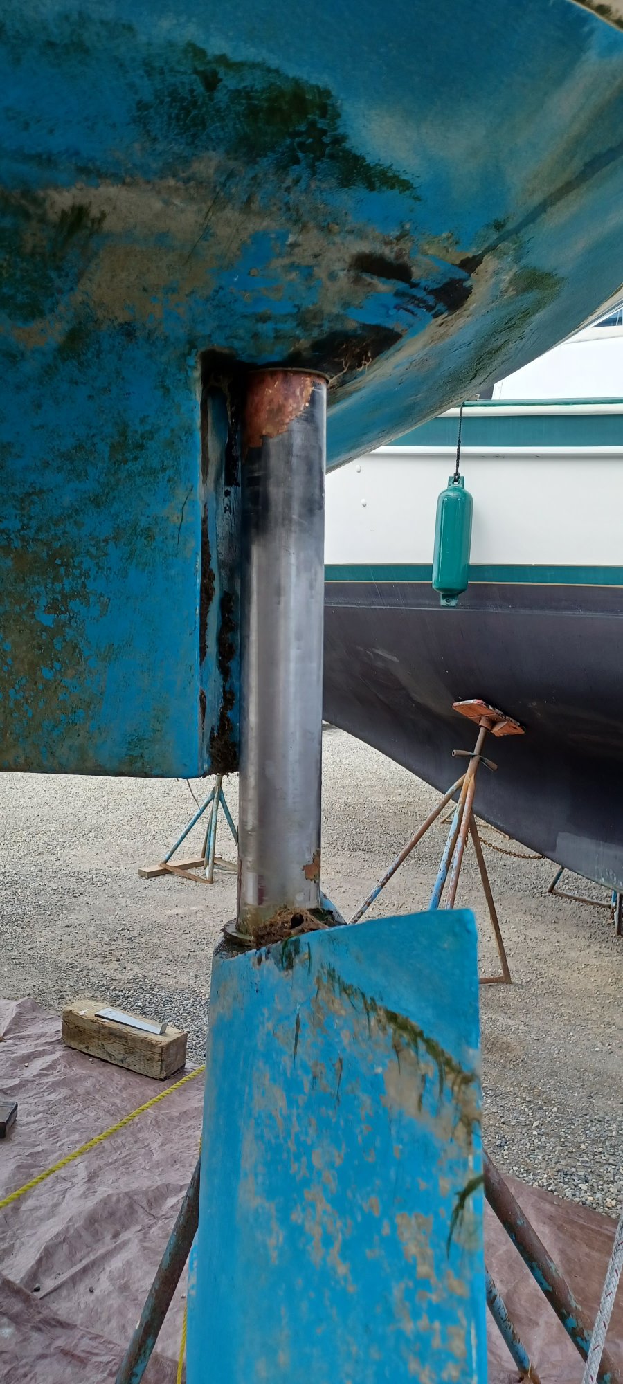

The C30 does not really have bearings as we typically think of them. The rudder is supported by the fiberglass rudder log which is glassed into the hull. There is no replaceable bearing, so the repair needs to be to reduce the gap between the fiberglass log and the stainless-steel shaft. In my case, I opted to use the graphite / epoxy repair which has resulted in a tight, slope free fit. This is the best photo that I have of the repair. I found that there was a void between the hull liner and the rudder log. I filled that gap with slightly thickened epoxy before drilling and injecting the epoxy graphite. I could not get the kit from CD because they were out of stock, so I made my own from a couple of packets of West System epoxy, colloidal silica and graphite powder for lubing the wheels of Pinewood Derby cars.

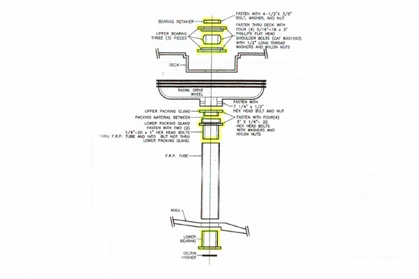

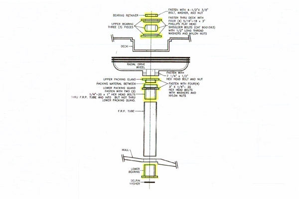

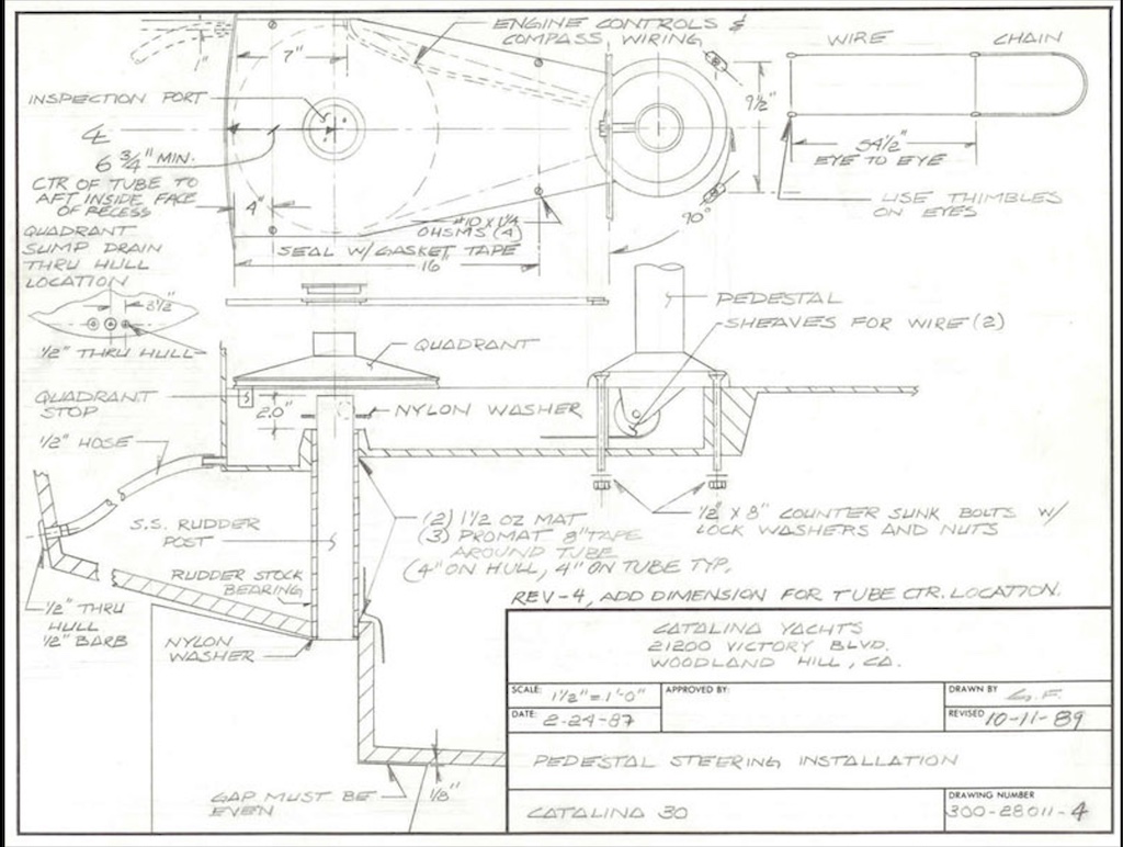

Very good. I'm attaching a drawing that my friend whipped up for this, just in case it isn't clear.

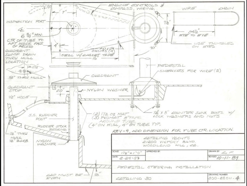

Here is the original drawing from Catalina Yachts from 1989. It matched my 93 MkII and my friends 95 MkIII.
@Alan Gomes
Yep, that is the one I followed. Neil sent it to me.
