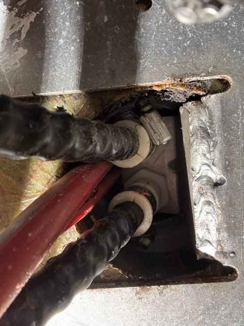

Tried as much as I could from the bottom (pulling from below, and after trying for a while, I decided to take a pic of what is blocking me.
All I can say is there is no way it can go from below.
Can someone please guide me step by step on how to go from the top, I need to remove the chain, or at least loosen it, and I have no idea how

On the steering quadrant there should be 2 eye bolts that are double nutted. The steering cables end there. The nuts are either 7/16" or ½". The cables are attached to these with cable clamps.

Quick question, might be a crazy one, but has anyone cut an opening and closed it off to access the cable clamp?
Would it be safe to do? Or would it structurally weaken the pedestal?
14,002
That would be an act of extreme desperation. I wouldn't go there.
There are extra long arm wrenches. Here's an example from Canadian Tire. They may give you the extra reach you need. Amazon also has them.
