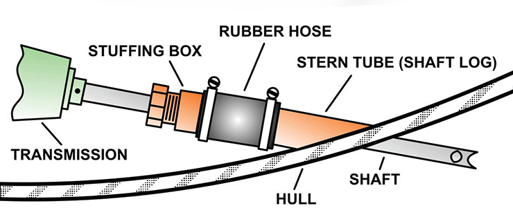

Shaft log hose is what I have known it as. This hose takes a lot of torq. pressure as shaft spins. Would suck it it failed…… though I have never heard of a catastrophic failure. Good luck

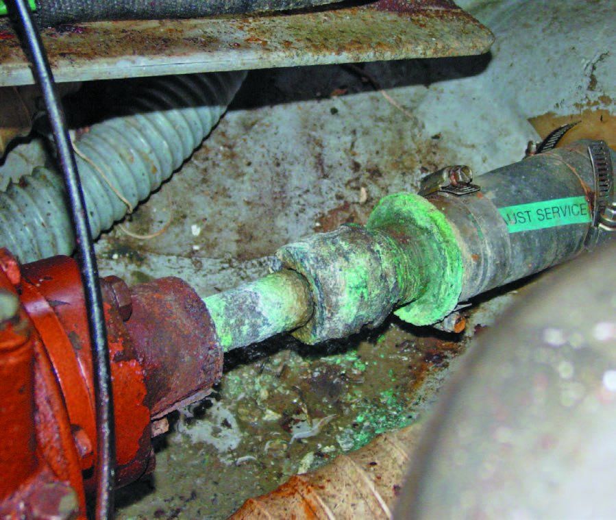

I think that the concern is that if things out of adjustment…like the stuffing box gets too tight, gets hot, shaft seizes in the stuffing box and the hose rips, comes off the stern tube, or who knows what…and then the boat starts taking on water.
Or due to lack of attention, the hose rots like these drain hoses did…I concede that this was my fault for not paying attention and inspecting this drain…but if would have been my stuffing box hose…

It’s a Shaft Log Hose. Buck Algonquin is the best source. Order it on-line. Do not let anyone tell you that ordinary exhaust hose is acceptable for this use. Shaft log hose is much thicker and has more reinforcement than exhaust hose. It’s actually so thick that it takes a couple days to tighten down the hose clamps.

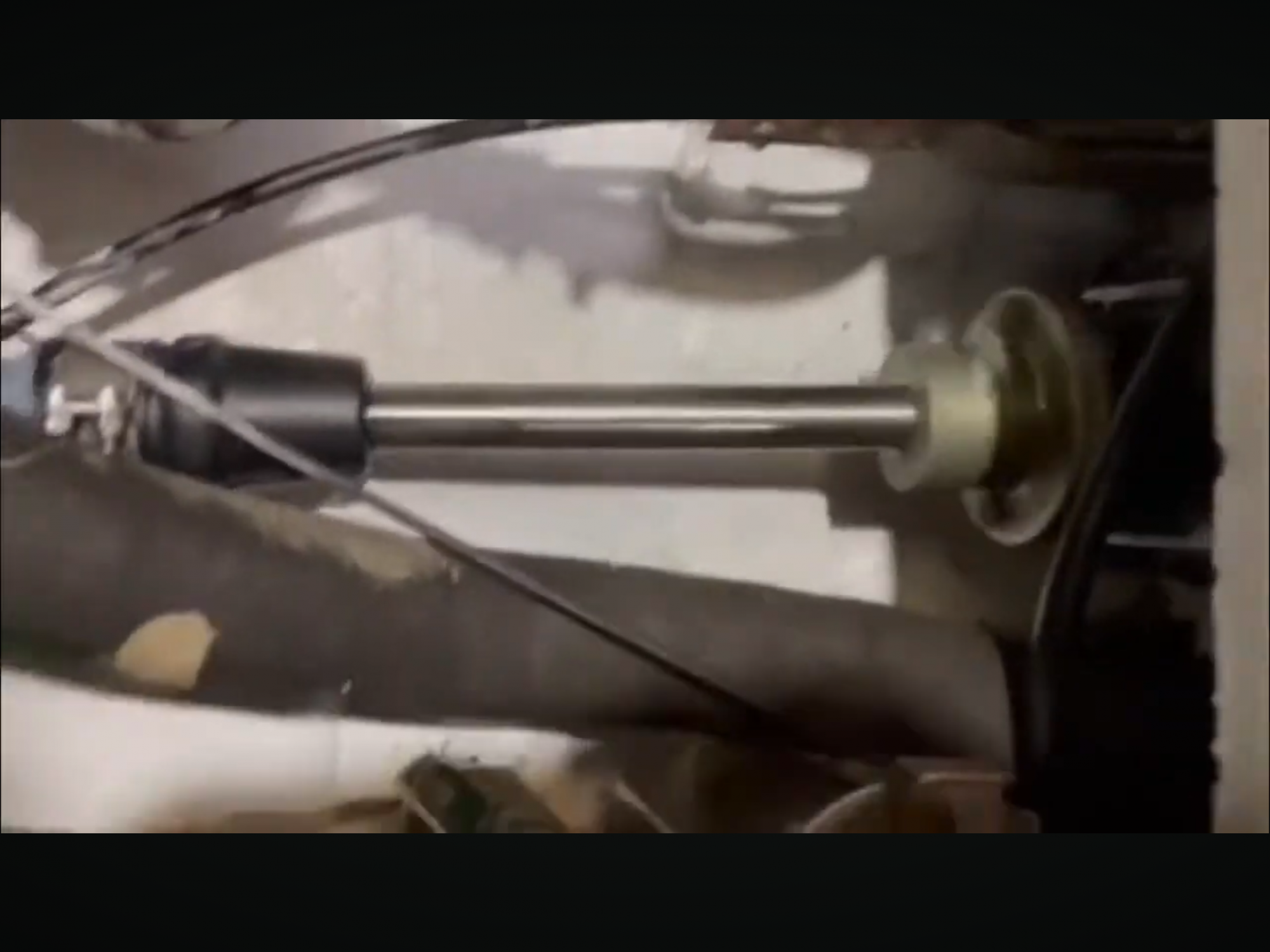

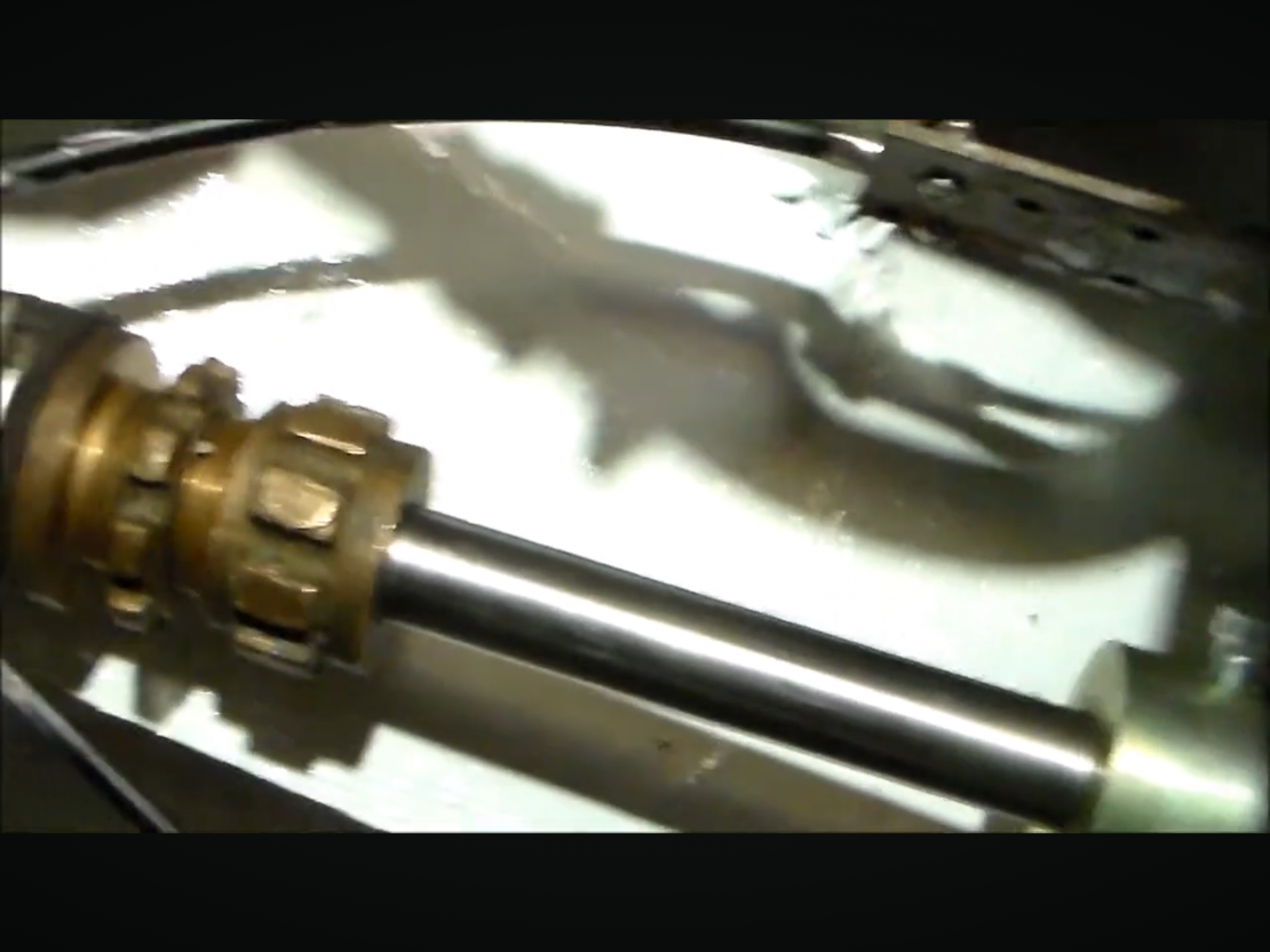

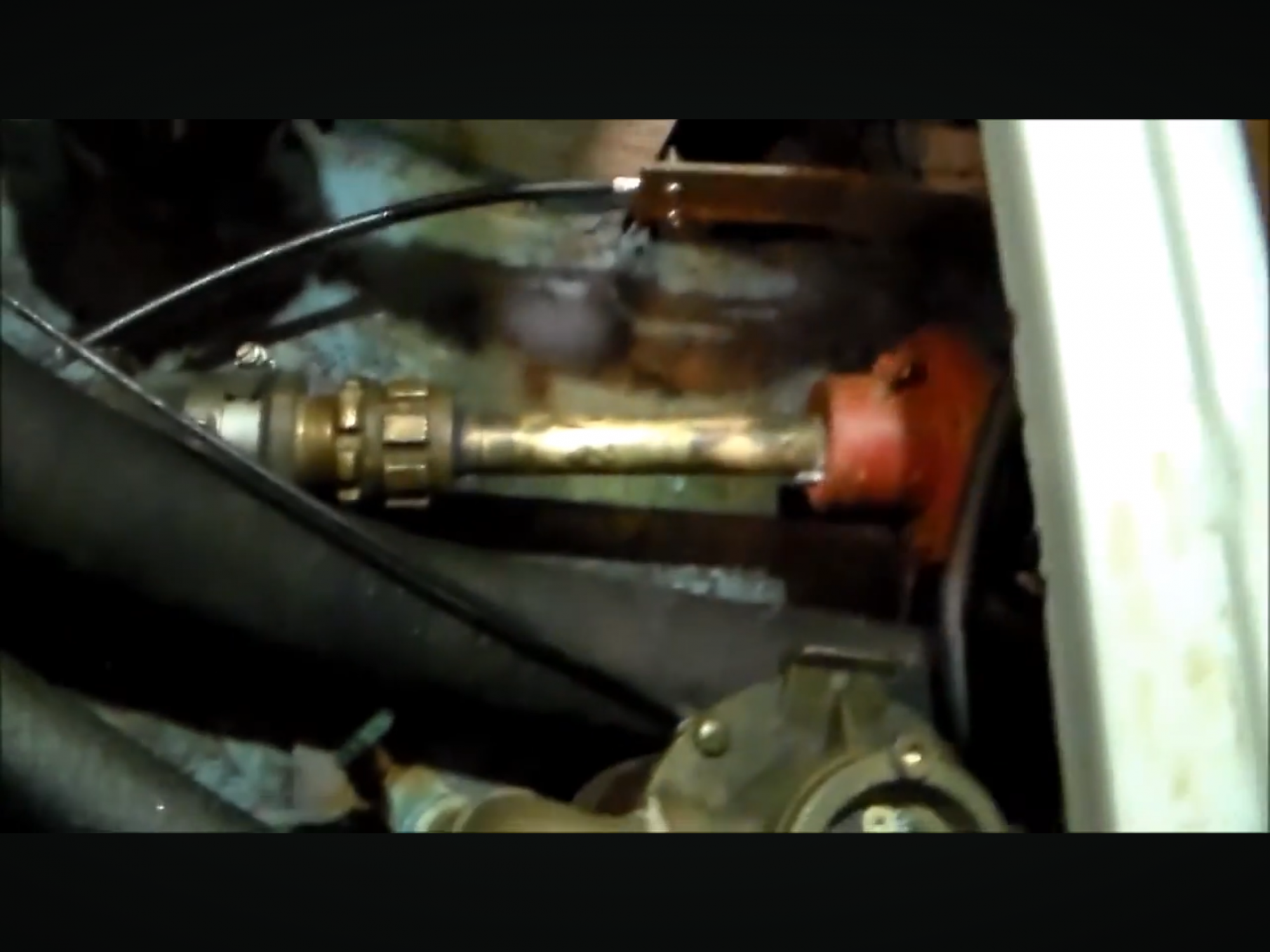

I think that the old hose on Tally Ho was 30 years old before I replaced the old stuffing box for a new Volvo a Penta shaft seal.
Before…
After new shaft and new stuffing box hose…
After new Volvo shaft seal…
Greg
