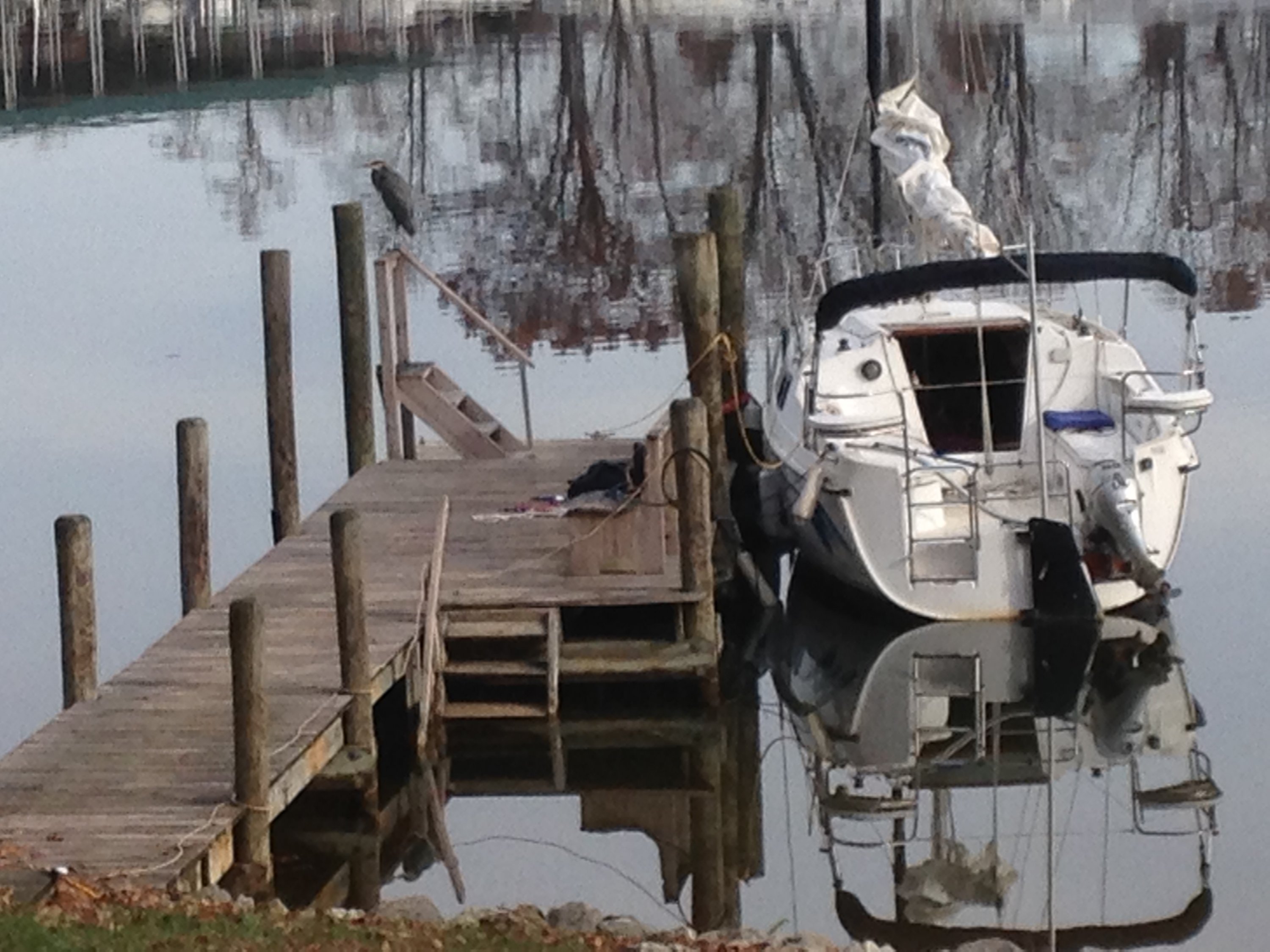

My motor mount is also rather low. And the previous owner put a standard shaft (15")on my boat (see pic below). When I'm on a starboard tack (port side low), the prop comes out of the water. Not a problem if I'm sailing since I'm not running the motor. However if I'm motoring into chop and the boat starts bucking, the prop comes out of the water. It is a bit of a problem and I have to take care to take the waves at sharp angles. When I replace this O.B. it will be with a long shaft (probably tohatsu) and because I usually sail with my wife and/or daughters, I will probably get an electric start. If you already have a working outboard... I'd get started with that one and not worry about replacing it until you know more about how you will use the boat. If you are buying a new motor... definitely get the longer shaft. Another thing to consider is the prop. A sailboat needs a high thrust prop in order to really get the most out of the O.B. If you go to "onlineoutboards.com" and search for "sail pro" you will get all of the outboards that are both longer shaft and geared and propped for higher thrust.
http://onlineoutboards.com/catalogsearch/result/?q=sail+pro
The Honda 9.9 sail pro electric start is the most expensive in the bunch at $3.4K. It is a very dependable outboard and similar to the one I currently have. Mine is pull start and usually starts on the third pull. In that same search you will also see a comparable Suzuki at $2.7K. Also in the "sail pro" search are some 15 HP motors that are less expensive than the 9.9's. You would never need 15 HP but one advantage would be that you could run your O.B. at lower RMPs and thus make less noise. Happy hunting.
