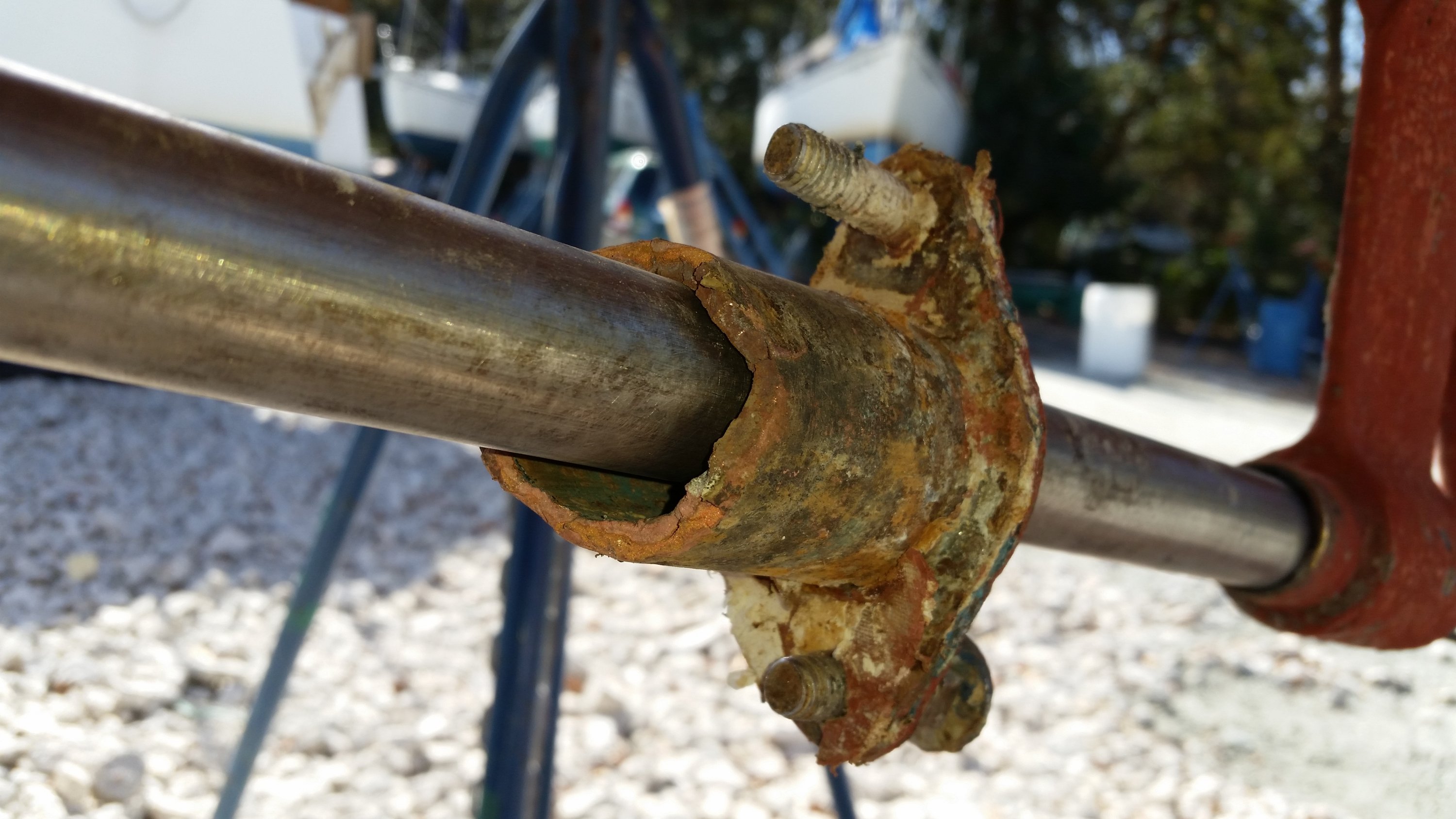

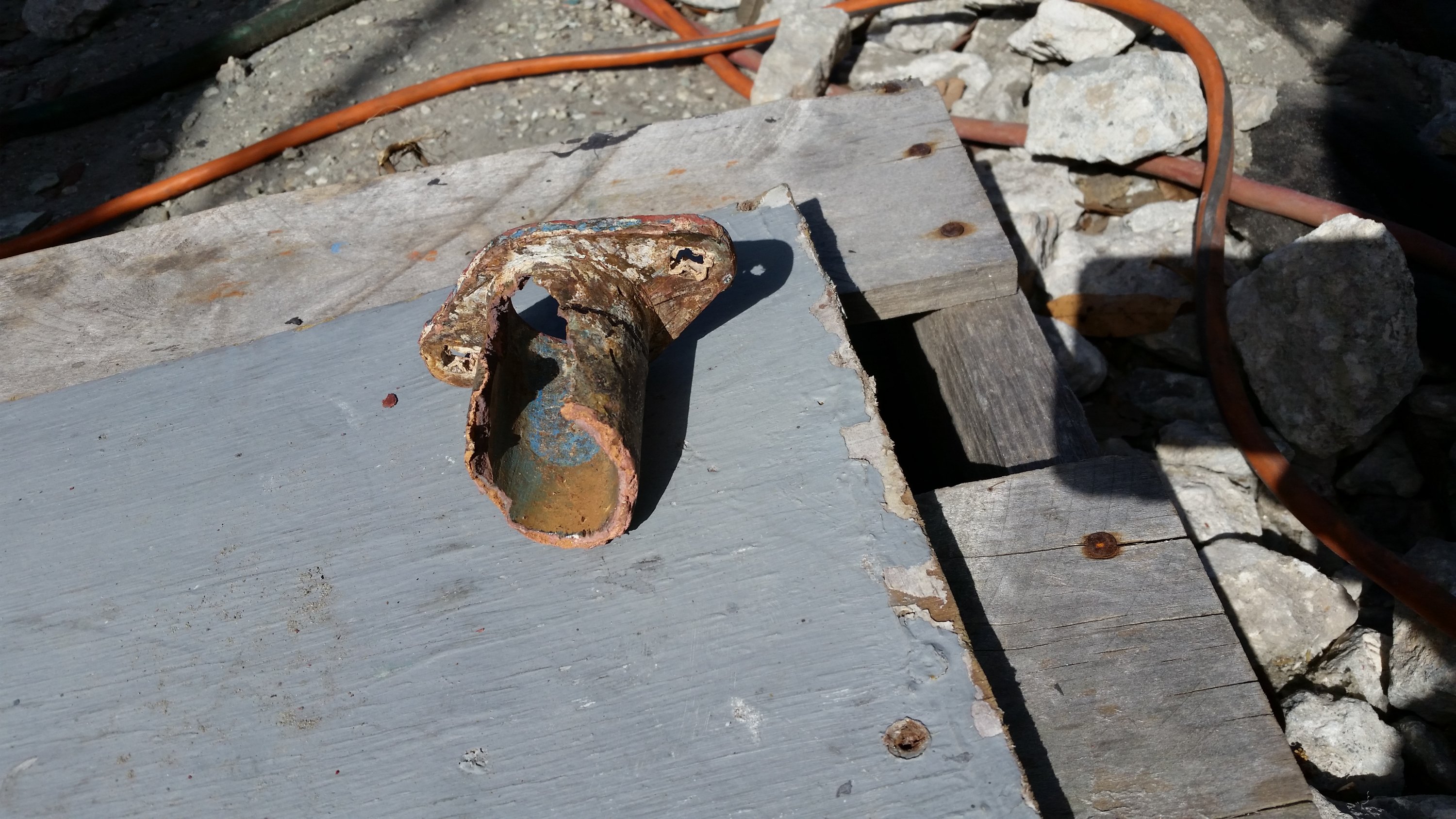

One advantage of the PSS shaft seal is that there is nothing touching the prop shaft except for the two o-rings and set screws on the stainless steel rotor and they remain stationary. Nothing to cause grooving in the prop shaft or to trap water that might cause crevice corrosion on the shaft. If your prop shaft already has some damage, I have had good success treating the area with JB Weld, then fine grit wet sanding the area. Since the shaft rotor doesn't move, there are no abrading forces on the repair area.
Kind of on the same subject is this pic of what could be a very serious problem with either type of gland. This is the bronze fitting, or whats left of it, on my H27. Discovered it while replacing the original gland with a PSS. Good idea to loosen and slide the rubber hose forward and inspect what's happening under it.
